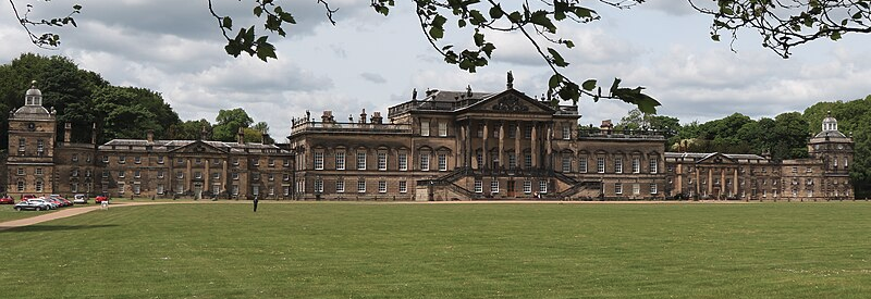

Mike Posted Monday at 14:20 Share Posted Monday at 14:20 20 hours ago, Crofter said: I question the whole 'only well insulated homes can use heat pumps' argument. My house is very, very far from well insulated, nor is it in any sense airtight. And it's working very well with a heat pump. Likewise, if you can heat Bowhill House and Wentworth Woodhouse with heat pumps, you can heat anything. Wentworth Woodhouse, Andrewrabbott, CC-BY-SA-4.0, more Link to comment Share on other sites More sharing options...
