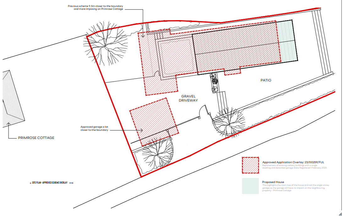

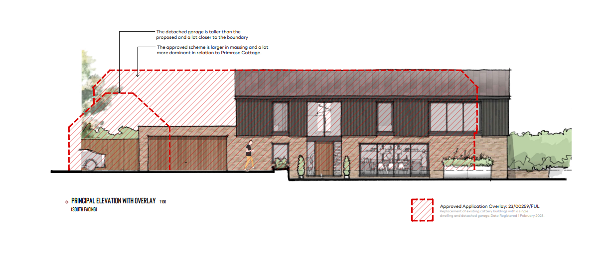

Can I get people's thoughts on whether the response below from our Architect is adequate.  I am not sure whether any of the objections that were raised, can be countered using reference to planning policy, or whether it is not like law where you can reference case law when arguing a raised point.
The objections are on page 1 of the post history.
Response to Mr ... Objection
  1. Architectural Design and Context
    The proposed design has been developed with reference to the Hampshire barn vernacular, which is appropriate for the rural setting and enhances the character of the site. Existing properties along White Lane lack a cohesive architectural style. For example, Woodstock has evolved over time, resulting in a fragmented design, while Primrose Cottage is a modest bungalow constructed with low-quality materials in a DIY manner. Our proposal introduces a high-quality, cohesive design that respects the rural environment without replicating the inconsistencies of its neighbours.
  1. Permitted Development Rights
    Concerns about potential future extensions over the garage under permitted development are noted. To address this, a planning condition could be imposed to remove permitted development rights, ensuring that any future changes would require planning oversight and maintain the character of the development.
  1. Drawings and Context
    The drawings provided are accurate, to scale, and represent the closest built forms for context. It is unclear why they have been described as disingenuous, as they adhere to all planning requirements including scale. Furthermore, as noted above, Woodstock lacks a distinct architectural style, making it challenging to use as a reference for the new design.
  1. Windows and Ridge Height
    The inclusion of a small number of first-floor windows has been carefully considered to avoid overlooking any neighbouring properties. The overall massing of the proposed dwelling is smaller than the previously approved scheme, and the building has been positioned further away from Primrose Cottage. Importantly, the ridge height remains unchanged from the approved application, as shown in the submitted drawings.
Response to Mrs .... Objection
  1. Design Features and Materials
    While the new design differs from the previously approved scheme, it addresses several of the concerns raised in the earlier application, including:
    • First-floor windows will be constructed using hardwood, ensuring a high-quality and sympathetic finish.
    • The ridge height remains unchanged, as the property will be set into the site using the existing lower ground level to reduce its visual impact.
    • A traditional timber gate, set 5 metres back from the road, has been included for security purposes. However, we are happy to omit this feature if it cannot be supported.
    • The building incorporates high-quality materials, including timber cladding at first-floor level and heritage multi-brick at the ground floor, to achieve a Hampshire barn aesthetic. While extending the timber across the entire façade is an option, we believe this would detract from the overall design and is inconsistent with other properties on the lane that also use a mix of materials.
    • Additional hedging is being planted to enhance the landscape and compensate for any loss of existing vegetation.
  1. Architectural Style and Landscape Integration
    The design adopts the Hampshire barn style, which is sympathetic to its rural surroundings. The use of heritage multi-brick and dark-stained oak cladding ensures that the building blends seamlessly into the landscape. Attempting to mimic the ad hoc design of Primrose Cottage or the overdeveloped nature of Woodstock would fail to meet the high design standards achieved by the current proposal.
  1. Future Extensions
    The client has no intention of extending the property in the future. Any such extensions would require planning permission, and a condition can be included to remove permitted development rights, ensuring that the building’s form and scale will remain as proposed.
  1. Proximity to Primrose Cottage and Visual Impact
    The proposed design is positioned further away from Primrose Cottage than the previously approved scheme:
    • The ridge height is located an additional 8 metres away from the property.
    • The garage is positioned an additional 4.5 metres away and features a flat roof, which is less imposing on the outlook from Primrose Cottage.
      These changes ensure that the visual impact on Primrose Cottage is reduced compared to the previously approved scheme. Even if future development over the garage were proposed, it would remain further away from Primrose Cottage than the earlier application.
Conclusion
The proposed design has been carefully developed to address concerns raised in the earlier application while providing a high-quality, purpose-built family home that integrates with its rural surroundings. Although the design differs from the previous scheme, it has been designed to address some of the earlier concerns whilst standing on its own merit and respecting the character of White Lane and the Area of Outstanding Natural Beauty.
We are happy to discuss any further adjustments or conditions to address the concerns raised, including restrictions on permitted development rights. Thank you for your time and consideration, and please do not hesitate to contact me should you require any further clarification.
Yes the above (IMO) is concise and addresses the points adequately. Others may disagree but in my eyes you are compromising. Does primrose cottage have permitted development rights?
  • Like 1
