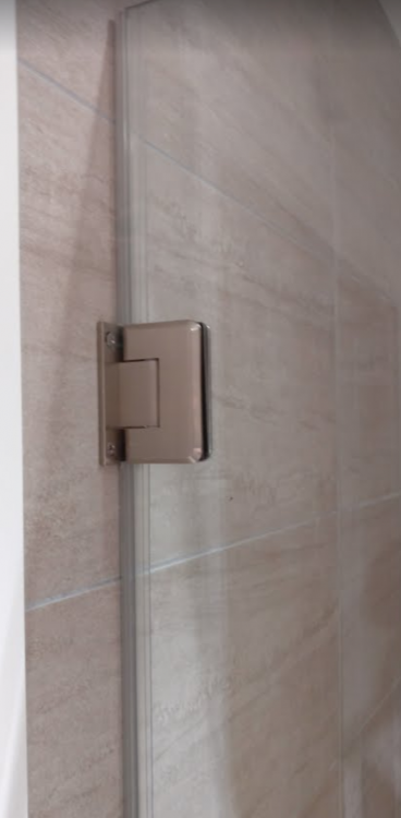

ProDave Posted November 26, 2017 Share Posted November 26, 2017 Our main bathroom will be a wet room. The ladies have just decided the layout needs to change which has presented me with a challenge. The new layout will put the bath and shower next to each other. A fixed glass screen alongside the shower area will create 2 issues, poor access to one end of the bath at floor level for cleaning, and insufficient "activity space" alongside the bath (Scottish building regs for accessible bathrooms) A solution would be a hinged shower screen. But I can't find one. It needs to be full height (no more than 2 metres) and about 900mm wide. It needs to be entirely supported on hinges that fix to the wall. The bottom should not touch the floor though I would accept a rubber strip or similar. It will be completely free at the other end, i.e. it will not close onto a frame. So friction hinges so it stays where you put it? The problem is I can't find one that does not expect to close into a frame. This just literally needs to be a piece of plain toughened class mounted on 2 hinges. Link to comment Share on other sites More sharing options...

ProDave Posted November 26, 2017 Author Share Posted November 26, 2017 No "off the peg" solutions as yet. But I think a bit more searching as found what I want. http://www.unishower.co.uk/uniclosure-900-hinged-wet-room-shower-screen.html It mentions magnetic strips as though it's intended to be a door closing into a door frame, but the picture shows it exactly as I want it as a hinged screen next so a shower not attached to anything other than the wall. Oh and they won't deliver to the Highlands. So that shows what I want, but they nay not be able to supply me. So keep looking folks. Link to comment Share on other sites More sharing options...

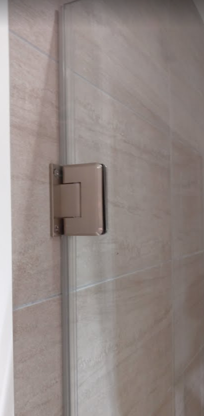

ProDave Posted March 30, 2018 Author Share Posted March 30, 2018 I am re visiting this as I am getting close to ordering. The two local glazing companies both claim to supply bespoke toughened glass and cite shower screens as an example so I will be speaking to both of them. These look good for the hinges, just 2 holes in the glass needed per hinge, no complicated cuts. https://www.ebay.co.uk/itm/Di-Vapor-R-180-Degree-Wall-Mounted-Shower-Door-Glass-Hinge-Chrome-Plated-Pin/122969345040?ssPageName=STRK%3AMEBIDX%3AIT&_trksid=p2055119.m1438.l2649 The questions are what thickness glass? 6mm I think would look and feel flimsy. Thinking of perhaps 8mm but how much would that weigh? And how many hinges? 3 or 4? Link to comment Share on other sites More sharing options...
