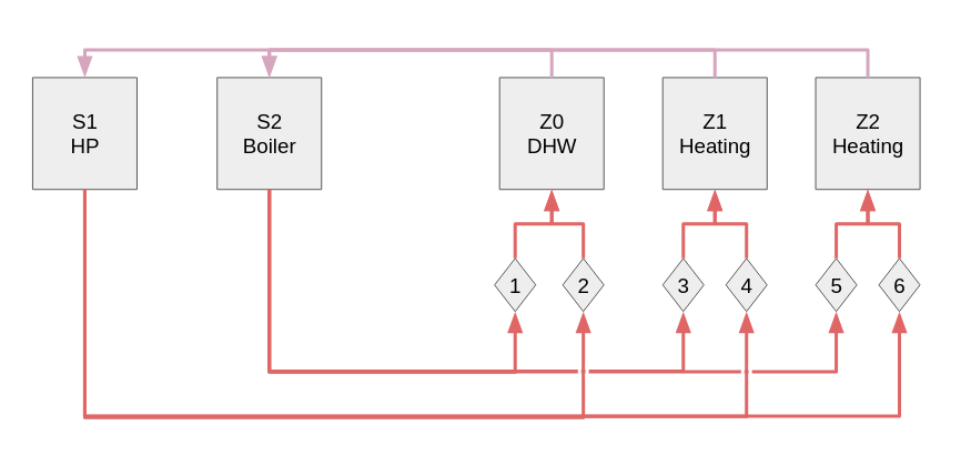

Hybrid system layout to ponder
Was chatting with heating engineer brother in law at a family get together.
He's shortly going to be upgrading his home system.
He currently has a Vaillant combi boiler rigged up as a system boiler (ie. the DHW part isn't connected)
His heating is via rads and DHW is via an unvented cylinder with a fairly large coil.  It also has a secondary coil for a solar system that provides almost all their DHW in the summer.
The upgrade involves putting UFH throughout the ground floor.  The upstairs will remain on rads.  They are all fairly oversized k2 units, with one exception which can be upgraded.
The plan or the heating would be to have 2 zones, upstairs and downstairs both running at the same low temps ie, less than 40C
He was pondering sticking a heatpump in parallel with the existing boiler so it could be run when it was most cost effective (i.e. when the cop is greater than 3.5ish making the p/kwh lower than gas)
to that end the HP wouldn't have to be large one, possibly a 5kw Vaillant.
It probably wouldn't be called on to do DHW as that is almost always cheaper by gas given the temperatures involved, though if he gets solar PV that may change.
So we came up with this very simple layout
Sources 1 & 2 are the Heat pump and Boiler respectively and both have their own pumps
There are 3 zones.
Z0 is the DHW and will require a flow of around 65
Z1 & Z2 are the UFH and Rads.  They are lower temp, weather compensated.
there are 6 x 2 port zone valves
All the zones link back to a common return line which feeds both heat sources
This should allow him to chose which heat source heats which zone.  It can allow for simultaneous heating and hot water from both sources.  He can heat the rads with gas and the UFH with HP.  Or the entire heating system with gas.  Eventually, when the gas boiler keels over, he might replace it with a second heatpump.  This would give him really high modulation using just one HP in low demand periods and both together when he needs the power.
Anyway, it was all a bit of idle speculation over mince pies - he is not experienced with HPs, though he has lots of experience with gas/oil/lpg systems
I though i would throw it open to comment, see if anyone can spot any obvious flaws or suggest improvements etc.
Merry Christmas all.
Have had mine running hybrid mode when we had cold spell.
Can see two issues
Two pumps running without hydraulic separation. I would choose which you want as master so the one that runs most the time. The other introduce via close couple tees.  If you are running WC the circulation pump will run all the time and circulate through the system when either heat source runs.
The next issue is when one heat source is running the other never gets permission to start as the return temp is always to high. So you have to be careful with settings.
There might be an issue with a heatpump being force fed super hot water into its heat exchangers, which a gas boiler could do.  Doubt an issue in practice, but let’s say you pushed in water at 90C then the refrigerant pressure might end up above the heat exchanger design pressure.  Maybe.
We ran with a heatpump and a gas boiler for a year and a half, until Mrs RobL was convinced the new fangled (diy) heatpump was ok.  The electrics totally switched one or the other in with a 4 way rotary switch, the water flow was magnetic filter->gas boiler->heatpump, and the heatpump flow & return could be closed off and bypassed.
The gas boiler was eventually taken out, as it was never used, gas meter gone, no standing charge.
One or the other would be my vote.

Hooking things together is pretty easy, if you have two pumps hydraulic separation is needed.
The other bit that occurred to me was how has he rigged the current setup? If S or Y plan he will need to rearrange to something like X or W, a PDHW plan. Or convert the combi to a 4 pipe boiler. So the existing DHW side of the boiler directly connected to cylinder coils, with pump (call for heat starts pump), expansion vessel, pressure relief filter. You can then easily run independent flow temps or WC on the CH side and fixed flow temp for cylinder.
The other way to connect boiler and HP is in series. Run both with the same WC curve. HP curves stops at say 4 degs outside and the boiler curve continues to -10. Boiler would automatically pick up heating duty as HP flow temp flat lined. So you have a temp range where both hp and ASHP run together, then the ASHP would naturally switch off. Complication is DHW.
Control
My hp has the controller built-in for hybrid, but found it wasn't really doing what I wanted, so switched that side off. So heat pump is not aware it's running hybrid mode - used home assistant instead. Have 2x generic thermostats (home assistant), one for boiler and one for heat pump, and a schedule (home assistant). Rigged up an outside temp sensor within HA. So optimised based on likely running costs based on OAT and E7. Then set up decisions based on OAT and tariff to make either HP or boiler run. DHW is done in pure hybrid mode with both boiler and HP running, this is just hard wired and a dumb relay.
If internet falls over have a normal thermostat to pick things up on ASHP only, just need to move setpoint (20) up to 20.5 and normal service is resumed. Boiler is then off for heating, but stays hybrid for DHW (all hard wired).
You can thermostats that do all the above in the USA, but the same thermostat in UK is designed for S plan, so doesn't do much for you.

Hydraulic separation:
It's unlikely (as in it could be locked out in the control strategy) that two sources (HP & Boiler) would ever be connected to the same zone so the pumps would not be interacting anywhere except the return line.  As long as there is a close coupled tee/LLH or even buffer in the return at the split to each source I don't think there would be any issues?
Return temps :
This might be an issue if the boiler is running high temps and flow to the DHW and the coil isn't big enough to dump the energy so the return temp is higher than the HP wants and it never starts (as you said). However, in this case wouldn't the warmer water just flow through and heat the heating zone anyway. This would be a slight ineffiicency as you would effectively be using the gas boiler to heat the house when you could have been using the heat pump. On the other hand, you'd probably get a bit more efficency from the boiler as the rerun temp would be lower?  If this situation was a major concern it could be avoided by not running the HP when the boiler is running or at least when the return temp is too high.  This would also be used to prevent too hot water ever reaching the HP and any concerns about refrigerant over heating/pressure.
Current set up.
He has a Y plan I believe, but it's not a major issue as the current plant room will have to be moved and reconfigured during the upgrade (they're extending their kitchen into the current utility room) and he'll be repiping to the upstairs and of course the new UFH.
The series layout is intriguing but the idea is the system would initially be just the boiler but piped out so adding a HP later would be trivial. I can see there would be a slight efficiency advantage when there is overlap but, as you say, the DHW might be problematic.
Control
This is the heart of the issue. He'd need to find a control system to do all of this. I'm not sure if the vaillant controllers can and if they can't, can they play nice with a 3rd party system that can?

Just been thinking and in it's simplest form, you would run both the boiler and heat pump on the same WC curve. All could be hard wired.
Time based switching (cost) - £60
Then use a simple single channel time switch to deliver a run permission to either the HP or boiler. HP connected to the NC connection and boiler NO connection, with the other zero volt switching wire to common.
Temperature based switching (heat pump capacity limited) - £100
Same as above but replace time switch for external thermostat.
Time and temperature switching (combination of cost and capacity limit) - £160. combine the two above.

Been thinking some more. Run the boiler and heat pump on the same WC curve. Can easily flick between the two heat sources, via a time switch.
Or if the heat pump is smaller than needed, the return temp would and dT would not allow the flow temp to reach it's target, so then the boiler should take over if enabled.

Have similar to link, which is sold by various companies in Europe, but mine is branded Polypipe, and an item picked up on eBay. Polypipe never sold item to public in UK, think too complex for the average UK plumber.
So my intention is to use an outside weather sensor, setup WC curve (function inside controller) and use Opentherm to control boiler output based on WC curve. You can set an OAT temperature at which boiler is automatically switched off, so that switches off boiler on mild days and in summer. Use a built-in time program to stop boiler when in E7 period - big setback.
ASHP run WC mode, with a setback outside E7 period. So operation should seamlessly switch between sources, without either being aware of the other. Either heat source could be deleted with very little work.
In cooling mode ASHP will run 24/7.
No actuators on UFH manifold so all one open zone.
Only wireless items are outside sensor, and room sensors, but nothing internet connected.
