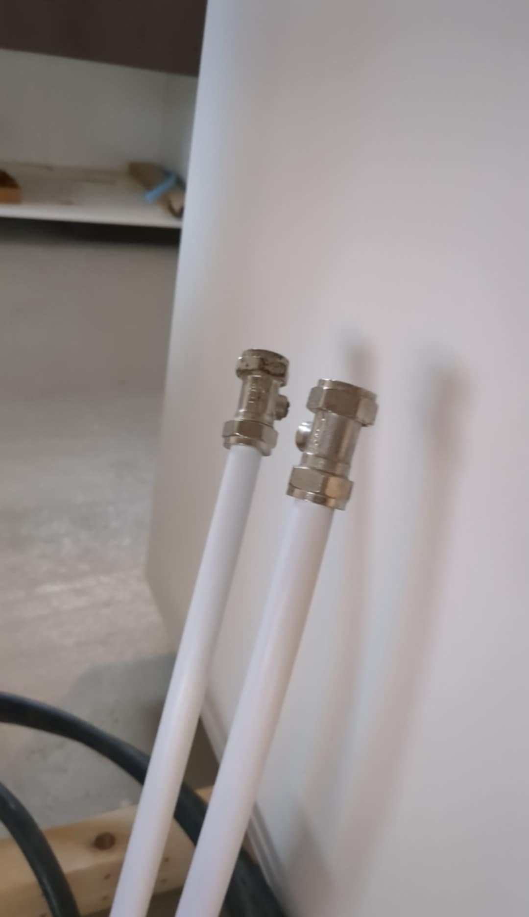

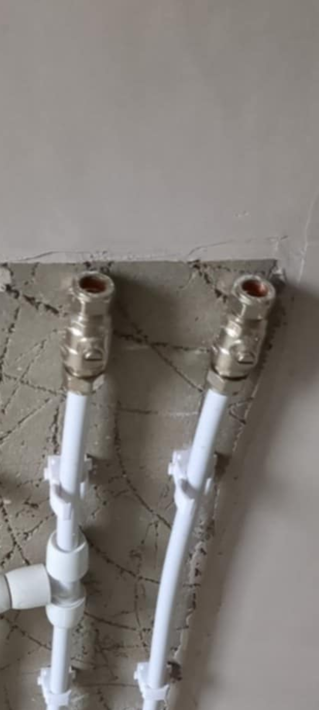

CalvinHobbes Posted Saturday at 10:36 Share Posted Saturday at 10:36 Gazooks, please can you tell me what parts do I need to get this to connect with dishwasher and have another for washing machine. Link to comment Share on other sites More sharing options...
Mr Punter Posted Saturday at 10:49 Share Posted Saturday at 10:49 Swap the isolation valves for these: https://www.screwfix.com/p/jg-speedfit-15aptp-washing-machine-tap-15mm-x-3-4-/18908 1 Link to comment Share on other sites More sharing options...
joe90 Posted Saturday at 10:53 Share Posted Saturday at 10:53 Or these (my preferred type) https://www.screwfix.com/p/flomasta-compression-washing-machine-valve-without-check-valve-15mm-x-3-4-/51231. If you don’t want to drain the water then a short length of copper pipe from the existing to the new ones will work. 1 Link to comment Share on other sites More sharing options...
ProDave Posted Saturday at 11:09 Share Posted Saturday at 11:09 I am assuming those 2 pipes, one is hot water, one is cold water? So you probably won't use the hot water and you will first need a bit of pipe out of the cold isolating valve to a tee then to two washing machine valves. And some brackets to clamp the pipes to the wall. 3 Link to comment Share on other sites More sharing options...
saveasteading Posted Saturday at 12:10 Share Posted Saturday at 12:10 Take this photo to your local builders' merchants or plumbers' merchant. Not screwfix, toolstation, b and q. They will sell you the necessary few parts including flexi hose. 1 Link to comment Share on other sites More sharing options...
joe90 Posted Saturday at 16:56 Share Posted Saturday at 16:56 5 hours ago, ProDave said: you will first need a bit of pipe out of the cold isolating valve to a tee then to two washing machine valves. Or one of these first…. https://www.toolstation.com/made4trade-washing-machine-tap-tee/p55176 1 Link to comment Share on other sites More sharing options...
