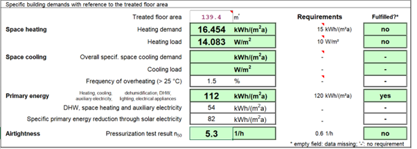

Gordo Posted December 21, 2024 Share Posted December 21, 2024 18 hours ago, SteamyTea said: So with a U-Value of 1 [W.m-2.K-1], a surface area of 32.9 [m2], the unknown ΔK, but a solution of 881 W. 881 [W] / 1 [W.m-2.K-1] x 32.9 [m2] = 26.8 [ΔK] Gee someone has regurgitated an environmental science book Link to comment Share on other sites More sharing options...
