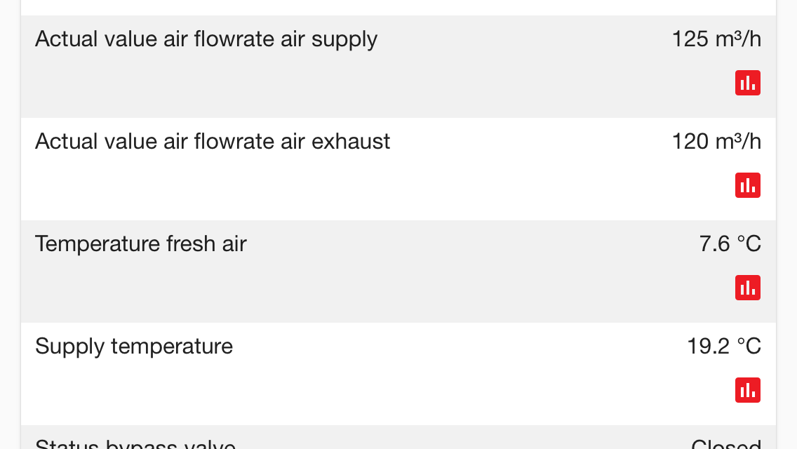

Our supply is always slightly higher than extract, so theoretically we are slightly over pressured.

Absolutely no idea, it’s what the Brink is reporting and I’ve no reason to question the accuracy thus far.

I would look at those readings and, unless I knew their accuracy was better than +/-1%, I’d conclude that the difference is too close to call.

Well if the difference is 5m3/h that's about 30 watts for deltaT of 20 ° so not exactly killing ya.  And that's probably just biasing the direction of flow of the natural air changes due to imperfect airtightness. The (pessimistic) MCS method has our house natural air changes at 200 m3/h for comparison

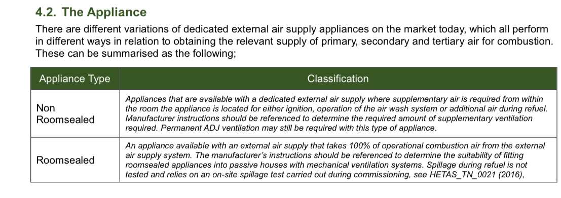

I wouldn't suggest an open flue appliance with MVHR is a good idea at all. But some people do it. You can do it with a room sealed unit but it needs to be a positive pressure MVHR

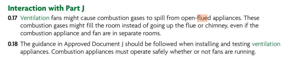

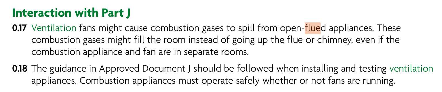

Here’s an extract form AD J which in typical fashion skirts over the subject

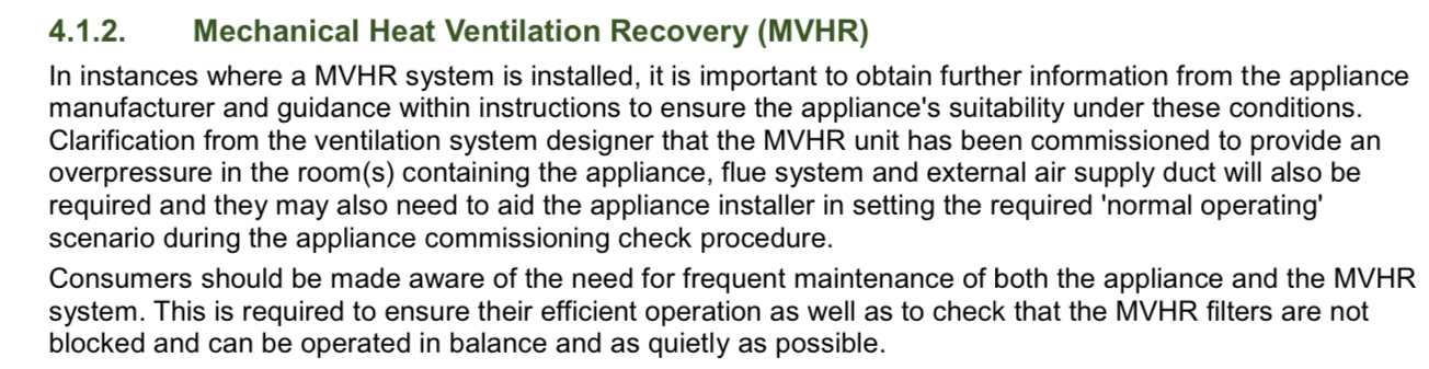

Here’s an extract form HETAS guidance regarding MVHR. For @JohnMo benefit so he knows I’m not just making it up. There so many reference materials out there. I can’t think of any benefits in opting for overall negative pressure MVHR
