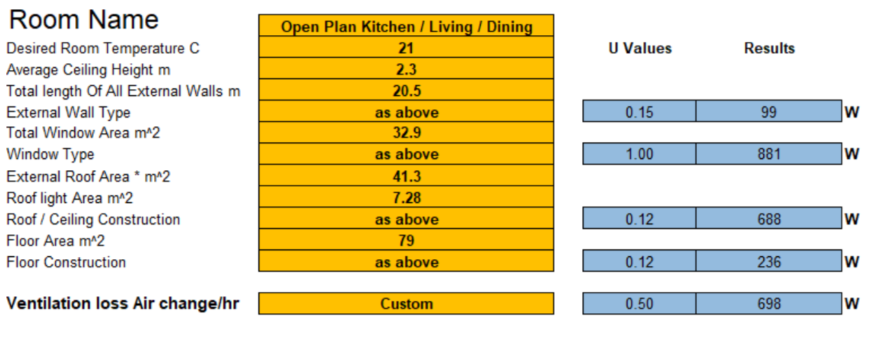

SBMS Posted December 19, 2024 Share Posted December 19, 2024 We’ve had some heat loss calcs back from the ASHP supplier. I just wanted to check the maths. Given the following for the heat loss through a 1.0 Uw window: the window area is 32.9m2 and the resultant heat loss is 881w. Am I right in thinking therefore that this is calculating for an outside temperature of about -5.8 degrees (delta t of 26.7 degrees)? Not sure I understand the maths of the above regarding the heat loss through the wall/window and ceiling… Link to comment Share on other sites More sharing options...

SBMS Posted December 19, 2024 Author Share Posted December 19, 2024 7 minutes ago, Alan Ambrose said: You could double check by putting similar assumptions into Jeremy’s spreadsheet? I’ve done this already. The MCS calcs are miles out because they can’t account for MVHR. However I’m unclear what formula they are applying. I can make the heat loss work for the window but for the wall or floor I don’t arrive at the same value for heat loss… Link to comment Share on other sites More sharing options...
Gordo Posted December 20, 2024 Share Posted December 20, 2024 32.9m2 x 1w/m2/k x 27k = 888wh sounds right Link to comment Share on other sites More sharing options...
SteamyTea Posted December 20, 2024 Share Posted December 20, 2024 7 hours ago, SBMS said: Not sure I understand the maths of the above regarding the heat loss through the wall/window and ceiling You do understand it. It is the U-Value [W.m-2.K-1 or W/m2.K (not W/m2/K as above)] multiples by the surface area [m2] multiplied by the temperature difference [ΔK]. So with a U-Value of 1 [W.m-2.K-1], a surface area of 32.9 [m2], the unknown ΔK, but a solution of 881 W. 881 [W] / 1 [W.m-2.K-1] x 32.9 [m2] = 26.8 [ΔK] To work out the assumed outside air temperature [OAT] you just subtract the external temperature from the internal temperature [IAT] i.e. 20°C. 20 [°C] - 26.8 [°C] = -6.8 [°C or K]. Now that is the power (the W) not the energy [Wh] losses over a set time period when the OAT is -6.8°C i.e. a cold winter day. To calculate the energy lost, you have to multiply by the time in hours [h] to get to Wh, which is how we purchase energy (we purchase in kWh, so need to divide by 1000). Now we do not have fixed temperature differences, they vary over the year i.e. large in winter, small in spring and autumn, irrelevant in summer (they they can be positive as well, we call that solar gain). Temperature probabilities, based on a typical metrological year [TMY] are used to calculate the amount of time spent at different OATs. Now you may have noticed that I have mixed descriptors for temperature, sometimes I have used celsius [°C] and other time kelvin [K]. This is considered very bad practice but is often used to make it easier to read. There is a reason that it is bad practice and that is if you are adding or subtraction temperatures then the scale name makes no difference as the size of the graduation is the same. But if you are multiplying or dividing, then you must use the kelvin scale or you get odd results. This is very important when working out radiative losses and the efficiency of CoP of heat pumps. To convert celsius to kelvin, you add 273.15. So -6.8°C is 266.35 [K]. (We should really use the joule [J] for energy and not the Wh, but that is another lecture) 2 2 Link to comment Share on other sites More sharing options...

joth Posted December 20, 2024 Share Posted December 20, 2024 Agree -5°C seems low for a design parameter, but also I can't see how it's consistent with other energy loss rates from the same table. E.g. for the external walls we have 99÷(0.15×20.5×2.3) = 14 K delta T. Which yields is 7°C OAT What gives? Link to comment Share on other sites More sharing options...
SBMS Posted December 20, 2024 Author Share Posted December 20, 2024 2 hours ago, joth said: Agree -5°C seems low for a design parameter, but also I can't see how it's consistent with other energy loss rates from the same table. E.g. for the external walls we have 99÷(0.15×20.5×2.3) = 14 K delta T. Which yields is 7°C OAT What gives? Completely agree - this is what I'm trying to find out from the supplier as it doesn't seem to work. Link to comment Share on other sites More sharing options...

SteamyTea Posted December 20, 2024 Share Posted December 20, 2024 I didn't look at the walls this morning, so here is my take on it. Total wall area is 20.5 [m] x 2.3 [m] = 47.15 m2 Minus the window area of 32.9 [m2] gives 14.25 [m2] Wall U-Value is 0.15 [W.m-2.K-1] Power loss though wall is 99W 0.15 [W.m-2.K-1] x 14.25 [m2] = 2.1 [W.K-1] 99 [W] / 2.1 [W.K-1] = 47 [ΔT] Something is wrong. Is it really only 14.25 m2 of wall? Link to comment Share on other sites More sharing options...
SBMS Posted December 20, 2024 Author Share Posted December 20, 2024 37 minutes ago, SteamyTea said: I didn't look at the walls this morning, so here is my take on it. Total wall area is 20.5 [m] x 2.3 [m] = 47.15 m2 Minus the window area of 32.9 [m2] gives 14.25 [m2] Wall U-Value is 0.15 [W.m-2.K-1] Power loss though wall is 99W 0.15 [W.m-2.K-1] x 14.25 [m2] = 2.1 [W.K-1] 99 [W] / 2.1 [W.K-1] = 47 [ΔT] Something is wrong. Is it really only 14.25 m2 of wall? It is a small section in my example because two of the walls are internal (it’s a corner room). The maths still doesn’t make sense. I’ve asked the question but think the supplier has finished for Xmas so won’t get an answer before. I wonder if there is some sort of magic number for thermal bridging that increases the heat loss? Also - Does the ventilation heat loss look correct? The room is 181m3 and they’ve said the ACH to 0.5. I did mention that we are having MVHR but I don’t think the ventilation heat loss of 698w takes any heat recovery into account? How would I calculate the ventilation heat loss at 0.5ACH (without MVHR and then with MVHR at 96% efficiency - zehnder q600)? Link to comment Share on other sites More sharing options...
SBMS Posted December 20, 2024 Author Share Posted December 20, 2024 (edited) 4 minutes ago, SBMS said: It is a small section in my example because two of the walls are internal (it’s a corner room). The maths still doesn’t make sense. I’ve asked the question but think the supplier has finished for Xmas so won’t get an answer before. I wonder if there is some sort of magic number for thermal bridging that increases the heat loss? Also - Does the ventilation heat loss look correct? The room is 181m3 and they’ve said the ACH to 0.5. I did mention that we are having MVHR but I don’t think the ventilation heat loss of 698w takes any heat recovery into account? How would I calculate the ventilation heat loss at 0.5ACH (without MVHR and then with MVHR at 96% efficiency - zehnder q600)? I asked ChatGPT and it stated 695W so sounds like that part of the heat loss is correct? Am I right in assuming this drops to something like 28W with MVHR? Edited December 20, 2024 by SBMS Link to comment Share on other sites More sharing options...
SteamyTea Posted December 20, 2024 Share Posted December 20, 2024 15 minutes ago, SBMS said: I wonder if there is some sort of magic number for thermal bridging that increases the heat loss There is the PSI number for linear metre of exposed wall, plus the air film numbers for the wall area. Off the top of my head I don't know them, but think there is something in the Building Regs about it. MVHR is additional loss to normal ventilation losses. Think of it as a bathroom with the window open (normal ventilation losses) then turn on the extractor fan, it does not make the window close. So even with heat recovery, it still increases the overall losses. Why it is vitally important to get the airtightness detail right. I am out now, but to calculate the air losses at 0.5 ACH, you multiply the volume by the air density, 1.25 kg.m-3, then multiply by the ACH, that will give you about 115 kg of air, then multiply by the specific heat capacity if air, 1 kJ.kg-1.K-1 and finally by the ∆T, should bring you to about 3 MJ.h-1. That is around 850 W, which seems high, so I may have made a mistake somewhere (no pencil and paper to write the numbers down). Link to comment Share on other sites More sharing options...

joth Posted December 20, 2024 Share Posted December 20, 2024 1 hour ago, SteamyTea said: That is around 850 W, which seems high, so I may have made a mistake somewhere (no pencil and paper to write the numbers down). Your numbers look right. MCS uses an "Air Change Factor (W/m³K)" of 0.33 which is basically your 1.25 kg.m-3 * 1 kJ.kg-1.K-1 in watts. Then multiplies that be (volume x delta-T x ACH). The empty MCS calc can be downloaded here if you'd like to play more 😄 https://mcscertified.com/wp-content/uploads/2024/12/MCS-Heat-Pump-Calculator-Version-1.10-unlocked.xlsm Basically, it's a very big room. Link to comment Share on other sites More sharing options...

SBMS Posted December 20, 2024 Author Share Posted December 20, 2024 (edited) 2 hours ago, SteamyTea said: then MVHR adds to the losses. Surely only a tiny amount? If my house’s ACH50 is around 0.5, then the normalised infiltration rate I’ve seen used is 1/20 of this so 1/20 of the 698W is lost to ventilation. So the actual ACH is nowhere near 0.5 and the uncontrolled ventilation loss is around 35W. I then add my MVHR which, let’s say I run at ACH 0.5 but it’s recovering 96% of that heat loss. So yes it adds to the ventilation losses but only about 4% of that 698W figure (28W). so the actual losses to ventilation would be nearer 63W? Does this sound right? Edited December 20, 2024 by SBMS Link to comment Share on other sites More sharing options...
SteamyTea Posted December 20, 2024 Share Posted December 20, 2024 10 minutes ago, SBMS said: this sound right Yes it does. If you were loosing nearly 24 kWh a day, the heating bill would be horrible. Half time on the play ATM. Link to comment Share on other sites More sharing options...
SBMS Posted December 20, 2024 Author Share Posted December 20, 2024 1 minute ago, SteamyTea said: Yes it does. If you were loosing nearly 24 kWh a day, the heating bill would be horrible. Half time on the play ATM. Thanks @SteamyTea. So is it fair to say the heat loss calculation done by the MSC supplier is horribly going to oversize the heatpump? I imagine that I can adjust the ACH figures for natural ventilation once I have a blower test done pre ordering. We’ll target 1ACH50 - Obviously at 0.05 ACH I would die, hence I will use MVHR to make sure we don’t asphyxiate. I’ll probably run the MVHR at, say 0.3 to 0.5 which will push the ventilation rate back up to the MCS’ ventilation rate. My question then is whether MCS heat loss allows them to accommodate the heat recovery capability of the MVHR? Link to comment Share on other sites More sharing options...
