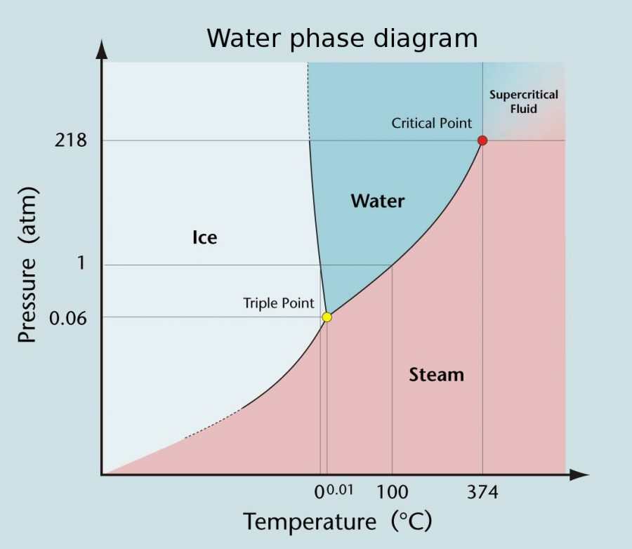

SteamyTea Posted December 12, 2024 Share Posted December 12, 2024 (edited) Water vapour can change to liquid water for a number of reasons. Temperature, air pressure and particulates in the air. That last one is often overlooked and it had a cousin. A solid surface will have a roughness to it, this can cause water vapour to transition to liquid. Also worth noting that if you see steam, the water vapour has already condensed. Just thought of more. Temperature is a measure of mean 'free path' speed. So when a pan boils, some of the water will be below 100°C, and some above. Water vapour is the same, but a larger temperature range (up to about 374°C I seem to remember). There is also a triple point where water can be a solid, liquid and a gas. Edited December 12, 2024 by SteamyTea Link to comment Share on other sites More sharing options...
