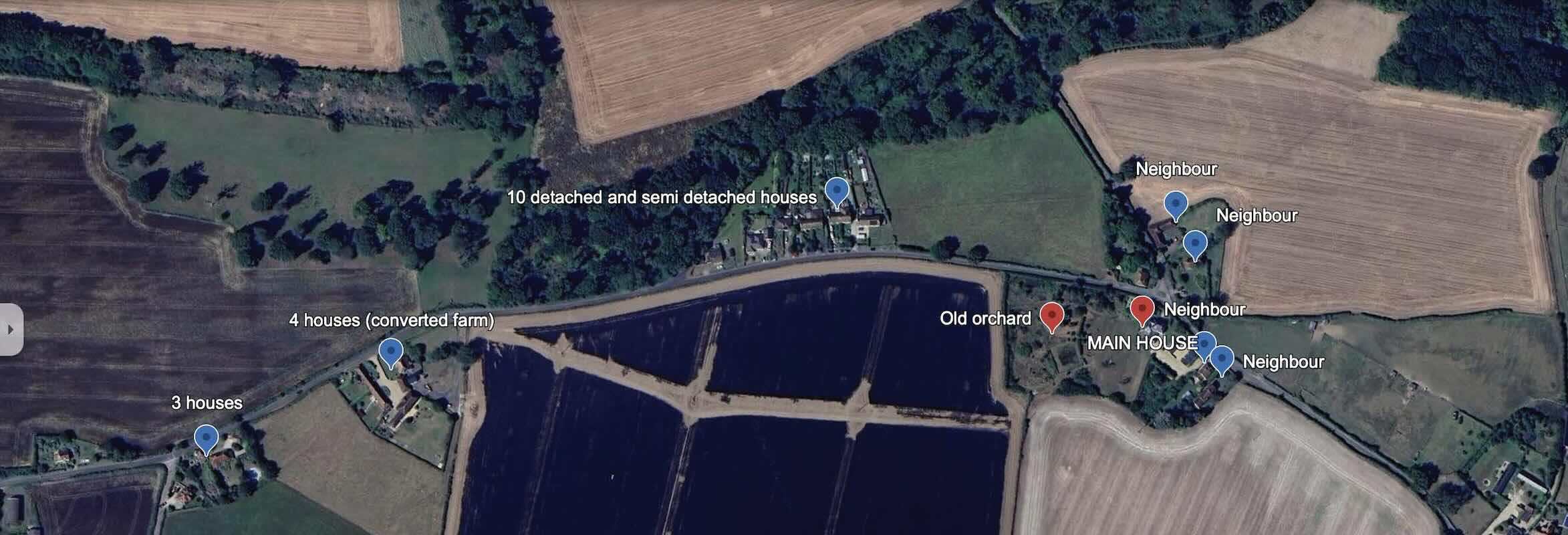

ACF Posted December 5, 2024 Posted December 5, 2024 Hi, I've just joined and have been reading lots of posts on here with increasing despondency. If anyone is interested in commenting on our situation, please feel free and thank you, even if it's relentlessly negative. We may as well be realistic. We live in an AONB on an old fruit farm with almost 3 acres. The old orchard is virtually non-existent now (not our neglect, it was last in full swing in the 1960s and had only a handful of gnarled old cherry trees left when we arrived 4 years ago) so it's effectively just a large garden with an area of scrubland backing onto farmland in a linear style village. We'd love to divide it into two and build a low key, probably barn style or timber framed eco home on the old orchard site, replanting a large number of the fruit trees and putting in appropriate plantings for biodiversity, selling the main house with an acre or so to fund it. Unfortunately, because there is no evidence of so much as a shed ever having been on the actual orchard site, I'm struggling to tick any of the boxes the planners would likely demand. I've done a lot of reading online but haven't yet approached a planning consultant as I don't want to waste time and money if it's a complete no-go. There would be no impact whatsoever on any neighbours as the site is very well shielded by mature hedgerows and it wouldn't detract from the beauty of the landscape either. A couple of properties in the same AONB have been granted permission in recent years for large, impressive new builds to replace tiny, ugly structures, not even a dwelling in one case, on the basis of replacement - pretty tenuous in view of the scale but still to be welcomed in my view. I just find it infuriating that a sensitive, potentially enhancing project like ours would likely be blocked as overdevelopment when it would be comparatively smaller in scale and of no consequence to anyone else. Reinstating the orchard would be a plus, however I guess the argument would be, why can't you do that anyway? Any thoughts from those who've experienced similar would be very welcome, thanks
ProDave Posted December 5, 2024 Posted December 5, 2024 Post a site layout and how it sits with other houses and the village itself, suitably anonymised, and someone may give a stab at how likely anything might be.
nod Posted December 5, 2024 Posted December 5, 2024 I think that a few years ago you could put a post on like this (With a site plan) and someone in the know would give you a definitive answer Usually no chance But with the targets that this government are setting Nowhere is safe
ACF Posted December 5, 2024 Author Posted December 5, 2024 I've posted the above image showing the layout of our part of the village - it's very spread out. Might be of use for comments. Thanks.

BotusBuild Posted December 9, 2024 Posted December 9, 2024 What is the square that is in the old orchard, just below the Old Orchard pin? Looks manmade. Walls of an old building perhaps?

ACF Posted December 11, 2024 Author Posted December 11, 2024 On 09/12/2024 at 16:43, BotusBuild said: What is the square that is in the old orchard, just below the Old Orchard pin? Looks manmade. Walls of an old building perhaps? That was a 'natural pool' that our predecessors had installed but it was such poor workmanship it was a liability so we filled it back in. Not a building, I'm afraid.
