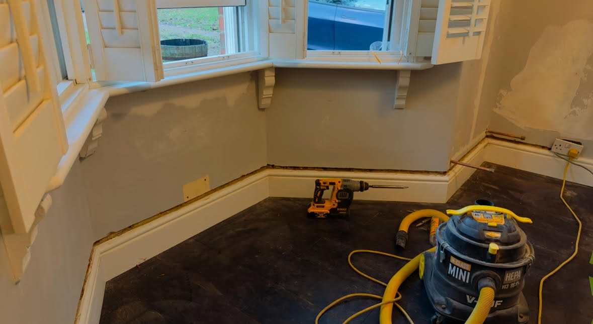

Hi everyone,
Just wondering what the best method of chasing into a lime render living room wall? It's crumbly and blown in places, which I'm fine with replastering. My plan is to chase the cables in directly above the line of the skirting board. It was originally held in place with plastic square trunking, which looked awful.
I have an angle grinder and an SDS, but I've never chased into a wall before, so really looking for some tips opn how to go about it and what to expect/look out for.
Also, if anyone wants to chime in and say, "Don't bother, just get some d-line trunking" and re-fit it", I'm also open to that, too!

Only problem with the wall chaser is that it won't work that close to the skirting board as far as I can tell, and it also not useful for internal corners. With the wall chaser I will have to hire all the bits separately, whereas I already have the angle grinder and SDS. My plan was to use a diamond bit on the internal corners. I also won't be able to use the chaser where the radiator pipes are sticking out. If it was just a vertical run, I'd definitely hire it, but this seems like a job for a more flexible solution. I'm able to seal the entire room off and I assume I can just catch at least 50% of the dust with an extra held against the direction of the cut.
The wall is a cavity wall with polybead insulation

1. I can't use a chaser, because it won't be able to make full contact with the wall due to the skirting board, making dust collection moot. It also doesn't chase internal corners, nor will it be able to chase the wall where the two central heating pipes are.
2. The dust is easily remedied by properly sealing the room, having adequate ventilation, and wearing the proper PPE.
The job is not one anyone would want to do, but it's not quite the nightmare you're suggesting. It's a 4m chase 30mm deep, 25mm of which is lime render that cuts like butter.

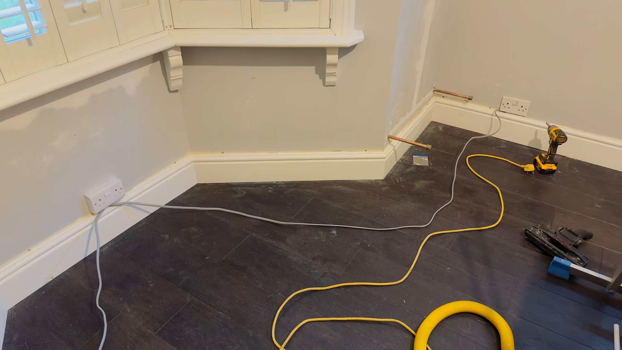

Is there an option to lift the floor and run that cable underneath?

Why not chase in a bit higher so a wall chaser would work?  You could move the sockets up a bit.  Sockets down to the skirting is old school and you have to grovel around to plug anything in.  If they are all in line I think it is fine for the regs.

All done.
Bloody hell, suggestions to rip up oak floors, hire all sorts of machinery, all for it to end up taking 15 minutes, and 5 minutes to clean it all up. Barely any dust gets loose if you one-hand the grinder and hold a decent dust extractor right next to the cutter.
For anyone else who ever comes across this thread during a Google search, here's what worked for me:
1. Set yourself up with a bit of plastic that you can tape off the room with. Takes about 5 minutes total. That way you can zone out 90% of the room and protect it from dust
2. Remove as much from the room as possible, and open up the top and bottom windows to create an air current
3. Make sure you set up all of your tools to go on the right side of your sealed off area - you don't want to open it up again while this happens.
4. With your vacuum or dust extractor in one hand and the grinder in the other, work at a moderate pace, with the vacuum attachment about 50mm from the cutting dust, and 90% of it will be sucked straight into the bag.
5. Chisel out everything with an SDS, chisel into the cut so as not to blow plaster
6. vacuum up all leftover bits, including the chase, and use a dustpan and brush for the big bits.
7. Leave room for at least 30 mins, then return to vacuum up the rest of the settled dust.
A mask is essential. You wouldn't want to do this in a room with carpets, or, I guess, in a room you weren't planning to decorate again, for obvious reasons. The dust increases dramatically if you cut into brick, but then you just go slower so that the vacuum can catch more.
It's an easy job, but the dust is definitely a nightmare. I cannot imagine how much you'd produce if you didn't seal off the room and work with an extractor. It would be like a sandstorm.
  • Like 3

No, I just freehanded the whole thing. It's a cordless Dewalt - I didn't have any problem with it beyond the first 30 seconds. If you hold it as close to the neck as possible, the torque doesn't really produce any discernible wobble.
That being said, cutting vertical with one hand is significantly harder for some reason, and I'd say more than half the dust leftover was from the two small vertical chases I had to do - very hard to follow a straight line with one hand, and as you veer off without realising, the angle the grinder spits the dist out changes and sends plumes of it past the vacuum!
I also wouldn't freehand if I was doing it for longer than a few minutes, because you have to remain quite tense, and it's bloody tiring as a result trying to juggle everything.
I'll probably buy a dust shroud for it next
