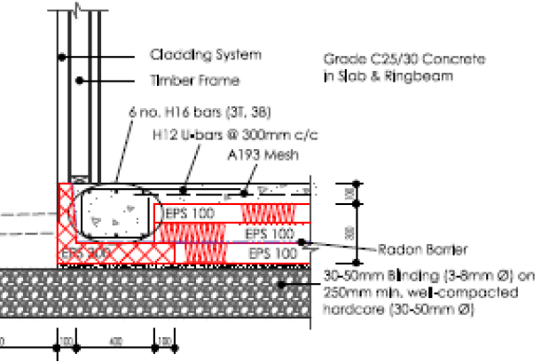

So the problem is this: I have an attached garage.   It sits on an insulated raft, like the rest of the house.  This is a section (sorry it's blurry):
There are three issues:
1.  Because I wasn't here when it was measured up for and later installed, the door frame has been installed flush with the surface of the slab.  There's no slope off the concrete, and quite a large area of slab sticking out under the garage door.  As a result, when we get heavy or driving rain, it tends to get under the door and into the garage.
2.  I need a way of allowing a car to traverse the EPS upstand.
3.  We'll have gravel outside the garage, and will need have some sort of ramp up to the garage level.  We can only bring the gravel up to within about 100mm of the slab level.

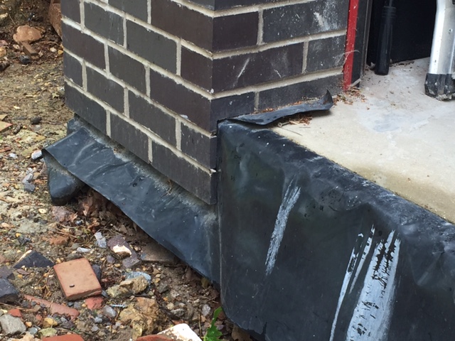

Here's a photo of one side:
I was thinking about building a reinforced strip of foundation across the front of the garage, incorporating a ramp ending up level with the slab.  I could then bridge the gap with galvanised checker plate with a slight upward lip on the garage side to go up under the seal of the garage door.  I might be able to work in a slight fall off the check plate by scrabbling a bit off the concrete that's outside the door, and lifting the DPM and cutting back the EPS a bit - not sure.
Anyone have any feedback (or better ideas)?

With all of these ideas, I'm concerned about what to do with the DPM.  I can lift it up and cut away the EPS without damaging it, but still need to make sure that I manage water at the DPM/slab junction.  That's the hardest part of all this!

Yes, that's the one.  It goes under the ringbeam from the insulation side then up between the upstand and the slab, then over the upstand and down the outside.  I was considering at least waterproofing the top surface of the slab, but hadn't thought about liquid DPM (I have half a largish tin of that lying around somewhere actually).  Makes sense, thanks.

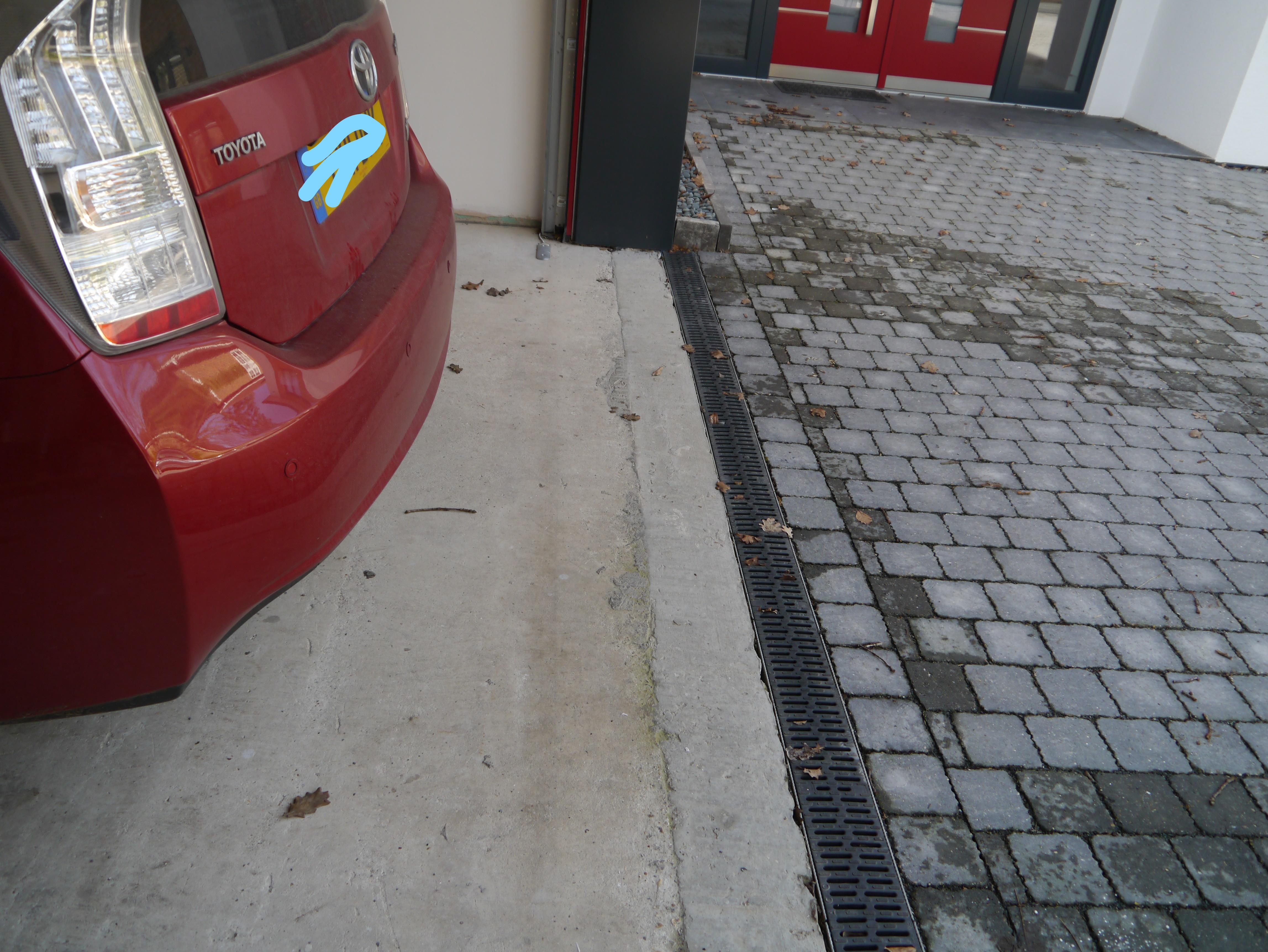

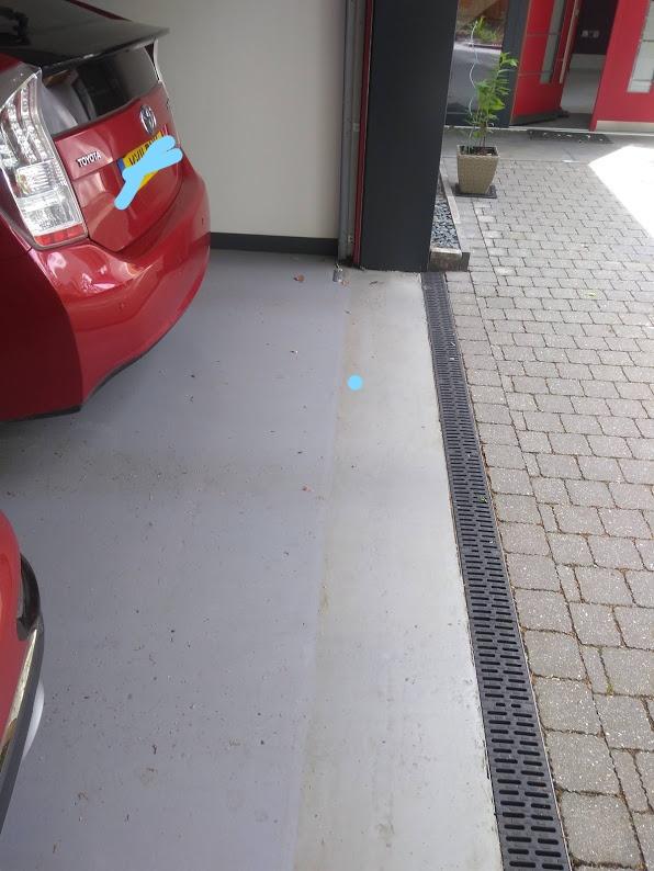

We cut out the EPS upstand in the garage door opening, pulled back the DPM and cast a level concrete infill.  The DPM  was just laid under and around  the cast concrete infill.
Looks like the same/similar approach as @Weebles
Looks a bit rough in the first photo but it was leveled with epoxy and a commercial resin floor finish was applied to the garage floor - see photos taken just now. The slight colour  difference on the garage floor is just sun and weather outside the garage door

As you can see from my photos, my slab is flat and the transition to the  ACO drainage channel and drive is also flat/level. It is SUDS drive which gently slopes way from the garage and house.
I have a 4877mm x 2125mm HORMANN electrical operated garage door, which incorporates a substantial rubber seal on the bottom of the door , which compresses slightly as the door closes..  We have never experienced any water ingress, even from driving rain, and no leaves or dirt  blow in when the door is closed.
