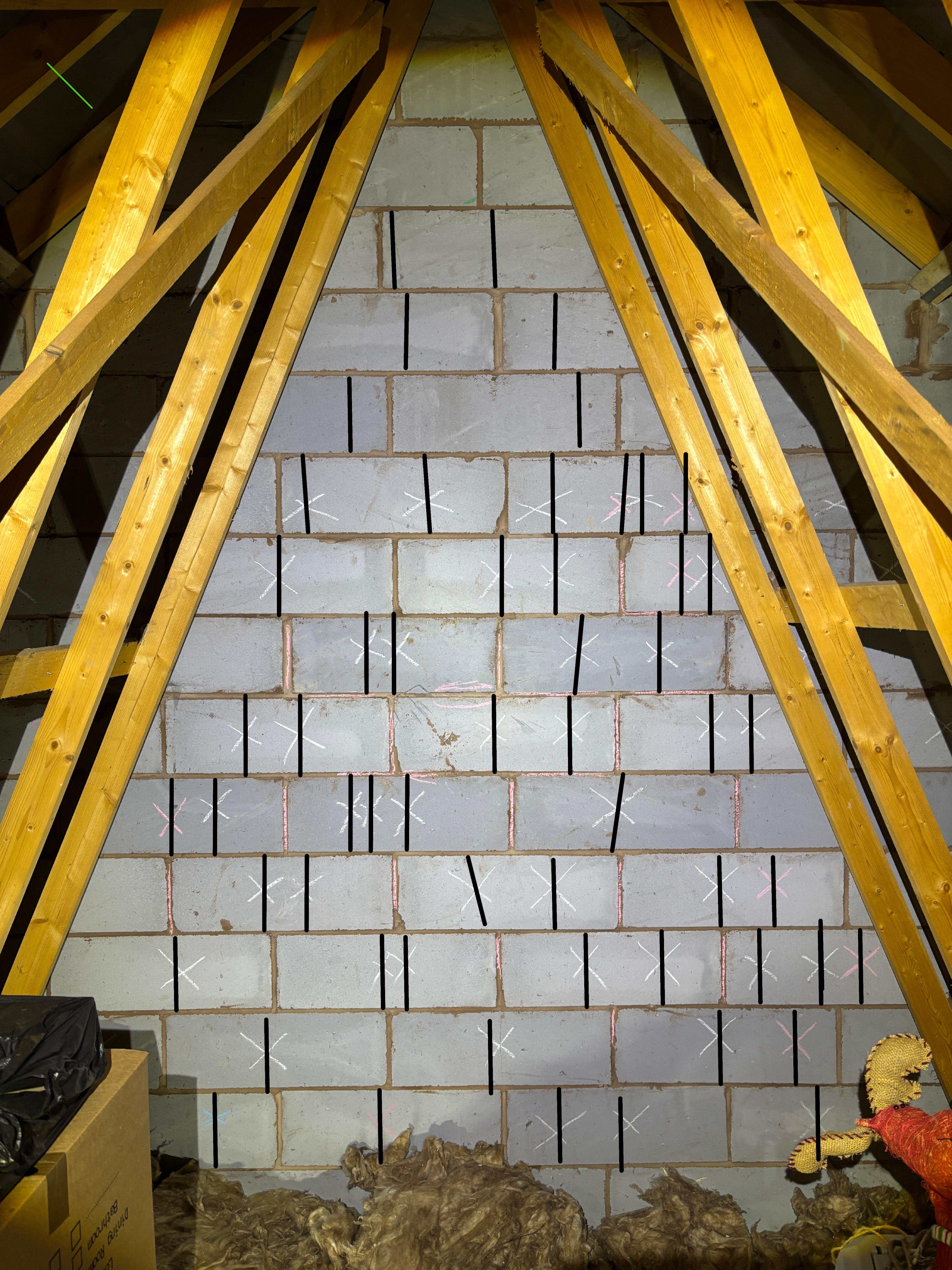

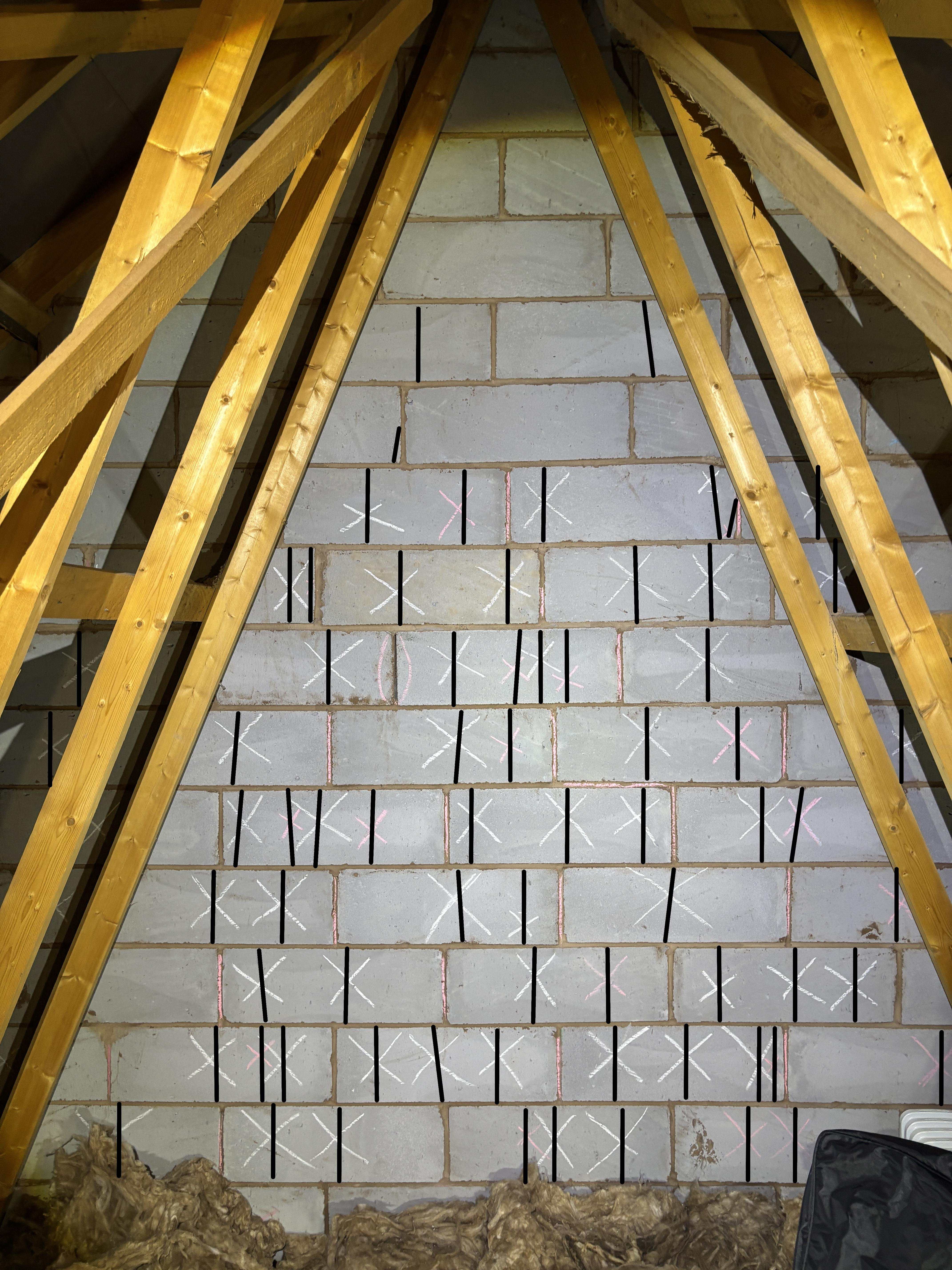

Will A Posted November 29, 2024 Author Posted November 29, 2024 These are the gable walls, the black lines are where the crack run 1

Gus Potter Posted December 4, 2024 Posted December 4, 2024 On 29/11/2024 at 15:17, Will A said: These are the gable walls, the black lines are where the crack run Help ma boab ( Scottish expression for surprise / aghast)! This needs investigating properly. On 29/11/2024 at 17:31, Mr Punter said: Get on to the manufacturer and see what they have to say. Agree. Send them your marked up photo as I think this will grab their attention. Also send a photo unmarked. On 29/11/2024 at 18:41, Will A said: They said that the blocks shouldn't shrink 5 years after the drying out process would have completed and advised that I have a structural inspection performed, my house is under NHBC warranty so they agreed to have one done, not that I hold much hope of that report being unbiased, once I have that I'll have my own performed See what the NHBC and the manufacturer say first.. let them do some leg work before you get an independant SE involved.. which may not be required... but you may want a second opinion anyway.. will be cheeper for you if the donkey work is done by those who build it and underwrote it. Question is.. that's the bit you can see.. what about the rest that you can't see! Sorry to say it but.. 2
