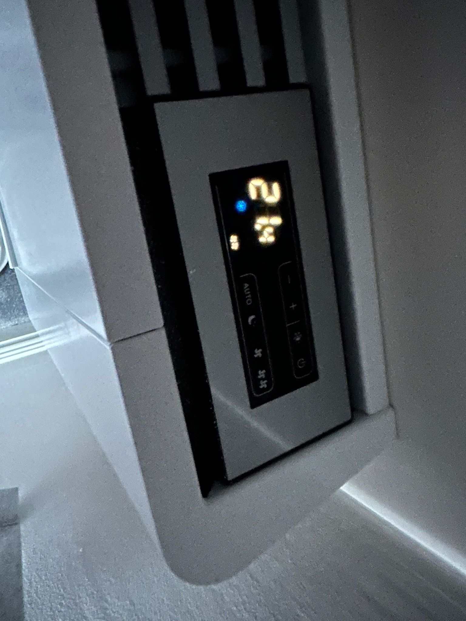

Dave Jones Posted yesterday at 07:35 Posted yesterday at 07:35 13 hours ago, flanagaj said: I’m dragging this post back up as I’m keen to get people’s thoughts on their decisions given the amazing hot summer we are having. Whose house has remained nice and cool. Be honest now! photo below taken when it was 35.2C outside according to my weather station, ASHP running at 16C (dew point was around same) bedrooms remained at 21C during peak heat dropping to 19C once dark and the fan coils clicked off. Would never be without them again. 1
SBMS Posted yesterday at 09:26 Author Posted yesterday at 09:26 1 hour ago, Dave Jones said: photo below taken when it was 35.2C outside according to my weather station, ASHP running at 16C (dew point was around same) bedrooms remained at 21C during peak heat dropping to 19C once dark and the fan coils clicked off. Would never be without them again. What units you got there @Dave Jones?

Dave Jones Posted yesterday at 10:21 Posted yesterday at 10:21 54 minutes ago, SBMS said: What units you got there @Dave Jones? panasonic smart

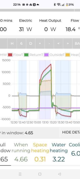

SBMS Posted yesterday at 13:03 Author Posted yesterday at 13:03 Continuously second guess as to whether to go fancoils and ASHP in reverse or true AC. Would be much more cost effective with FCUs and ASHP in reverse, but have concerns that it won't cool house sufficiently (how to calculate the ground floor cooling capacity??) and how hot water generation can happen at same time? I hear lots of people talking about manually setting jumpers on heat pumps to run in reverse, lagging of pipes for condensate etc. Sounds difficult to do as a whole house system. That, and the peak cooling load for our house (worst worst case) is circa 24kW. I don't even know what the 'cooling capacity' of a 12kW heat pump actually is (is it the same?? 12kW??)

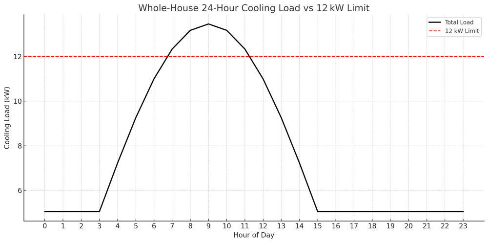

joth Posted yesterday at 13:19 Posted yesterday at 13:19 @SBMS 24kW cooling load?? If you're serious about meeting that, forget underfloor cooling and water heat pump, it won't delivery that. Talk to a commercial refrigeration expert Specifically: a 12kW heat pump will typically have a bit lower nominal cooling capacity (depends on model), but will have much much lower practical capacity unless you run it at around 5°C, with all the heavy condensation issues that brings up. UFH can't safely be run below 12°C minimum, and even then has lower effective emitter power in cooling than heating due to lack of convection currents. So I'd guess you'd get 4-6kW max effective cooling. At best you can run some modest cooling from the ashp in addition to an industrial sized A/C system to help support it. Good luck.
SBMS Posted yesterday at 13:28 Author Posted yesterday at 13:28 3 minutes ago, joth said: @SBMS 24kW cooling load?? If you're serious about meeting that, forget underfloor cooling and water heat pump, it won't delivery that. Talk to a commercial refrigeration expert Specifically: a 12kW heat pump will typically have a bit lower nominal cooling capacity (depends on model), but will have much much lower practical capacity unless you run it at around 5°C, with all the heavy condensation issues that brings up. UFH can't safely be run below 12°C minimum, and even then has lower effective emitter power in cooling than heating due to lack of convection currents. So I'd guess you'd get 4-6kW max effective cooling. At best you can run some modest cooling from the ashp in addition to an industrial sized A/C system to help support it. Good luck. Just to be clear that is Peak Cooling Load (the maximum instantaneous cooling demand). As I understand it, most HVAC designers will size equipment based off the peak load. I used these figures when calculating the peak vs the average for solar gain, temperature delta etc. Component Peak Value Average Value Ratio Solar Gain 600–800 W/m² 300–400 W/m² ~2× ΔT (cooling) 9°C ~5–6°C ~1.5× Internal Gains Max occupancy 50–75% occupancy ~0.5–0.75× Total Load 100% 50–70% ~0.6× typical My Average Cooling Load is much lower, around 9kW in the summer.

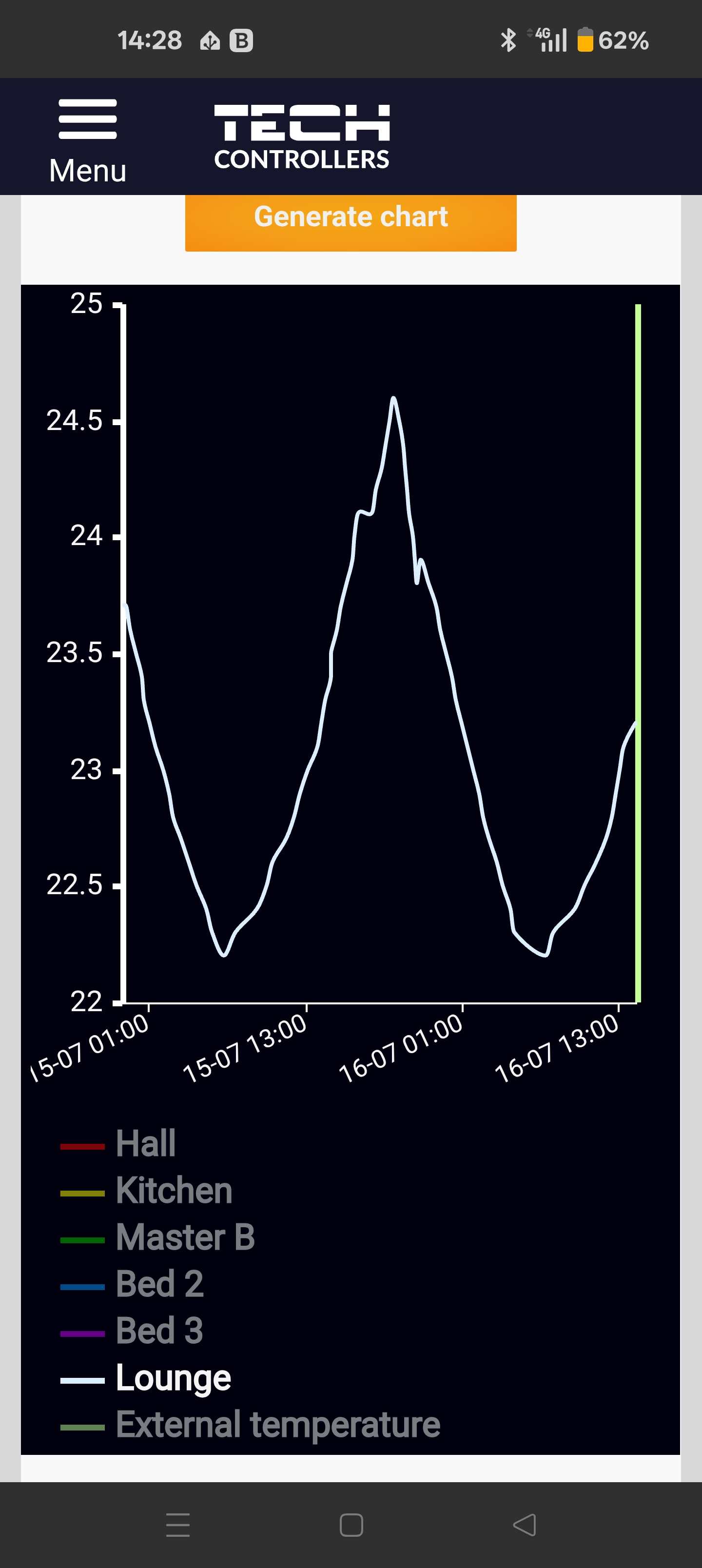

JohnMo Posted yesterday at 13:52 Posted yesterday at 13:52 29 minutes ago, SBMS said: That, and the peak cooling load for our house (worst worst case) is circa 24kW. Sorry s bit of a rant below. Cannot believe that. Our lounge is 6m tall, one end is fully glazed, to make it worse it's a bay window, even with roof overhang gets full sun from around 4pm, we control the heat with internal blinds and UFH at 300mm centres, so not even ideal for cooling. Our typical temperature trend for the lounge is below. Gets to 24.5 degs, but feels cooler due to cool floor sucking your heat away. And temp drops pretty quickly. In total we have around 50m² of glass facing south west on the front elevation of the house. A 6kW ASHP pulls about 4.5kW max. 5 minutes ago, SBMS said: My Average Cooling Load is much lower, around 9kW in the summer. But that is not real. You have zero need to size for peak load or the way the average is done, or close to it in a house. We get peak load for a few hours per day. The other day 30 degs outside and no cloud, floor pulled 50 kWh from inside house, so an average of near 2kW. According to your calcs I need nearer 50kW cooling input - that's just bonkers. You only get solar gain when sun is actually on the window and could or should only be a a few hours per day. You will have curtains or blinds (internal or external) these slash the heat gain numbers. People aren't in the room all the time. A floor a couple of degrees cooler than the air will pull a huge amount of energy out of a room. When we are at 24 degrees we have a room air to floor delta of 6 degs over 38m². You need to take a series of average heat gains and then make an average of that, then you just trickle the cooling in 24/7. What is important here is comfort, not the actual temperature.

SBMS Posted yesterday at 13:59 Author Posted yesterday at 13:59 2 minutes ago, JohnMo said: Sorry s bit of a rant below. Cannot believe that. Our lounge is 6m tall, one end is fully glazed, to make it worse it's a bay window, even with roof overhang gets full sun from around 4pm, we control the heat with internal blinds and UFH at 300mm centres, so not even ideal for cooling. Our typical temperature trend for the lounge is below. Gets to 24.5 degs, but feels cooler due to cool floor sucking your heat away. And temp drops pretty quickly. In total we have around 50m² of glass facing south west on the front elevation of the house. A 6kW ASHP pulls about 4.5kW max. But that is not real. You have zero need to size for peak load or the way the average is done, or close to it in a house. We get peak load for a few hours per day. The other day 30 degs outside and no cloud, floor pulled 50 kWh from inside house, so an average of near 2kW. According to your calcs I need nearer 50kW cooling input - that's just bonkers. You only get solar gain when sun is actually on the window and could or should only be a a few hours per day. You will have curtains or blinds (internal or external) these slash the heat gain numbers. People aren't in the room all the time. A floor a couple of degrees cooler than the air will pull a huge amount of energy out of a room. When we are at 24 degrees we have a room air to floor delta of 6 degs over 38m². You need to take a series of average heat gains and then make an average of that, then you just trickle the cooling in 24/7. What is important here is comfort, not the actual temperature. I don’t disagree with your logic @JohnMo and probably the average is even lower. I think the AC units have the ability to modulate pretty low so oversizing isn’t a massive deal and the price difference between say a 15kW or 25kW unit is pretty marginal. So does it hugely matter if I have a system larger than is needed most of the time? Appreciate it’s different with ASHP sizing and that’s important to get right. It might be different in the world of AC but all suppliers I’ve spoken to size to peak cooling load. fyi lots of south facing glass

Thorfun Posted yesterday at 15:03 Posted yesterday at 15:03 1 hour ago, SBMS said: I hear lots of people talking about manually setting jumpers on heat pumps to run in reverse, lagging of pipes for condensate etc. Sounds difficult to do as a whole house system. That, and the peak cooling load for our house (worst worst case) is circa 24kW. I don't even know what the 'cooling capacity' of a 12kW heat pump actually is (is it the same?? 12kW??) this all equals faff! it's why i ditched the idea and just went separate AC.

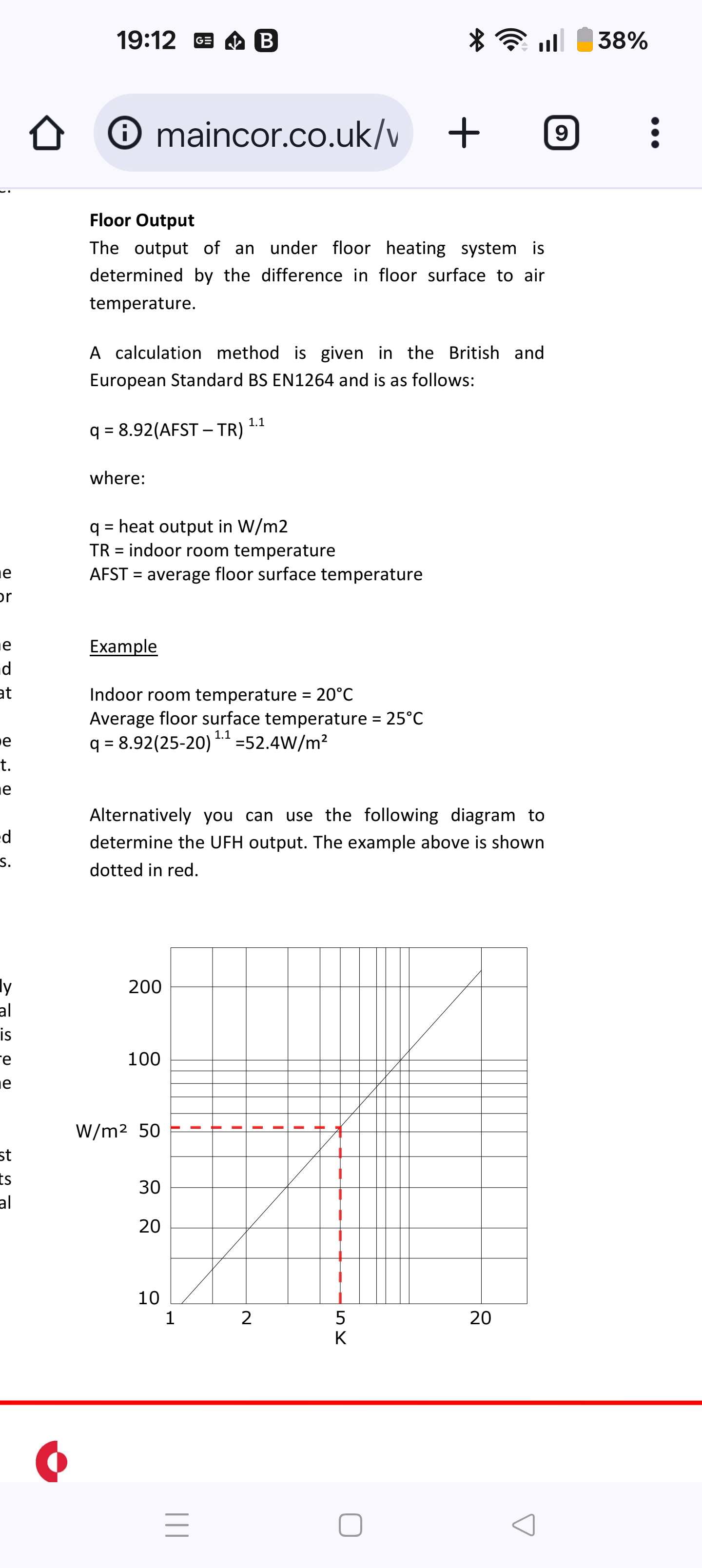

SBMS Posted yesterday at 15:56 Author Posted yesterday at 15:56 How would one go about calculating the cooling output of the slab running in reverse? Say I have a room that is 11sqm with a cooling requirement of 700 watts... How could I calculate if the slab could cool that space?
Beau Posted yesterday at 16:12 Posted yesterday at 16:12 42 minutes ago, JohnMo said: Assume get very little solar gain through windows? Never measured the glazing area but yes I suspect so.
JohnMo Posted 23 hours ago Posted 23 hours ago 2 hours ago, SBMS said: How would one go about calculating the cooling output of the slab running in reverse? Say I have a room that is 11sqm with a cooling requirement of 700 watts... How could I calculate if the slab could cool that space? The output of cooling is just the inverse of heating In simple terms if the room is 24, the floor would need to power of 63W/m² (700W /11m²), so floor temp of 24-6 (from chart below), so 18 degs floor surface temperature. As room temp gets closer to room temp output reduces eventually hitting zero.
SBMS Posted 23 hours ago Author Posted 23 hours ago 4 minutes ago, JohnMo said: The output of cooling is just the inverse of heating In simple terms if the room is 24, the floor would need to power of 63W/m² (700W /11m²), so floor temp of 24-6 (from chart below), so 18 degs floor surface temperature. As room temp gets closer to room temp output reduces eventually hitting zero. So when designing the UFH loops do we need to target a w/m2 To account for cooling demand? Ie we need an output of 63w/m2 in this instance?
JohnMo Posted 23 hours ago Posted 23 hours ago 6 minutes ago, SBMS said: So when designing the UFH loops do we need to target a w/m2 To account for cooling demand? Ie we need an output of 63w/m2 in this instance? Up to you really. I didn't even think about cooling until after the first year in the house. So my floor is designed around 18W/m². Floor surface is a property of flow temperature, pipe spacing, insulation below UFH and depth from surface. My floor runs at 18 to 19 depending on solar gain. The more solar I get the harder the ASHP works and cycle time increases from 10 to 12 minutes to a few hours. This brings down mean flow temperature, hence the difference in surface temperature. Surface covering makes a big difference, carpets kill cooling.
