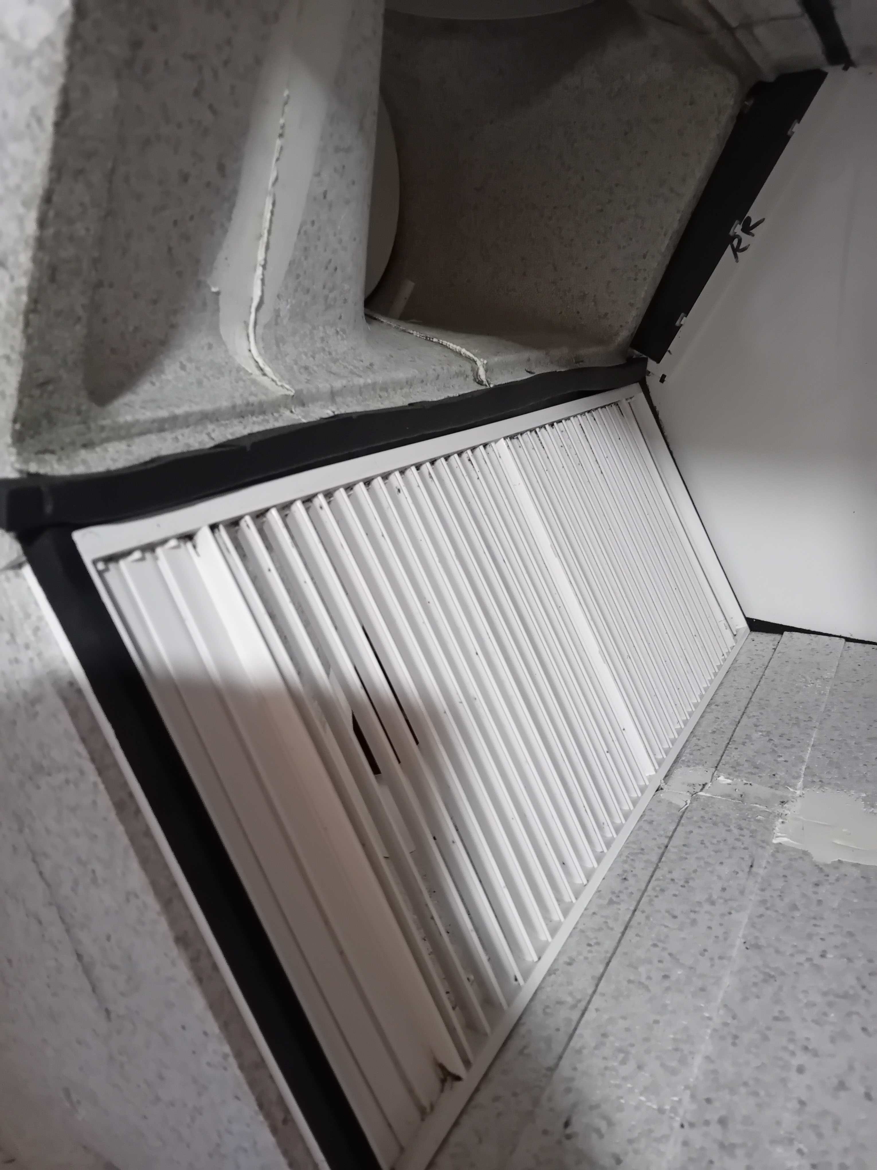

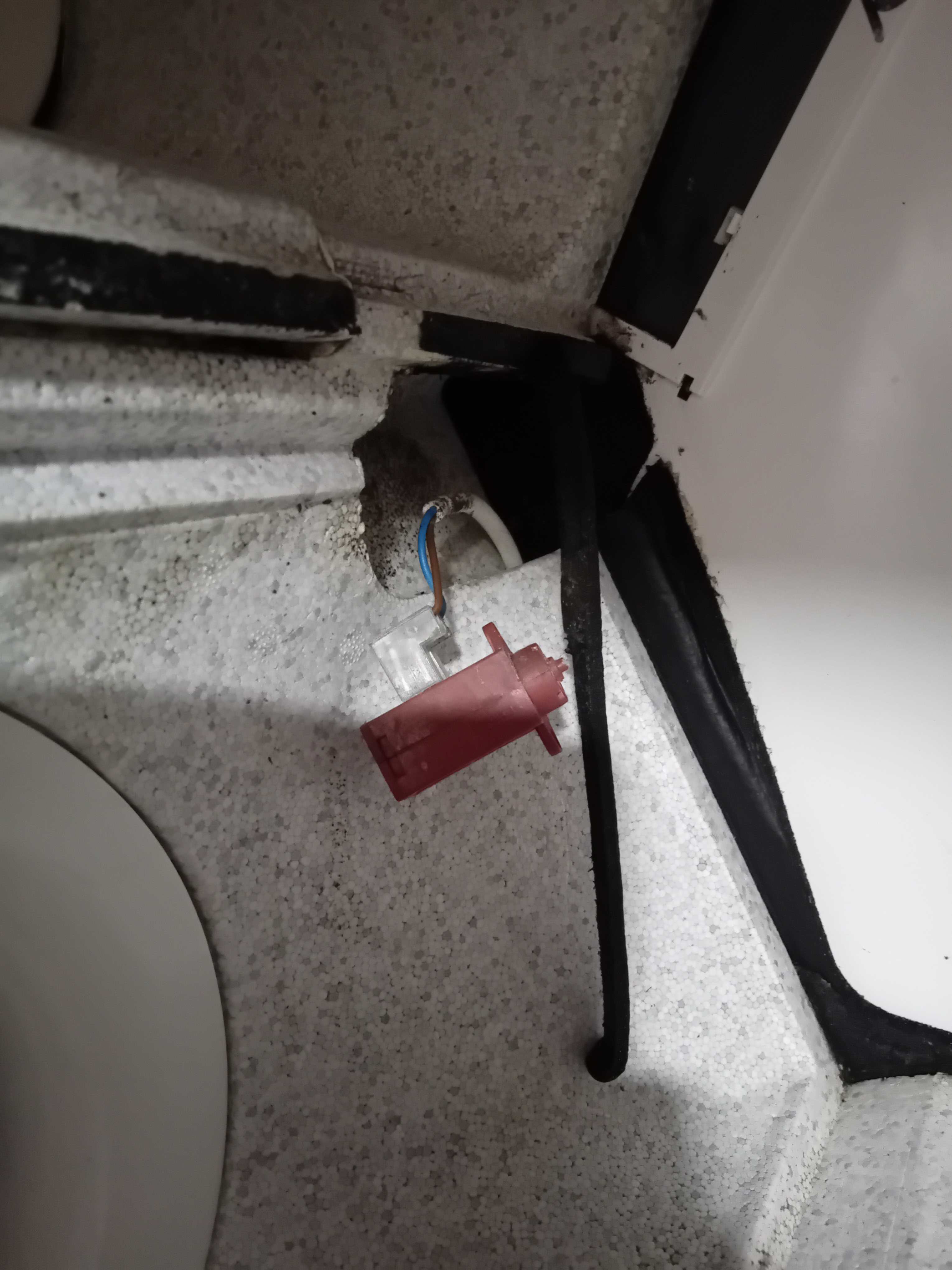

November 22, 20241 yr Following on from this original topic, I have today just completed the annual main clean and service of my MVHR unit, now 8 years old. With our unit now located within the heated envelope of the house (rather than our cold loft as it was originally), the blocked condensate drain issue has not arisen again. There is always some evidence of mould growth on the extractor fan blades and extract fan chamber, but given this is a cold and damp / wet part of the unit, that is hardly surprising. I did however uncover 2 new issues: 1. The summer bypass, which consists of a plastic louvered fin assembly in a rectangular frame, opened and closed by a solenoid, was stuck in the closed position, i.e. on summer bypass. Closer inspection revealed the end of the solenoid which allows the unit to switch from heat recovery to summer bypass had broken off. On attempting to operate the louvres by hand, they were stuck solid. The screws securing the louvre assembly to the frame had corroded to such an extent that they prevented movement, which in turn caused the solenoid to break. The screws were so far gone that they dissolved on contact with a screwdriver. With the gentle persuasion of a mallet, I was able to tap open the louvre assembly to the heat recovery position. This means that I now have no summer bypass as there is no means to close the louvres. Not an urgent problem given the time of year, but something I will have to think about getting a replacement part for. Top tip therefore, lubricate the screws to try and slow / prevent corrosion. 2. Eight years of removing and re-inserting the core has torn / destroyed one of the seals (pictured hanging). Fortunately, I had some neoprene adhesive backed tape which I used to replace. Other than that, (and a previous fan bearing replacement) the unit is still going strong.

November 23, 20241 yr Where’s the summer bypass grate ? . I had mine open due to leakage issues and I do t recall seeing anything like that .
November 23, 20241 yr Author At each end of the louvre assembly, the 3 slats you can see closed. The bypass forms when the solenoid closes the main louvres, and opens the 3 slats at each end. This prevents air cycling through the heat exchanger by guiding the airflow (with the aide of foam on each end of the heat exchange core) around the heat exchange core.

June 27, 20251 yr On 22/11/2024 at 16:51, Stones said: So would this be Summer Bypass Mode on or Off? Mine is currently set like this with the Summer Bypass Mode on By togging the mode to On or Off should i immediately be able to see the solenoid change?
June 27, 20251 yr 1 hour ago, KineticBuser said: So would this be Summer Bypass Mode on or Off? Mine is currently set like this with the Summer Bypass Mode on By togging the mode to On or Off should i immediately be able to see the solenoid change? Sorry i mean the Central Grate being open means Summer Bypass Mode is not On? If thats the case and mine is set to open with Summer Bypass On, then the solenoid is the most likely culprit? I presume thats the case so i have removed the solenoid and closed the grate manually - which i presume is ok and forces Summer Bypass on constantly? Has anyone found a solenoid replacement cheaper than from Vent Axia?
June 27, 20251 yr IIRC it's not a solenoid but rather an electrically-heated wax motor. Takes a few minutes to open and close as it heats or cools.
June 27, 20251 yr 15 minutes ago, dpmiller said: IIRC it's not a solenoid but rather an electrically-heated wax motor. Takes a few minutes to open and close as it heats or cools. Ah ok, maybe i need to leave it plugged in for 10 and see if the vents open / close then? Can you confirm the summer bypass and vent operation? The vents are on the right, so if thats the incoming air, would make sense for them to be closed and force the air past the heat exchanger
July 3, 20251 yr @Stones Did you manage to replace your actuator and find the part cheaper than from Vent Axia?
July 3, 20251 yr Author 2 hours ago, KineticBuser said: @Stones Did you manage to replace your actuator and find the part cheaper than from Vent Axia? I decided in the end to see what the difference would be without an operational summer bypass in terms of summer internal house temps. Up until this point, can't say it makes any noticable difference. I haven't got the details to hand but I recall finding an alternative and much cheaper supplier for the actuator. I also sought a price for a new louvre from vent axia. That was going to be over £100. On 27/06/2025 at 15:07, KineticBuser said: Sorry i mean the Central Grate being open means Summer Bypass Mode is not On? If thats the case and mine is set to open with Summer Bypass On, then the solenoid is the most likely culprit? I presume thats the case so i have removed the solenoid and closed the grate manually - which i presume is ok and forces Summer Bypass on constantly? Has anyone found a solenoid replacement cheaper than from Vent Axia? Central gate open = normal heat recovery mode. Summer bypass the 2 smaller end louvre sections would be open, thus bypassing the core.
