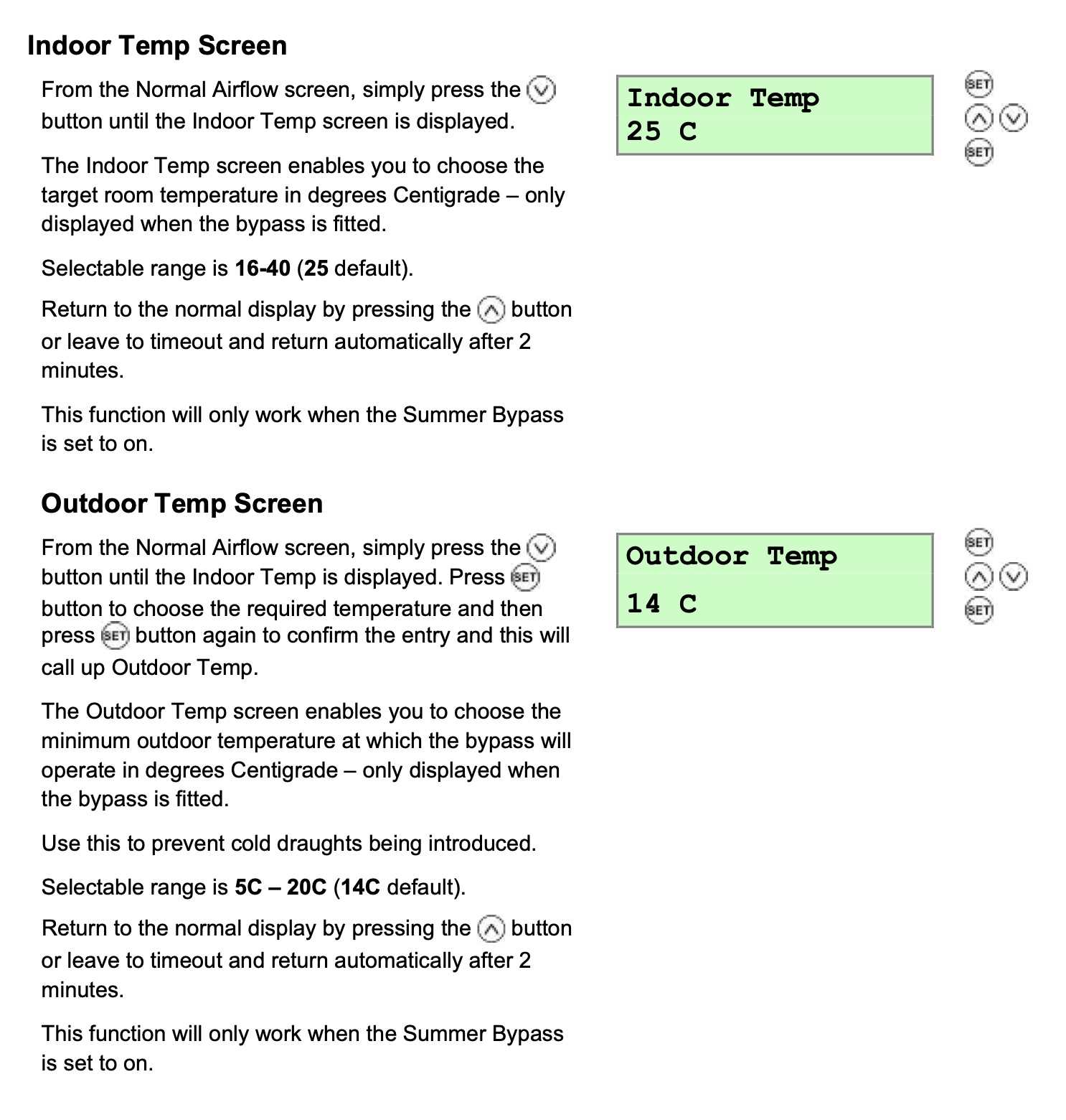

So 5 years in and think I now understand the summer bypass has minimal effective function in the warmer months. It's 16c outside, it's midnight but the air supplied is at 23c with summer bypass on or off.
I naively assumed with the bypass on it would supply the external temperature and have a moderate
cooling effect.

Your assumption isn't naive, that's exactly how summer bypass should work.
Are you sure the function is enabled, and the mechanism is in working order?

Maybe it does have a fault or I misunderstand the indoor & outdoor temperature settings.
I think I should set the indoor temp as low as possible, 16c and the outdoor as high, 20c to enable bypass.
The Outdoor Temp screen enables you to choose the
minimum outdoor temperature at which the bypass will
operate in degrees Centigrade – only displayed when
the bypass is fitted.
