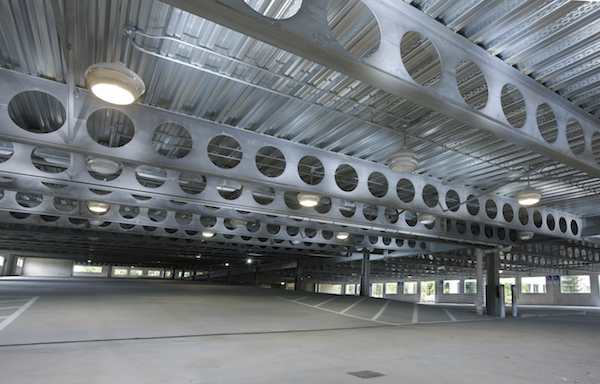

Posted (edited)
2 hours ago, Iceverge said:
why beams aren't built asymmetrically to gain maximum strength for minimal material.
They can be and are, for big structures.
The standard  ones are "hot rolled" through formers from a yellow hot balk of steel.
But beams can be welded from flat plates which can be whatever thickness and width is required, in which case they don’t even have to be parallel.
Your picture shows the possibility of increasing the web height from a hot rolled section. Castellated beams are cut to  zigzag halves and moved relatively sideways and welded together. The weld is visible in your picture.
The circle option  is a prettier effect, with some offcut waste resulting.
Very strong and allows services through.
Also note plate girders on victorian bridges, made from flat steel plates riveted together.
Edited by saveasteading
  • Like 1
Posted
I guess we are not going to agree
,but even the picture you show above shows the centre web is  biggest giving the strength
 the other picture with holes in the beam is to decrease weight as at its hieght it is big enogh to take the load
as for victroisn bridges etc
 that was their only choice as no rolling mills or fancy steels  and no welding
  Im sorry you are just wrong
  if load is vertical then a tall centre web will take the load in a thinner section tha huge flat plates at top and bottom of beams
 you dont believe me then  do the steel rule test i suggested above
  and see how weight it will support if truly vertical and not allowed to bend sideways
 or look at a truck chassis
 the main beams are always about twice the height of the top and bottom plates  and usally a C section  again to save weight for load required
 even better look at a 100ton low loader chassis  and see how that is made
and they get serius loading with all the transient loads of roads
 or look at aircraft wing main spars
plenty examples of what i am saying  is true
