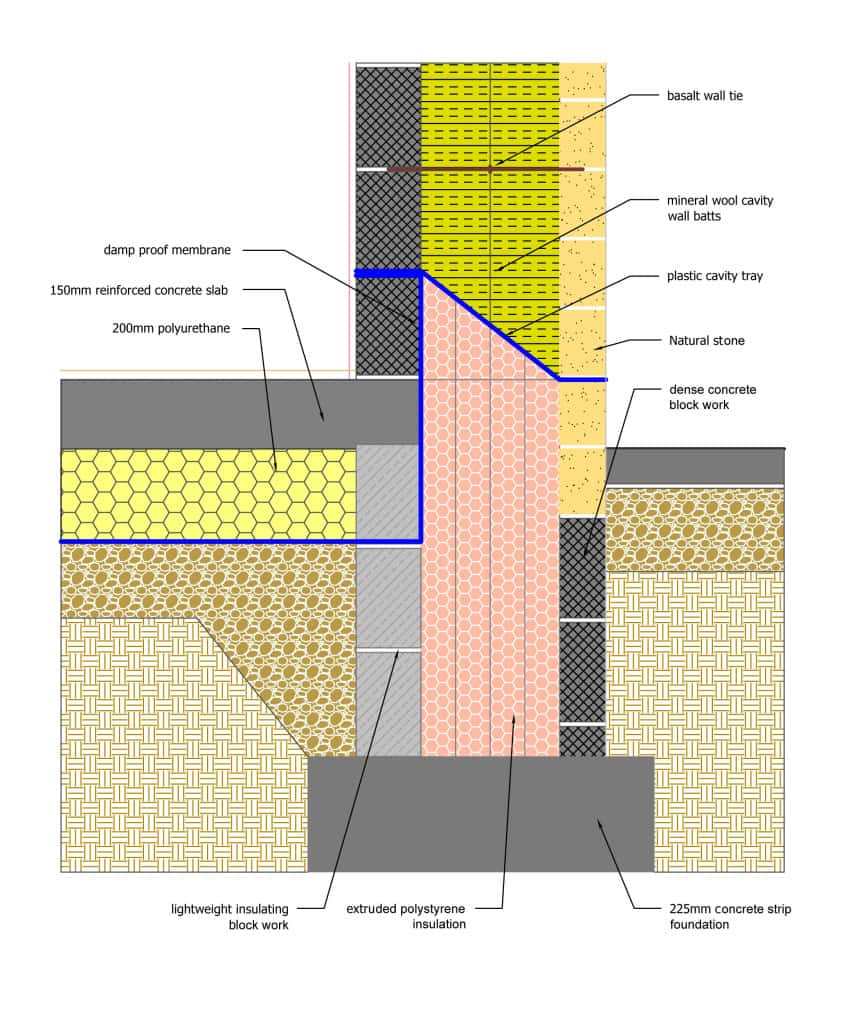

JohnMo Posted November 13, 2024 Posted November 13, 2024 Did notice a Passivhaus Architect in Forres when I was looking a few years ago. Passive slab, not sure anyone will come this far North, certainly when I was looking a few years ago. I ended up with strip foundations and stub walls and made that thermal bridge free. 1
Dunc Posted November 13, 2024 Posted November 13, 2024 +1 Good luck finding any groundworkers with experience in insulated raft foundations up here; I couldn't. Econekt based in Glasgow were prepaired to travel to Inverness. They were very helpful and engaged but ultimately the cost was prohibitive for me. I've gone with strip footings and, with advice from @JohnMo and others here, I think I've achieved a pretty decent design.

saveasteading Posted November 13, 2024 Posted November 13, 2024 5 hours ago, thaldine said: along with "passive slab" foundations) who cover Strathspey May I ask why you want a slab with a fancy name? If you stick with traditional methods you can use local builders and get the same performance, or better if you want, and way better value. I think most people on BH aim for "Near passive" levels, because of diminishing returns seeking the last few % performance. That starts with the floor.
Iceverge Posted November 14, 2024 Posted November 14, 2024 (edited) 18 hours ago, saveasteading said: think most people on BH aim for "Near passive" levels, because of diminishing returns seeking the last few % performance. That starts with the floor. More blasphemy from you @saveasteading!!! I would very much go the other direction. It's not a "I spent less cash that you" competition. Nobody buys a Rolls Royce because it's cheap to run. But because it comfortably, quiet, and (maybe not these days) well built and reliable. Passivhaus is super cheap to run but it's the comfort, the ability to retain heat, the lack of drafts, the fresh air, the quietness that make it worth the extra effort. Also if done properly you can ditch complex central heating and it's actually quite economical. Back to the build, strip foundations perform excellently if done right. I would go to the local builders merchants and attempt to only build my house from stock items. The only exception being blown cellulose I think. Edited November 14, 2024 by Iceverge 1
saveasteading Posted November 14, 2024 Posted November 14, 2024 25 minutes ago, Iceverge said: attempt to only build my house from stock items. That's a good principle. I think it needs a name in German or Norwegian. Stockhausen? Nahehaus? I'm only guessing and amalgamating many measures of quality but I would boldy say that 95% performance is indistinguishable from 100%, and the cost saving is 25%. Turn that cost into carbon by any means that suits the argument, and 'near ph' is better.
joe90 Posted November 14, 2024 Posted November 14, 2024 I did this with my strip foundations but reduced the height of the DPC to floor level in the inner wall to stop a slip plane and cracking in the plaster 1
Iceverge Posted November 14, 2024 Posted November 14, 2024 Very similar detail to ours but we filled the cavity completely EPS beads which was super easy to do.
