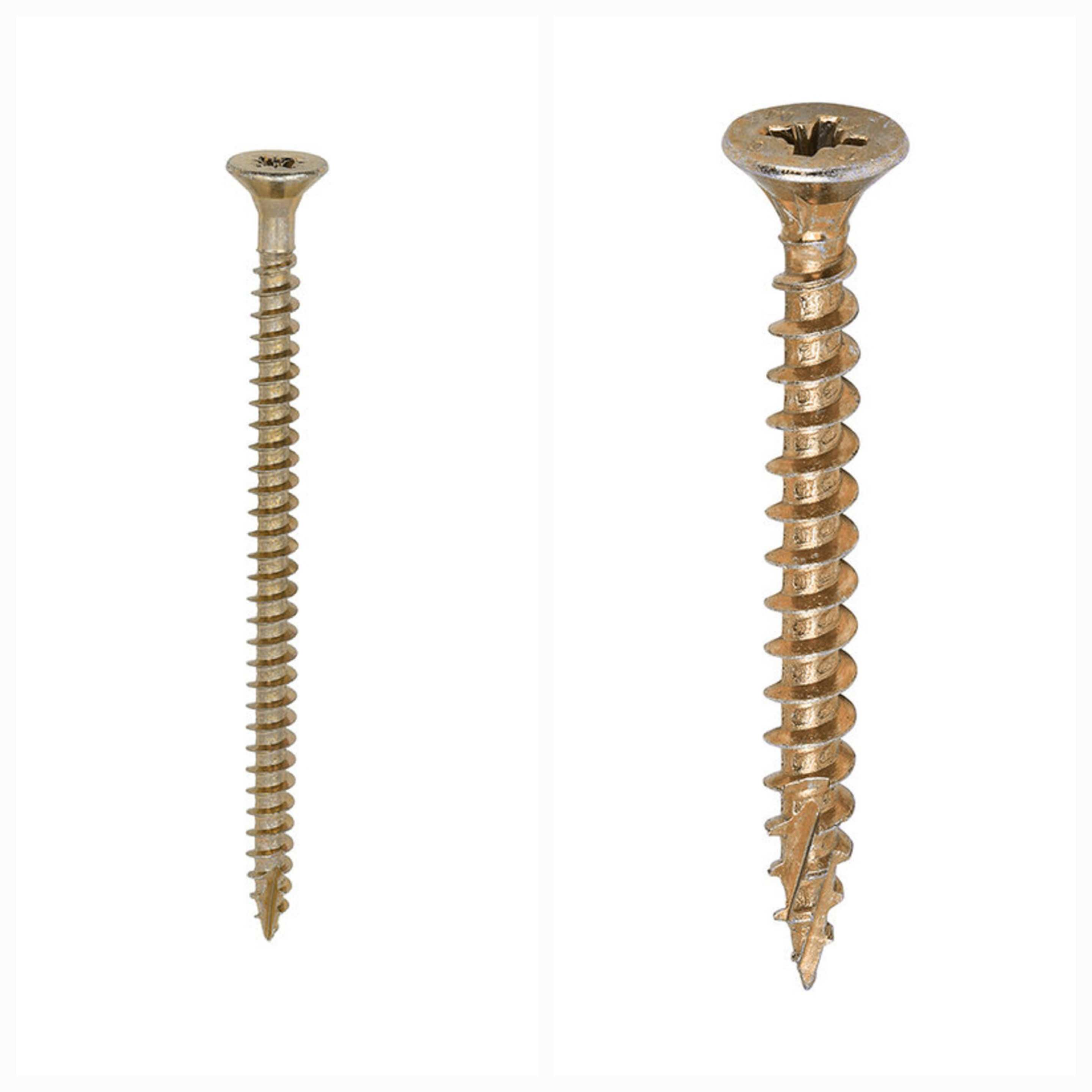

FuerteStu Posted November 14 Share Posted November 14 23 hours ago, David001 said: @FuerteStu, thanks. After seeing the earlier messages last night, I wondered if using adhesive might be the way forward, combined with screws, and you, tonight, have advised that this method has worked for you. Could you show me a pic of the kind of "thick thread wood screws" you used, please? And what kind of glue did you use? Something as 100% certain and reliable as Araldite? I've noticed that the adhesives like "Stick like S***" don't always produce a bond that lasts. Thanks again. I don't have any pictures, sorry. It was my old house. A thicker screw with thicker thread will 'bite' Better in the thin material if the door, just be careful not to over tighten. The screw is there to clamp the plinth until the glue goes off. With all glues, most of the strength is in the way it's fixed. Two surfaces rested against each other will fail. If they're clamped, the bond is stronger. 1 Link to comment Share on other sites More sharing options...

FuerteStu Posted November 15 Share Posted November 15 The first are designed for plasterboard and would not be effective in such a thin skinned door. The second ones from B&q are designed to be used in a hollow door. Use those. 1 Link to comment Share on other sites More sharing options...

FuerteStu Posted November 15 Share Posted November 15 27 minutes ago, David001 said: @FuerteStu, I've written to Plasplugs, advising them of my situation, and that my doors are just 34mms thick. I'll see what they recommend. However, just because they make plastic plugs for "hollow doors", I don't think it follows that the metal rawl-plugs for hollow doors made by the other company will not work as well, if not better. The metal fixings are for plasterboard.. They are designed to grip in a minimum of 9mm, usually 12mm thick gypsum wall. Not a 3mm widen fibre board off a door. The fixings from B&Q state that they are designed for exactly that purpose, I strongly suggest if you're going to use a fixing in the door, to use those. 1 Link to comment Share on other sites More sharing options...
