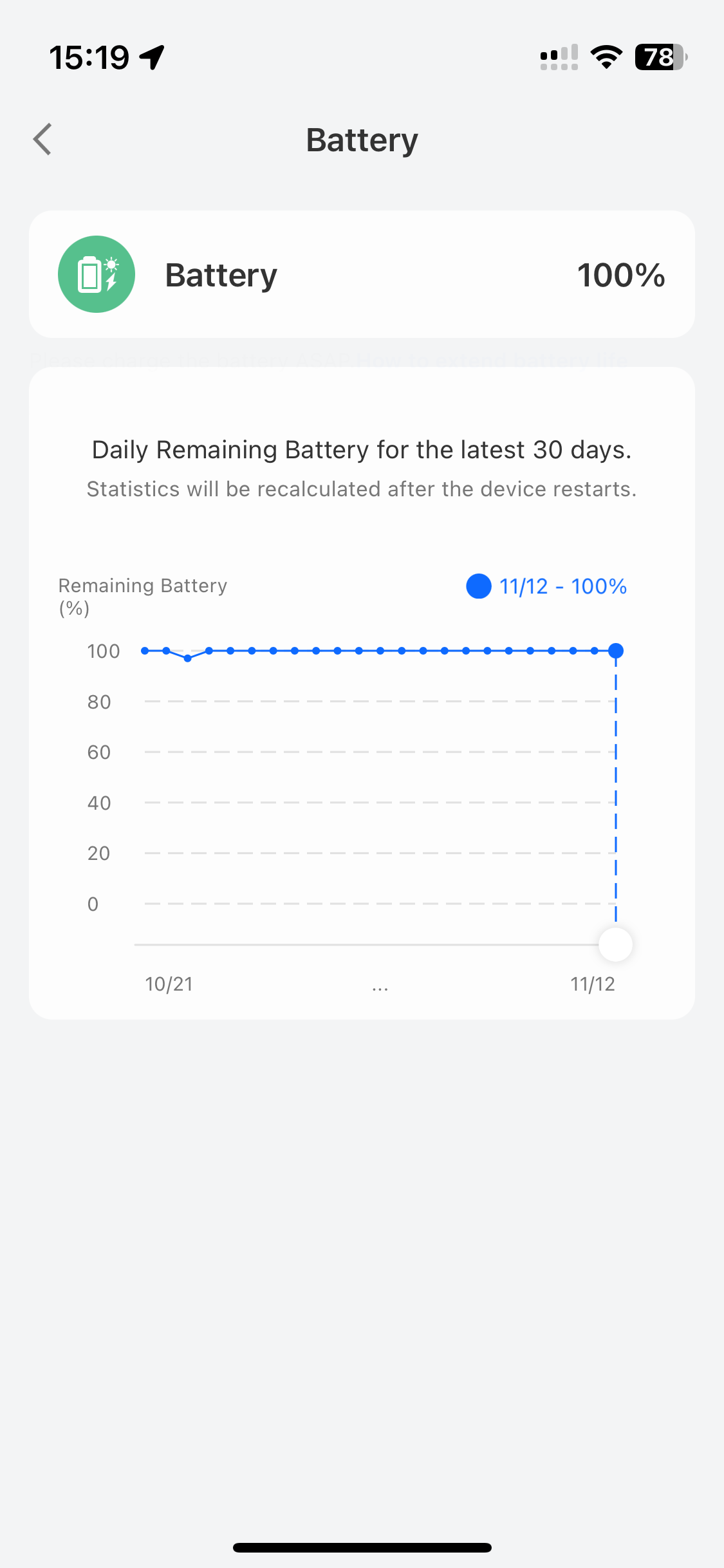

Canski Posted November 12, 2024 Posted November 12, 2024 My first solar powered Reolink camera failed due to the antenna becoming disconnected. My second one is fine but hasn’t charged in the last 2 weeks due to the weather I guess. 1

Kelvin Posted November 13, 2024 Posted November 13, 2024 My Reolink doorbell stopped displaying a picture at night as if the IR lights had stopped working but they were fine. I marked it on the todo list to sort but it seems to have fixed itself. I have a Reolink Go Plus with a solar panel that isn’t even oriented in the most efficient way and the battery charge rarely drops below 100%.
