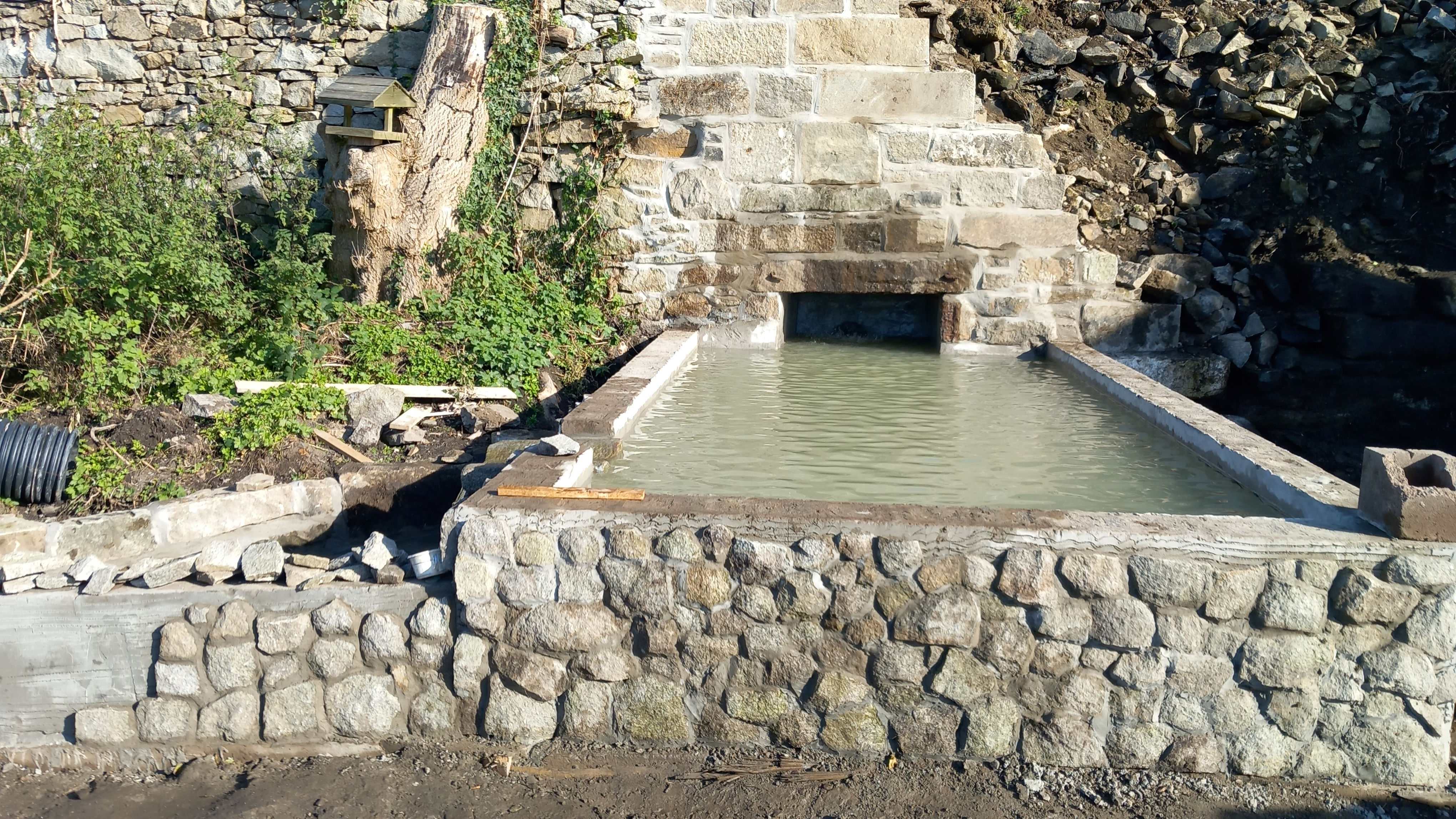

scottishjohn Posted Tuesday at 07:40 Share Posted Tuesday at 07:40 (edited) On 06/11/2024 at 18:03, Selina said: I intend to clad it in rock keeping with the home blending into the environment. And being more traditional in appearance how will you accomplish this the weight of even small stones like i did my firepond will be large and i do not think they will stay on if you intend to stick them to the straw bales then there is the problem of finding enough stones of suitable thick ness for a large area i used approx 2 tons of granite pieces + 2tons of sand + 12 bags cement to fix them and that is not to a full wall height as you will have with a house and it is very time consuming and can only be done when it is dry and need covering for at least 2days to make sure the mortar does not get washed by rain so for full nouse you will be taking 4 times that amount I used them as i have a very large volume of them on site from previous quarrying and granite set making in the past the only way i see it wroking is if you clad outside first with exterior ply and attch a mesh to it to give something for the mortar to stick to yes you could buy stone cladding panels ,but not cheap and they would require a solid frame work to fix them to I have no problem with straw as insulation where you are it will be good if thick enough ,but not as the outer wall which will still need wood for window and door openings . Edited Tuesday at 07:52 by scottishjohn Link to comment Share on other sites More sharing options...
