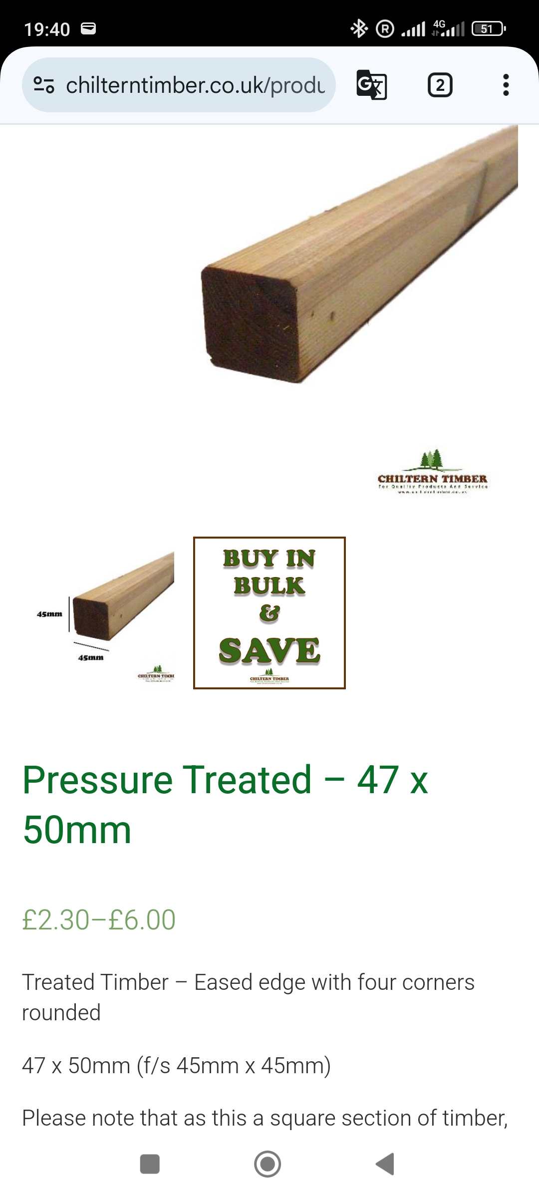

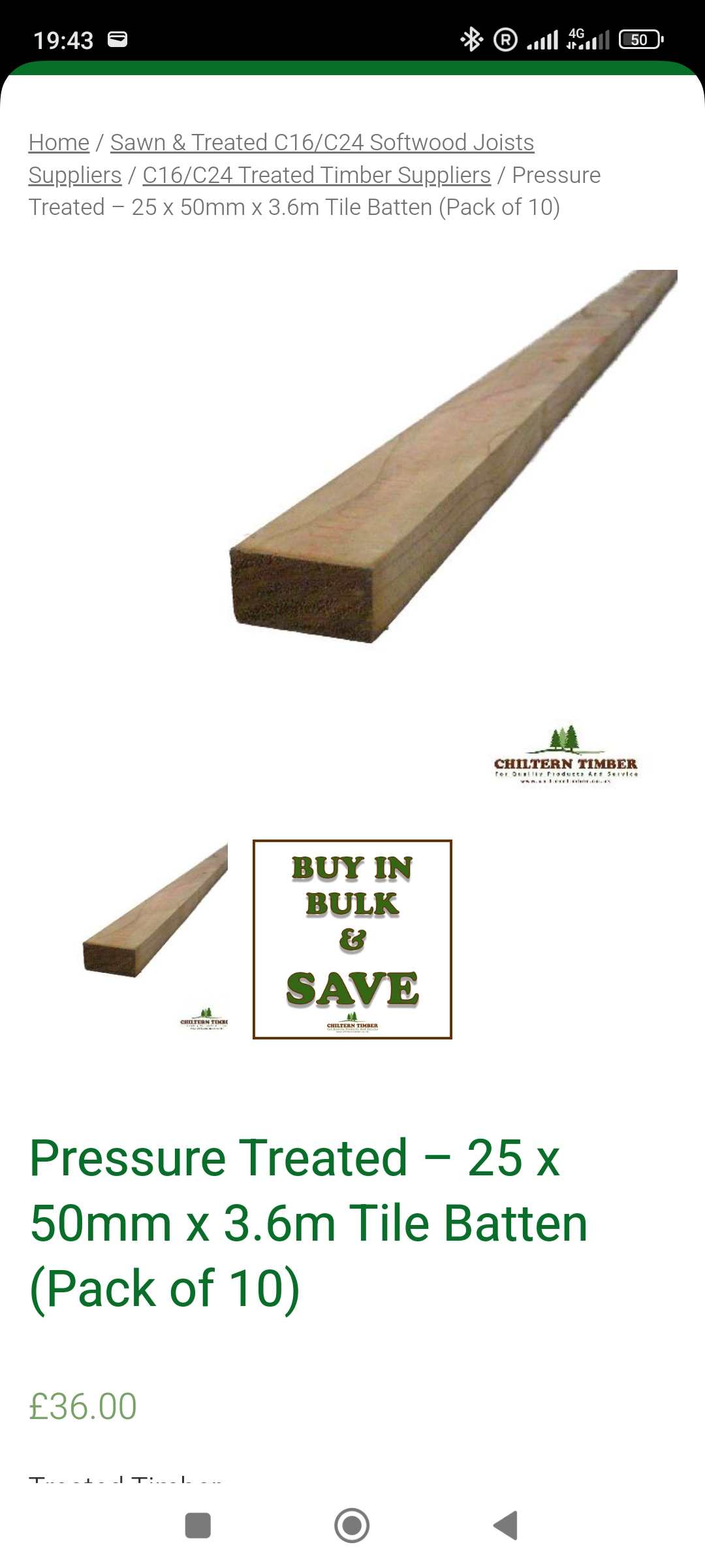

Gary Martin Posted November 21, 2024 Author Posted November 21, 2024 Thanks Iceverge my proposal was two skins of normal dense concrete blocks, not soft cavity blocks. the battens and counter battens would be 25 x50 not 38 x50 the vertical battens would have to be drilled and plugged the horizontal ones screwed to the others with 50 mm wood screws. ( vertical cladding) I agree extra work is required fixing the internal insulation boards, longer screws etc, but time would be saved on not messing around cutting the boards to fit in the cavity, around wall ties etc. Also no chasing out for cables and pipes, plus making good, as with a wet plaster finish. I still want to go cavity block built, not ICF or timber frame. my builder has just sent me pics of a 15 year old TF building that had a failed rainwater downpipe that had been leaking and splashing up under the cladding ,unseen for quite a while. The rot had gone from the sole plate to two verticals . He was brought in for minor alterations and it has progressed to a major refurb. not his original build by the way. 1

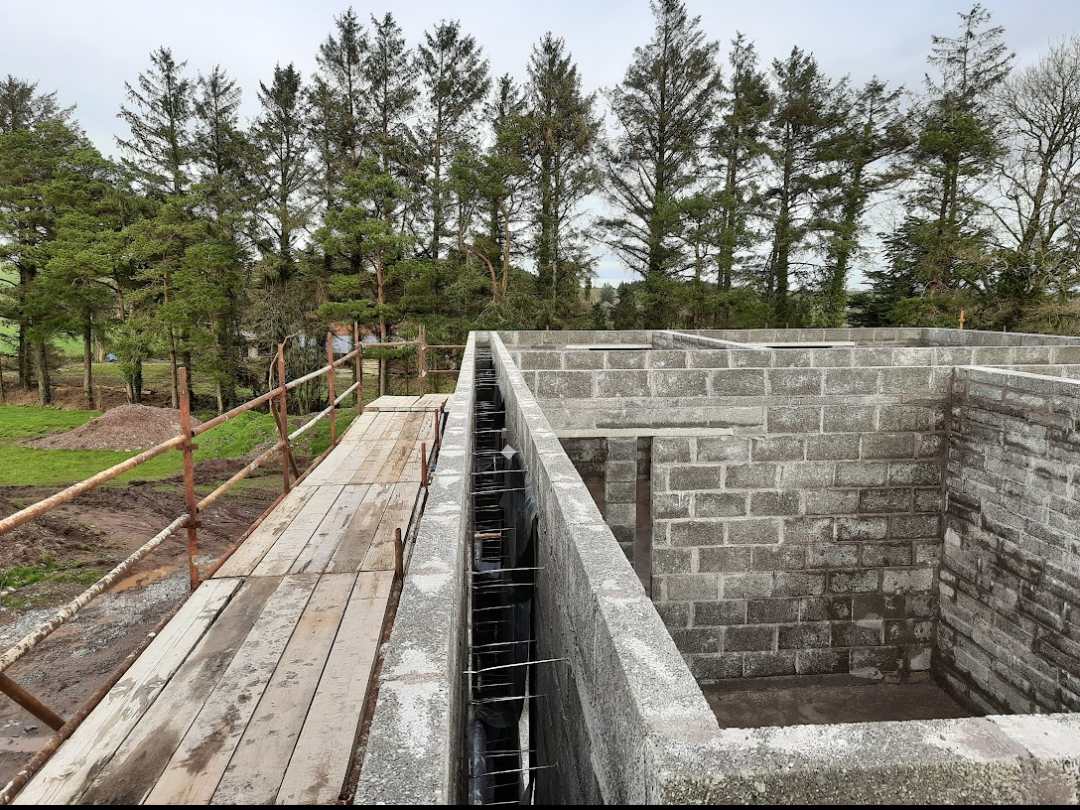

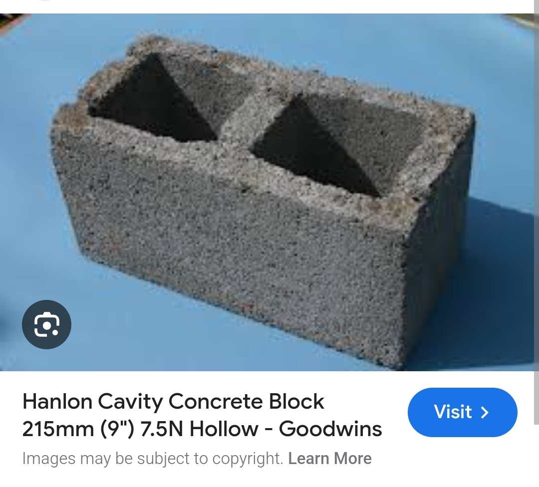

Iceverge Posted November 23, 2024 Posted November 23, 2024 (edited) On 21/11/2024 at 18:42, Gary Martin said: my proposal was two skins of normal dense concrete blocks, not soft cavity blocks. Ah ok a terminology difference. This is "cavity block." They're utter rubbish unless you're building something like garden wall. This is a cavity wall. In this case made from blocks... That's ours by the way. 250mm cavity width. Full fill with EPS bonded beads. On 21/11/2024 at 18:42, Gary Martin said: the battens and counter battens would be 25 x50 not 38 x50 Ok I'm getting my head around what you're proposing here. You'll need battens running up the wall. You can drill and secure them to the blocks. However you'll need to screw into them to take the weigh of the horizontal battens. If you were to use 2 X "25mm" thick any more than a 45mm screw would risk any slightly overdriven screws penetrating all the way through and pushing the batten off the wall. (The friction from the vertical battens being tight to the wall gives a lot of strength so you need to avoid this. That means you'd end up with 20mm of the screw penetrating the inner battens. Nowhere near enough in my opinion. A minimum solution might be 45x45mm battens vertically with 25*75mm battens horizontally. This would allow you to use a 65mm wood screw without risk of over driving it into the blocks with at least 40mm gripping. These 25*50mm battens are only any good as "spacers" in my view. They will offer very little pull out resistant and split as quickly as you can look at them. On 21/11/2024 at 18:42, Gary Martin said: On 21/11/2024 at 18:42, Gary Martin said: agree extra work is required fixing the internal insulation boards, longer screws etc, but time would be saved on not messing around cutting the boards to fit in the cavity, around wall ties etc. Also no chasing out for cables and pipes, plus making good, as with a wet plaster finish. Anyone who puts rigid PIR boards in a cavity wall is ignorant of the downsides or a moron. I would use full fill mineral wool batts or EPS blown beads instead. You could still add battens and plasterboard for a service cavity if you wanted to, although chasing and wet plaster is better in my opinion. How would you plan to deal with the thermal bridging from internal walls? Edited November 23, 2024 by Iceverge

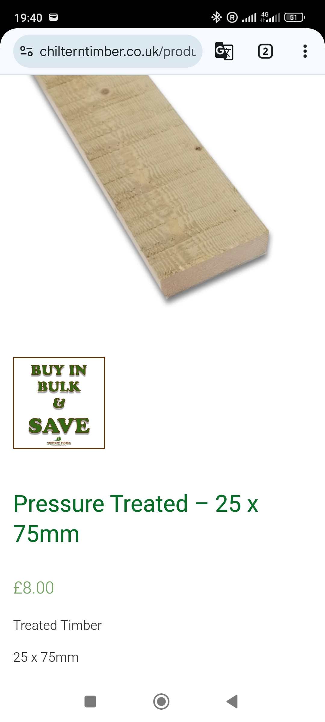

Iceverge Posted November 23, 2024 Posted November 23, 2024 Out of interest of you were to use a timber framed building as I described above you could happily run 25*70mm battens up the walls and 25*75 mm battens horizontally If you used 90mm collated stainless steel nails the 25mm thick verticals would work ok. There would be 54mm of nail straight into the structural stud which would be plenty. (90mm -25mm batten -11mm OSB.) Similarly I think you'd be ok nailing the horizontal 25*75mm battens too. 90mm stainless nails are 7p. 90mm stainless screws are 24p and take 10 times longer to fit.

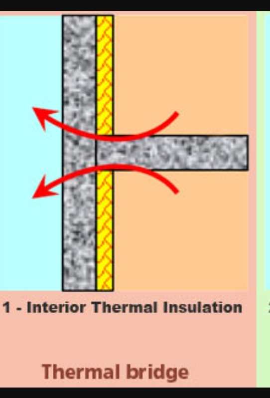

Gary Martin Posted November 26, 2024 Author Posted November 26, 2024 Iceverge thanks for your answers. yes I meant a cavity wall made with concrete blocks, (I said I was new to all this). I take on board your advice re the battens etc. what do you think of initially only minimal fixings for the horizontal battens, then concrete screws in pre drilled holes, going through both vertical and horizontal battens to hold the whole thing together ? any internal walls will be timber studs so no cold bridging at junctions. for Johnmo, of course I am not aiming or planning or hoping for a bad build, by design or construction and would like perfection. I doubt the other timber framed owners wanted the problems they got either.

Russell griffiths Posted November 27, 2024 Posted November 27, 2024 If you go with your original idea of all the insulation on the inside I’m unsure of where you would position doors and windows, you will end up with very deep external reveals as the windows will need to sit within the insulated area. have you not thought of a fairly standard insulated cavity but up the internal insulation for a better u value. so 125 cavity or something like with 90 mm cavity boards and 50mm internal, then a service void and then plasterboard.
