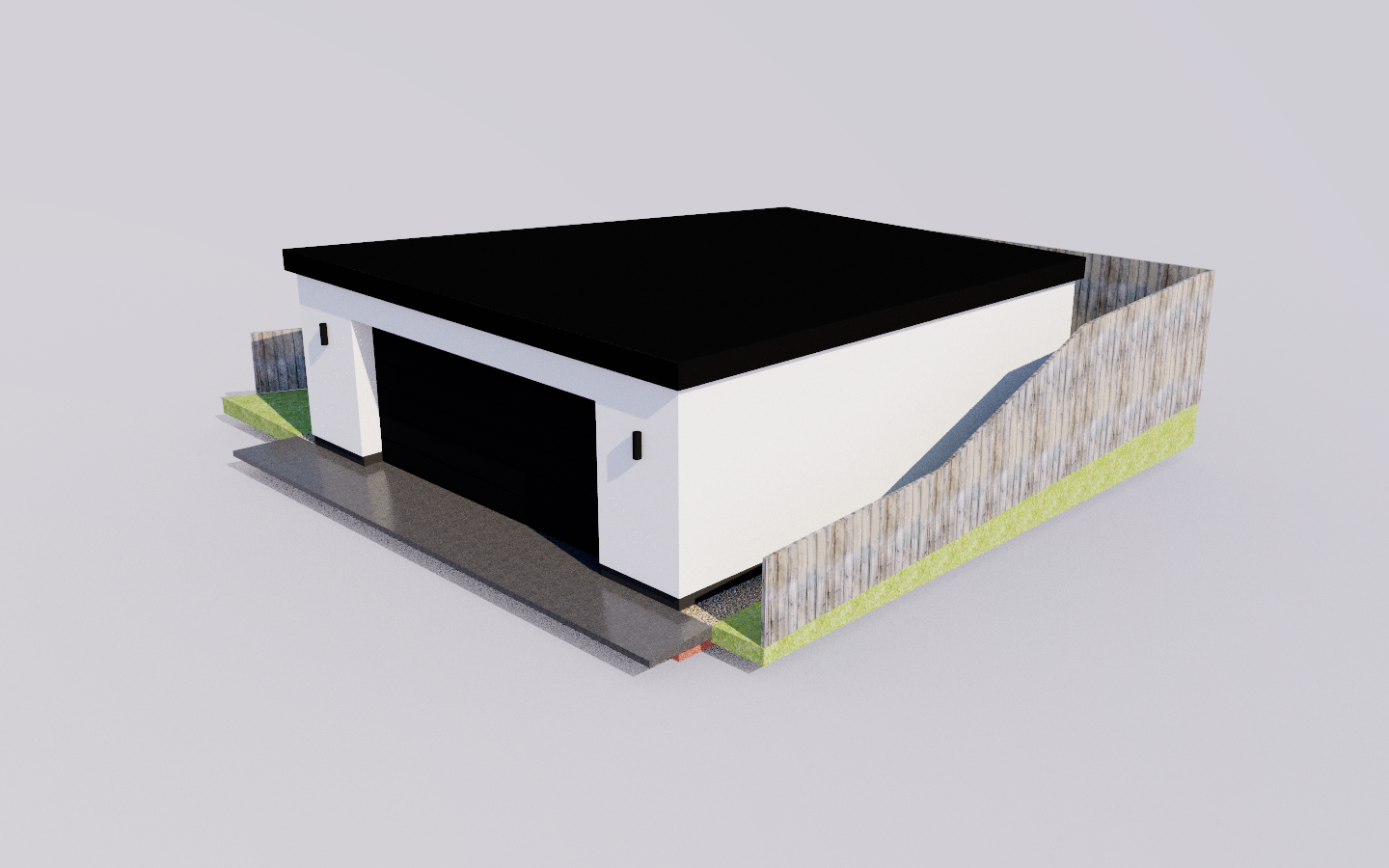

Designing my new build detached garage in SketchUp was easy. Finding someone to convert my fantasy garage into something that Building Control would be happy with was more difficult.

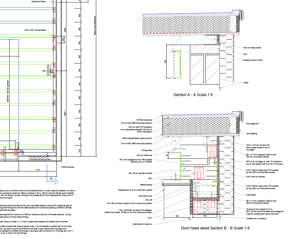

I wanted the detached garage to be well insulated, and I may well have got a bit carried away. I wanted to use Geocell Foamglass for the foundation topped off with a concrete slab. I then wanted single skin blockwork clad with external insulation that married up with the Foamglass so that the slab and block work where inside the thermal envelope. I also wanted a warm flat roof. On top of this the garage was to be trapezoidal in plan to make the most of our odd shaped plot and big enough at the front to take a 5m garage door and finally I wanted a thermal break at the door between the slab and the outside world
I contacted a local Structural Engineer who came round for a site visit. There more I spoke the more bewildered he looked. He'd never heard of Foamglass, not necessarily an issue but he didn't seem even vaguely interested in finding out more about it and its utilisation. I rapidly came to the conclusion that I couldn't work with him so I pondered my next move and decided to get in touch with a (well known on here) Structural Engineer/Architectural Designer who happens to live at the other end of the country. I wondered if he'd be able to help me out or steer me in the right direction.
It turned out that he could. More than that, he took on board all the odd things I wanted to do and worked with me brilliantly. He's an absolute mine of information and had lots of great input with which to finesse my design and he clearly knew what he was talking about which is so reassuring. A site visit wasn't necessary, I provided a site survey and soil survey from the house build and then photos and Google Earth filled in any blanks. I probably drove him nuts, every drawing he sent I added to my SketchUp design because I really wanted (needed) to understand how it was going to go together and didn't want the standard "the builder will know what to do".  There was a great deal of detail in the drawings:

Looks nice - Why so well insulated when you have 3m or so door that gets opened? Or are you planning to heat it and not open the huge door?
You also need to look at building regs for the ventilation required if it's anything like Scotland it's huge.
Can't see from the drawing do you have a secondary door, so you can get in if you have issues with roller door?

Good question, I got a bit carried away and it is over the top I guess but I wanted a warm dry garage.
No heating and the door does open and close as required to get stuff in and out.
The other night it was 3 degrees down here, the garage was at 18 degrees the day before and 17 degrees the following morning. It gains heat from a warm car getting put in there and/or charging up a hybrid car overnight.
No ventilation requirements, at least none that I could find and it’s been signed off by building control so I guess they weren’t aware of any either.
No, no secondary door or windows but the electric sectional door can be opened from inside or outside in the event of a power failure.

How exactly did you connect the EWi to the foamglass? It's a really novel approach to an insulated slab.
Thanks @Iceverge I’ll start another thread a bit later today regarding the Foamglass etc.
how have you done the ceiling around the roller shutter top box? assuming you have a ceiling.....
@gaz_moose  Yes, we have a ceiling.
The structural element for the door head is a ‘C’ section joist.
The door head itself is formed with plywood and the sectional (not roller) garage door is attached to that.

I had EPS up the side of the slab. It was steel framed with insulated steel composite panels. So the panels were screwed to the frame. The inner steel layer is inside the the envelop. The insulated parts sits on top of the EPS, and so the outer steel layer is outside. Yes, the securing screws are a thermal bridge, but thats inconsequential id suggest. So no thermal break in the envelope
But what about the entrance to the garage?
My slab is ‘thermally broken’ with a GRP box section and the easiest way that was going to work (in my head) was the foam glass route.
