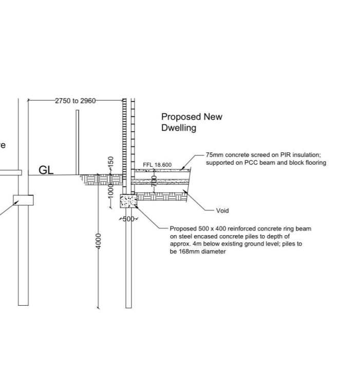

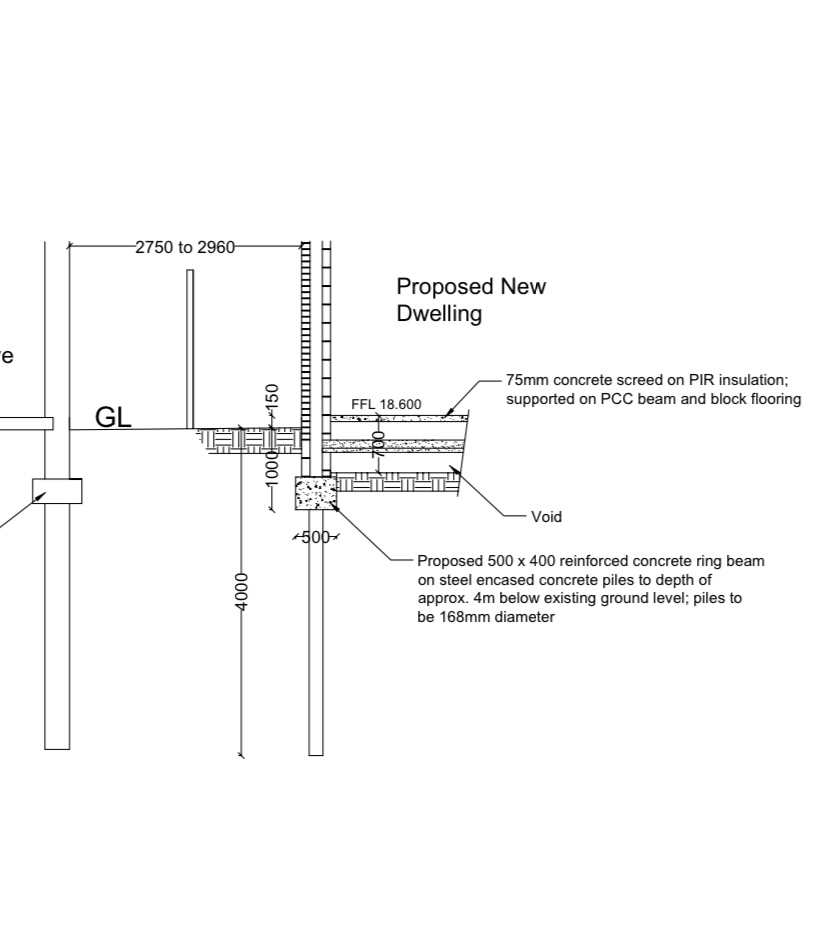

On 10/10/2024 at 22:54, Jodie said:
The piling has differed to that stated in the piling RAMS of a depth of 4-5 metres
That is a major deviation and that should have been recorded and signed off by the PW surveyor.

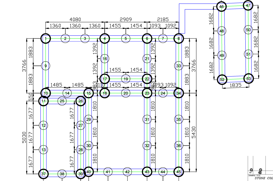

There are a total of thirty piles in a very small area.
This can give rise to general soil swell.. who decided to do this? What kind of piles were used? Do you know?

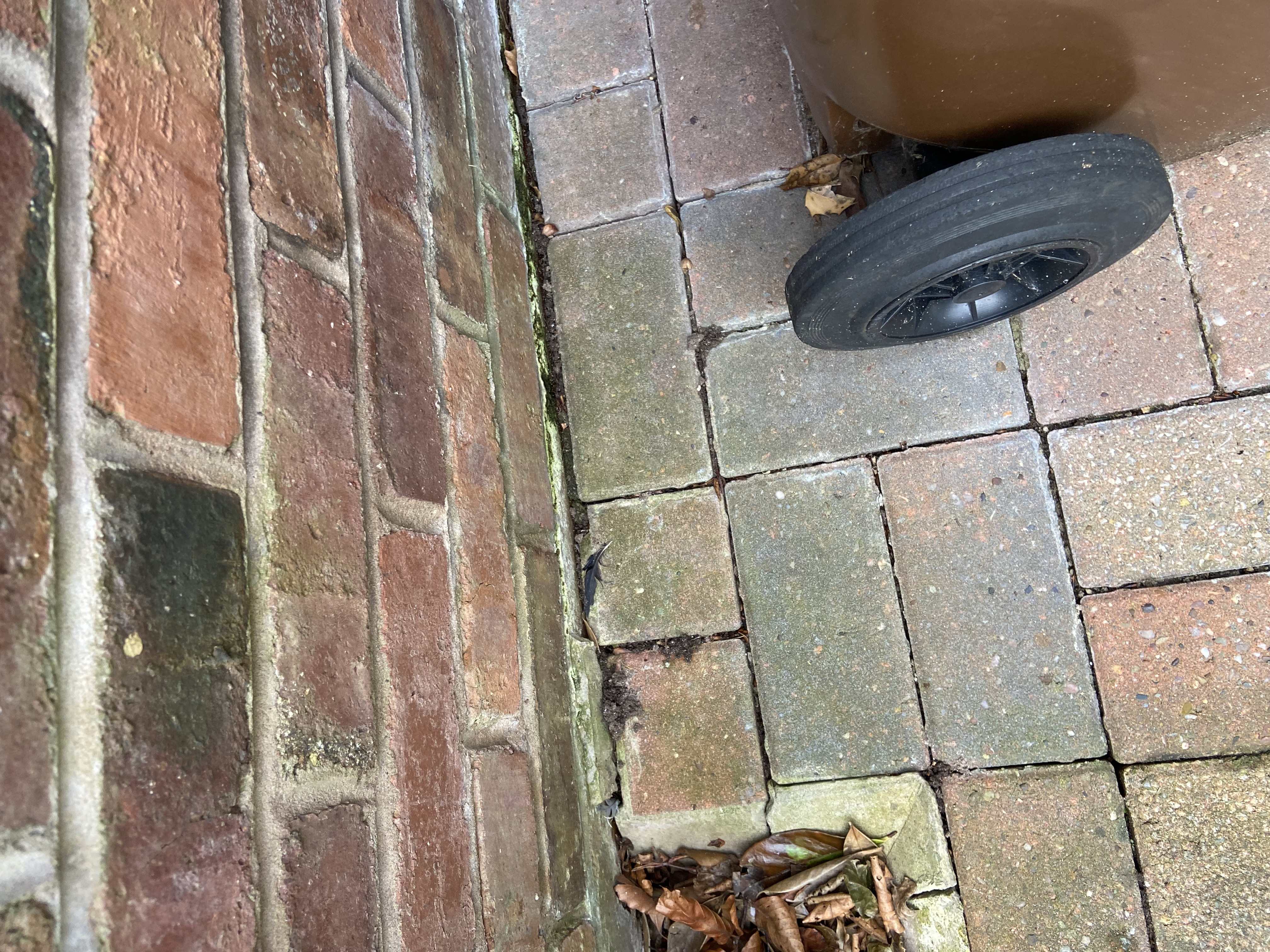

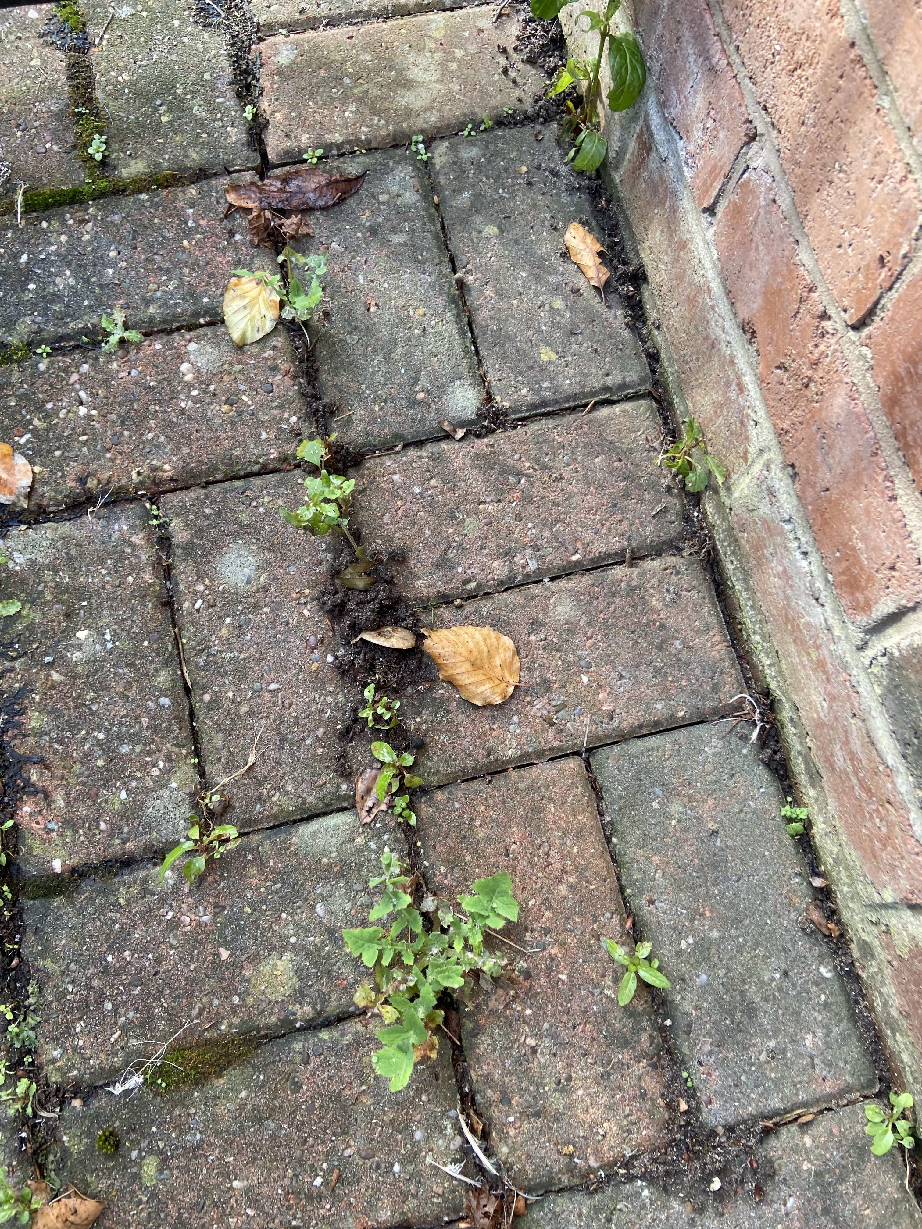

We have cracks around our window frames and soil deposits appearing in between the block paving path.
Do you have any record photos (dillapidations survey) of before the work started. The surveyor should have these if afforded access to your property. Did they ask to access your property and did you allow them to do so? If not they could be on a bit.. of a sticky wicket!

9 hours ago, Jodie said:
Some cracks have appeared around a couple of window frames and there is one on the wall of the stairs around 4 inches long but it is on a corner join. The cosmetic things are disappointing but it’s the long term damage to foundations that really concerns me.
You can now see evidence that the work next door may have caused damage to your house. All houses move about from winter to summer but you rightly identify what long term damage could result.
Get photo of this as we can then talk about soil liquifaction! It may be a clear winner for you but again it is a major undertaking to take on these folk. For this to occur then there must have been much more vibration than they are claiming?
