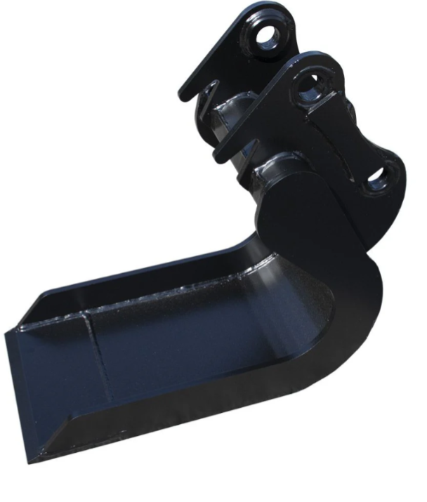

My God the clay can stick to a digger shovel. I had to buy (have made) a proper clay spade . It was little more than a simple hook (no sides) and the hook bit of it looked like a sieve.
Nope, I need a picture.
I'll try and find one.
I sold my digger with it's buckets to deserving couple of BuildHubbers a couple of years ago - and regretted it ever since...
This isn't the one, but it's close
