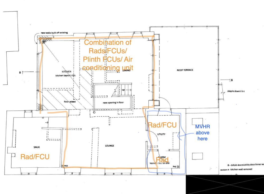

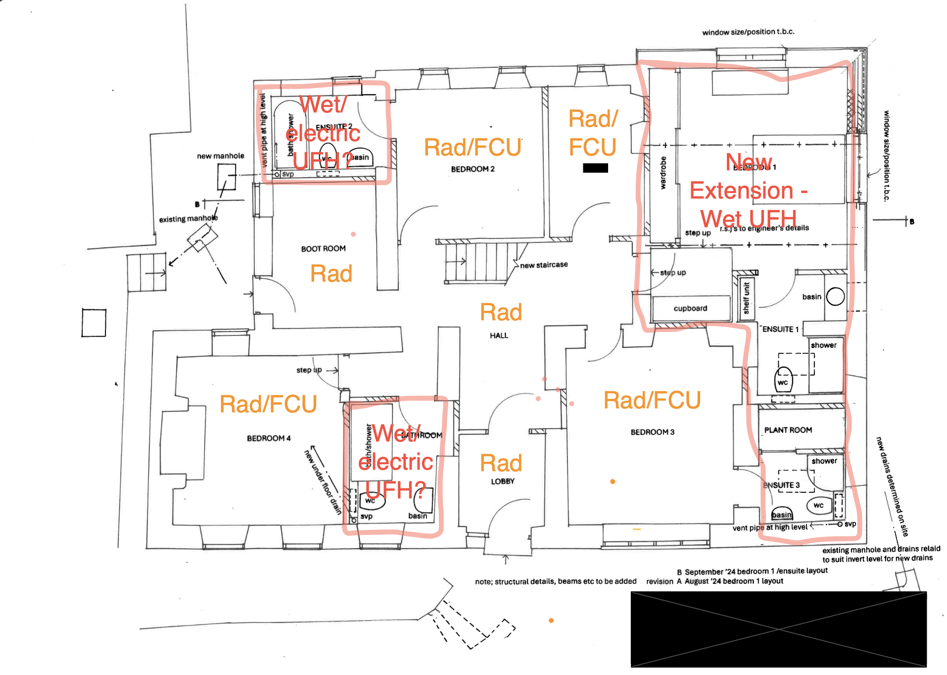

lookseehear Posted October 1, 2024 Share Posted October 1, 2024 Hi all, hoping for a nudge in the right direction. Our house was two 1800ish miners' cottages which were knocked together with limestone/rubble filled 500mm thick walls. It was extended in the 1970s to the rear with a block cavity wall, albeit only a 50mm cavity, and faced with limestone. The roof has poor/negligible insulation currently and the floors are mostly solid/uninsulated concrete. We put in a worcester bosch external oil boiler with an unvented cylinder about 3 years ago because the old boiler was 30+ years old and we couldn't keep it going any longer. The windows are mostly blown aluminium DGUs which are draughty, and in general it's a draughty house. When we put in the new boiler I also put in a Wiser heating control system with smart TRVs which has helped keep heating bills down because we only heat the rooms we need when we need them, but in general it's a cold house. We've just started an extensive extension/renovation which will result in some big changes. We're going 'upside down' with bedrooms downstairs and living space upstairs to take advantage of better views increase ceiling height and natural light with vaulted ceilings/roof lights and allow us to open up the living space more easily We'll replace all windows with new TGUs and all doors will be replaced We're replacing the roof, so will insulate to building regs (0.15 U value) We're having a new ground floor extension which will have our bedroom in, which we will put wet underfloor heating in as we'll be insulating floor, walls and ceiling to modern standards We're replacing kitchen and bathrooms I'm in a bit of a bind about what to do with the heating at the moment. My ideal solution would be an ASHP driving wet UFH throughout the downstairs, but this means we would need to dig out and replace the floors to add insulation. I'd like to use an air to air heat pump upstairs to heat the open plan living space, and also provide cooling in the summer. If we decide not to dig up the floors, that means putting rads in the other rooms downstairs or using an overlay wet UFH heating system, but if we're keeping radiators, maybe we also keep the boiler given it's only a few years old. I know that the improvements we're making will make a huge difference to the heating performance in the house, but I'm still unsure what the best option is, and what the second best might be if the best option proves too costly. Based on the estimates on the heatgeek website, a heat requirement of 50W/m2 would seem reasonable, which would mean we need roughly 5.5kw for downstairs and 4.5kw upstairs. Probably some kind of heat loss calculation would be helpful, but I'm not really sure where to go for this, or how accurate it would be given the renovations are evolving and not set in stone. Should we just keep it simple and stick with rads everywhere but in the new extension which is fully insulated? I'd rather not do this if possible, as we'd like to move to an ASHP and get rid of the boiler, and like the idea of UFH in bedrooms and bathrooms. Another option is to insulate the solid stone walls, and we had looked at EWI but decided against it for now due to the cost, change of appearance and apparent risks involved with getting it right. Literally any thoughts and opinions are valid here, other than about the layout, which we're very set on at this point. Link to comment Share on other sites More sharing options...

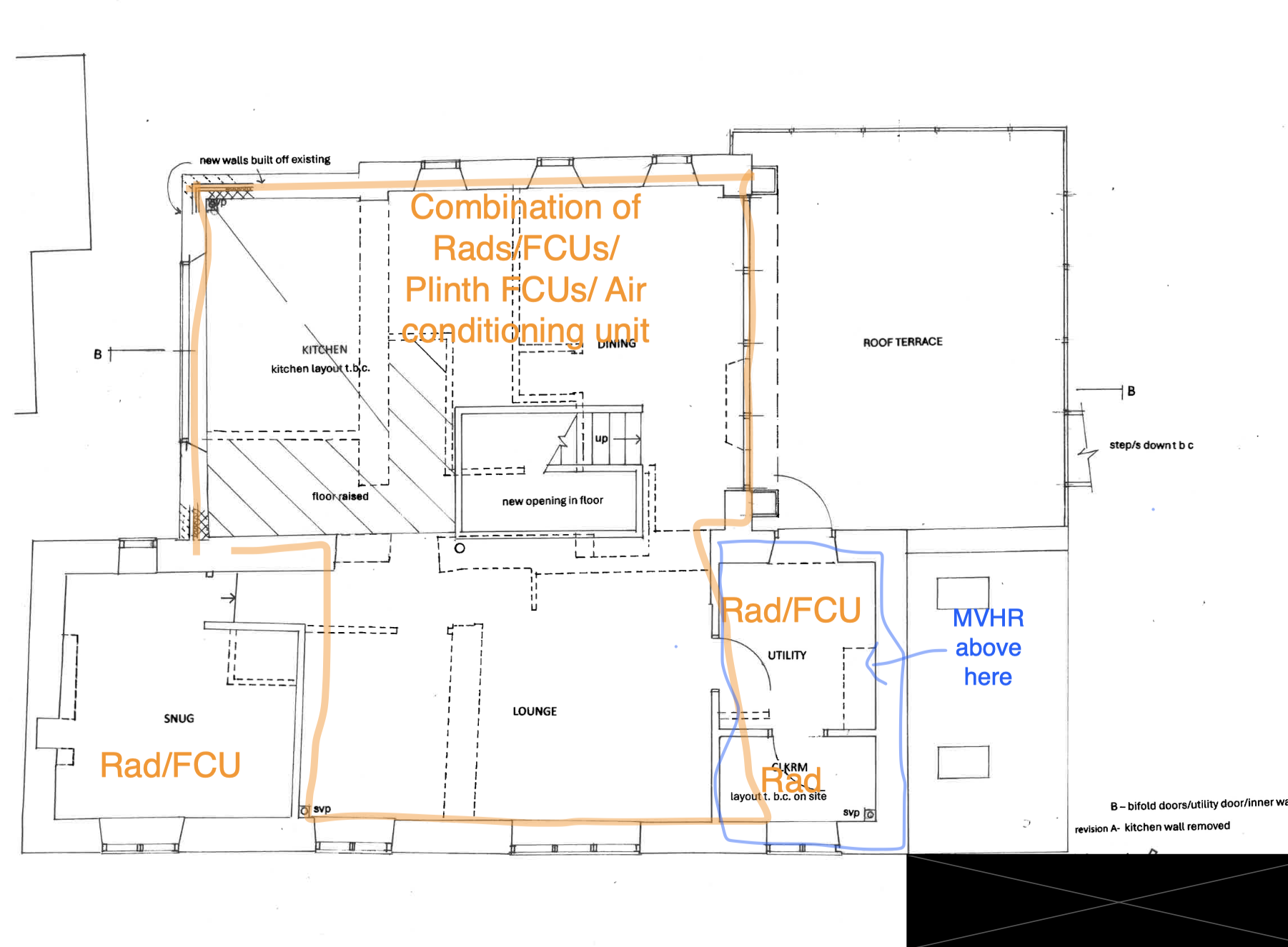

lookseehear Posted October 7, 2024 Author Share Posted October 7, 2024 (edited) Thank you all for the incredibly helpful replies! I've come up with a rough plan, which still needs some development, but I'm feeling optimistic about it. The Plan: Thermal Store for Heating and Hot Water I'm considering installing a large thermal store (around 400-500L) to handle both heating and DHW while keeping the existing oil boiler. Solar PV Integration We’ll be installing solar PV, but likely without a battery for now. Excess solar energy can be diverted to the thermal store for heating and DHW. Electricity and Oil Cost Comparison We're on an EV electricity tariff, which gives us cheap electricity at 8.5p/kWh from 00:30 to 05:30. Currently, oil costs about 60p/litre, which contains 10.2 kWh of energy per litre. However, with the boiler’s 85% efficiency, the cost of heating from oil is around 7.5p/kWh. So, we can use cheap electricity to 'charge up' the thermal store overnight at roughly the same cost as heating with oil. Of course, this may change with fluctuating oil and electricity prices. Heating in Bedrooms We plan to install large radiators or FCUs in the bedrooms and avoid UFH in areas without insulation. Main Living Space In the upstairs living area, we’re thinking of large radiators, and perhaps plinth FCUs in the kitchen to provide an extra heating boost if needed. Bedroom in New Extension For the new extension, we’ll install wet UFH. However, instead of embedding it in screed, we might use an overlay system on top of a well-insulated slab. This would allow the room to cool overnight and heat up quickly when needed, making the UFH act more like a radiator - any pros/cons here? Bathrooms We have two downstairs bathrooms (en-suite and main bathroom) in the older part of the house. I’d like to install UFH for extra comfort underfoot. With 100mm of PIR insulation and 50mm of screed, head height shouldn't be too compromised. A wet overlay system over 100mm PIR might be the best option here. Additional Insulation 1970s Extension: Considering using EPS beads in the 50mm cavity. External Insulation: I’m tempted to install 150mm of EPS around the foundation downstand (about 600mm deep) to reduce heat loss through the floors over time. This wouldn’t go around the entire property but could cover about 50%. Internal Wall Insulation (IWI): For the external rubble limestone walls, we might use wood fibre or hemp insulation between studs/battens with lime plaster on top. If we decide to excavate back to the stone inside, this could be a practical option but I'm open to others. Airtightness and MVHR I’m learning more about airtightness and plan to incorporate this along with an MVHR system. Instead of an ASHP, we’ll invest in the MVHR. Ducting should be fairly straightforward as the MVHR unit would sit in an insulated roof space, with easy access to the plant room. Questions I Still Have: Fan Coil Units (FCUs) Noise: How noisy are FCUs compared to radiators? My wife is particularly sensitive to noise, so this is a concern for us. Radiators vs. FCUs: Are there any downsides to using FCUs over radiators? When would you choose a radiator if an FCU is smaller, quicker to heat a room and runs at a lower flow temp (therefore more efficient)? Heat Stores Compatibility: Do thermal stores work well with radiators, FCUs, and wet UFH systems? My assumption is that the oil boiler could act as a fallback (e.g., if the store drops below 60°C), and the solar PV could power the immersion heater when we have excess electricity. Combined with using off-peak electricity I'd hope we can reduce our oil usage to the point that we could downsize from the 1200l tank we have currently in the garden. Flexibility: Am I right in thinking that with a heat store, it would be just as easy to put an UFH loop as an FCU or radiator, assuming there would be a small manifold required too? Controllers Ease of Use: Are there controllers that work well with a mix of UFH, radiators, and FCUs? Ideally, the system should be simple enough for my wife, who prefers not to deal with complex controls, even though she’s very capable. Any other feedback on this as the basis of a solution? Thanks in advance. I've attached some floor plans for reference. Edited October 7, 2024 by lookseehear Images Link to comment Share on other sites More sharing options...

lookseehear Posted October 8, 2024 Author Share Posted October 8, 2024 20 hours ago, Gone West said: @lookseehear It's amazing how similar our properties and heating solutions are. Ours started as a pair of 1840s sandstone and cob cottages. In the 1970s they were knocked into one and the cob first storey removed leaving a sandstone/rubble walled bungalow. This was then increased in size with a concrete block, cavity walled, extension. Currently heated with an old oil fired Aga, we will be updating to an external condensing oil boiler heating a thermal store connected directly to the radiator heated central heating. We already have PV and solar thermal to help heat the TS. It will use a plate heat exchanger for DHW. The cavity walls, 70mm, will have EPS beads CWI and the 600mm stone walls will have hempcrete type IWI. The cold loft will have 400mm insulation. Good luck with your project. I love this! I can have a look back through your posts to see if there's anything relevant, but I'd love to hear in particular why you decided on hempcrete vs another type of insulation for the solid walls. 15 minutes ago, sharpener said: We have a 270 litre custom TS from Newark Cylinders to time-shift so we can run the rads from night rate electricity. Working well so far. I assume you will be having one with a coil for the HW like the new Heat Geek cylinders? You will need a lot of solar PV to make much of a dent in a 400 litre tank! 1 kWh is only 860 litre-degrees. Glad to hear this system is working well for you. Maybe we don't need 400L, but I'd rather put in a larger heat store than a smaller one. It would be more efficient in terms of heat losses because of smaller surface area to volume/mass ratio, and I'd rather not be hitting the max temp from solar on a regular basis if I can store it instead, although arguably on sunnier days with more solar gain we'd be more likely to use the solar energy to power some kind of cooling system. In terms of the calcs - 1kWh = 860litre-degrees which means that it takes 1kWh to raise a 400l tank by 2.17 degrees. We have a good orientation for solar PV and no shading, so my guess is that we'd generate between 5 and 30 kWh/day between a shady December day and a sunny July day, which would raise the temperature of a 400l tank between 10 and 60 degrees. Not that bad I think! Link to comment Share on other sites More sharing options...
