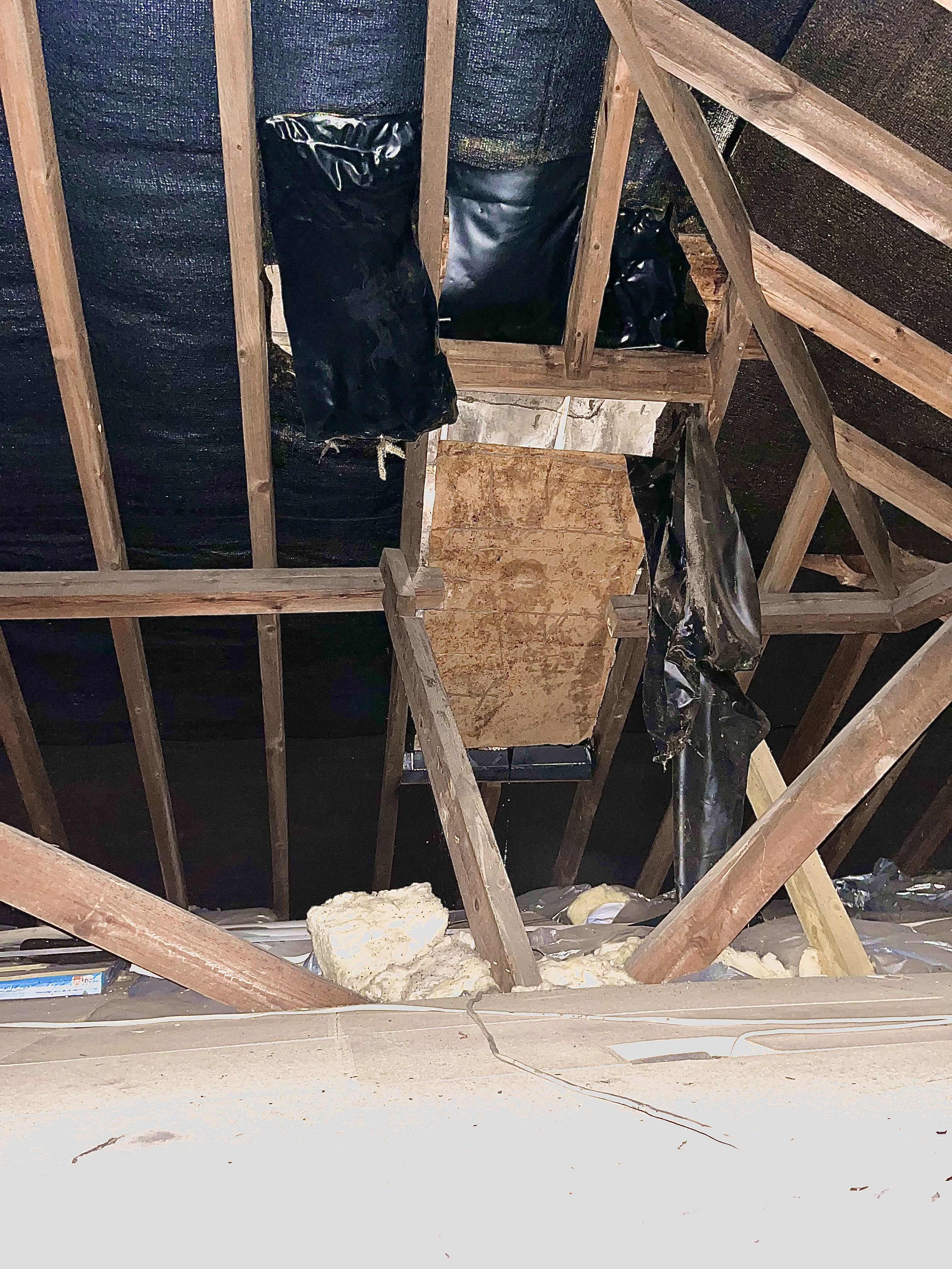

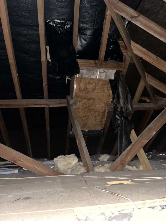

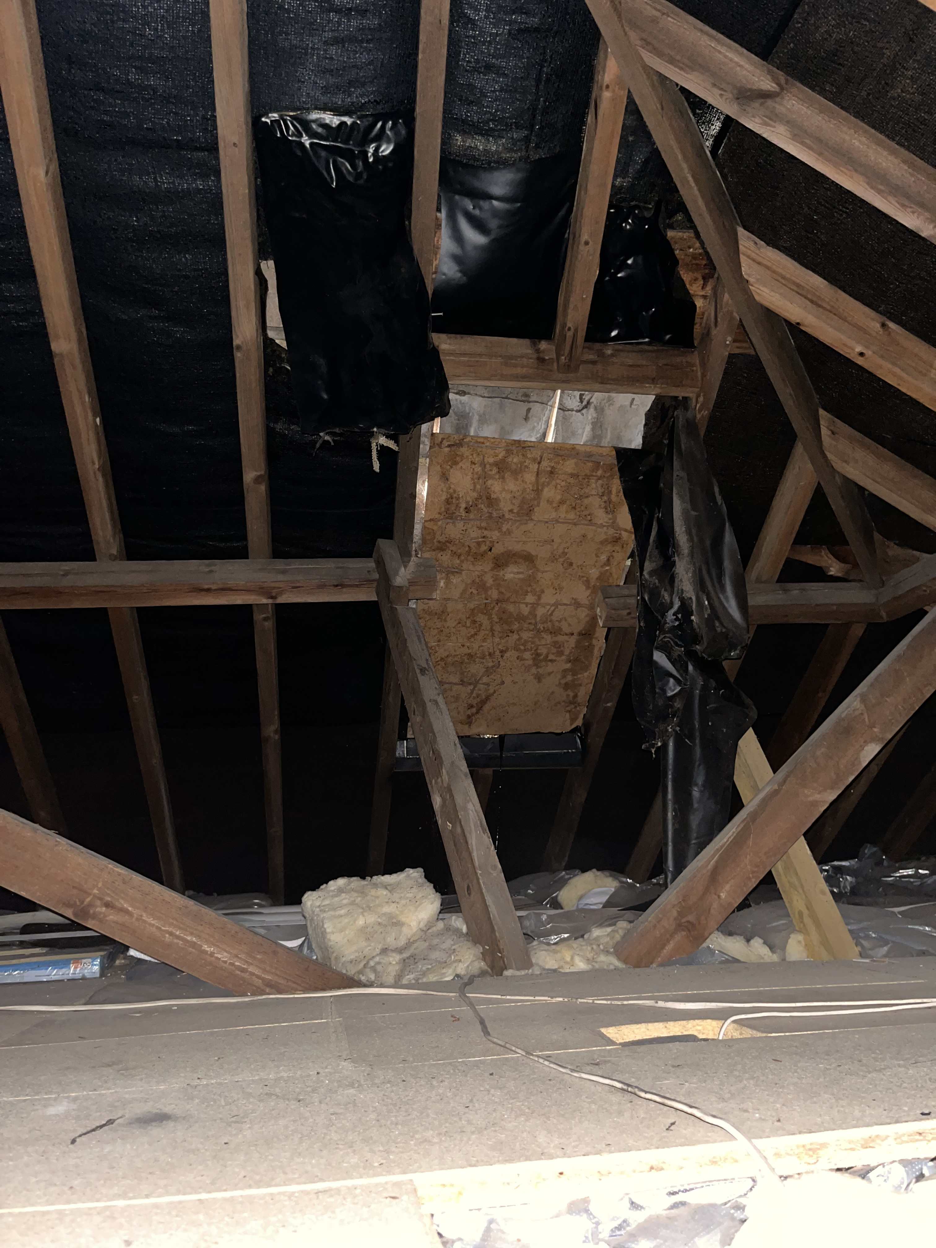

MarcS Posted September 29 Share Posted September 29 Hello, if anyone could shed some light on this, I’d be very grateful. I am in the process of buying a home and have had the offer accepted. However, on a second viewing, I was given access to the loft when I noticed light coming through the roof - after taking a picture it looks like the purlins have been cut to make way for a window which was never installed (or something else?). It seems it’s been braced with other wood but does anyone know if this would need fixing/likely cost or risk? Link to comment Share on other sites More sharing options...
joe90 Posted September 29 Share Posted September 29 That is easily fixable but the felt looks suspect and tiles missing? Try to knock them down on price, find a local builder/roofer to give you a quote. 1 Link to comment Share on other sites More sharing options...
MarcS Posted September 29 Author Share Posted September 29 10 minutes ago, joe90 said: That is easily fixable but the felt looks suspect and tiles missing? Try to knock them down on price, find a local builder/roofer to give you a quote. thanks, Joe - no tiles missing (all seem there when looking from the outside) but yes, the felt has been removed in that area and it’s been covered by a board but really have no idea what’s happened Link to comment Share on other sites More sharing options...
MarcS Posted September 29 Author Share Posted September 29 Link to comment Share on other sites More sharing options...
Mike Posted September 29 Share Posted September 29 It's not uncommon for purlins to be designed with struts and, from the colour of the timber, I'd not be too surprised if the strut on the left is original, with the one on the right being added when the purlin was cut. If so, and if the one the right is bearing onto something sensible, you wouldn't have a major problem and, as @joe90 says, it should be easy to fix. Link to comment Share on other sites More sharing options...
MarcS Posted September 30 Author Share Posted September 30 7 hours ago, Mike said: It's not uncommon for purlins to be designed with struts and, from the colour of the timber, I'd not be too surprised if the strut on the left is original, with the one on the right being added when the purlin was cut. If so, and if the one the right is bearing onto something sensible, you wouldn't have a major problem and, as @joe90 says, it should be easy to fix. thanks, Mike - that’s really helpful! Hopefully just a case of replacing the felt in that area maybe? If like you say the struts are structurally ok Link to comment Share on other sites More sharing options...
ProDave Posted September 30 Share Posted September 30 What does your survey say about it? Link to comment Share on other sites More sharing options...
MarcS Posted September 30 Author Share Posted September 30 8 minutes ago, ProDave said: What does your survey say about it? They haven’t seen it yet, have one booked in for next week so just wondered if anyone had any preliminary advice in the meantime Link to comment Share on other sites More sharing options...
ProDave Posted September 30 Share Posted September 30 As it is it is not structurally sound as a roof window opening. The surveyor should tell you what wants doing and give you an idea of how much to knock off the price to cover it. 1 Link to comment Share on other sites More sharing options...
Mr Punter Posted September 30 Share Posted September 30 Funny place to have a roof window unless it was going to be converted. If it was just for natural light they would have put a smaller rooflight between the rafters. Leaving it as a bodge was not great. 1 1 Link to comment Share on other sites More sharing options...
Iceverge Posted September 30 Share Posted September 30 Might there have been a chimney there at some stage that was taken down? If so it's possible it was providing some structural benefits. Whatever the case I wouldn't be overly worried about it if there's no sign of water ingress. However I would get up there with a few 2*4s, a bottle of glue, some clamps and a few screws to patch it up if it was in any way flimsy. If it is allowing in water however, allow maybe £5k to get that side of the roof sorted. 2 1 Link to comment Share on other sites More sharing options...
Gus Potter Posted September 30 Share Posted September 30 12 hours ago, MarcS said: They haven’t seen it yet, have one booked in for next week so just wondered if anyone had any preliminary advice in the meantime Mention to them and ask for their views. Link to comment Share on other sites More sharing options...
DannyT Posted October 1 Share Posted October 1 Definitely a chimney stack taken out. If the purlin had been cut they would at least be in line but they are not. One on the right is lower. Link to comment Share on other sites More sharing options...
Temp Posted October 2 Share Posted October 2 I agree it's most likely an old chimney. You can see remains of the flashing at the top. Link to comment Share on other sites More sharing options...
mjc55 Posted October 3 Share Posted October 3 Is there any evidence of chimney in the room below? Link to comment Share on other sites More sharing options...
