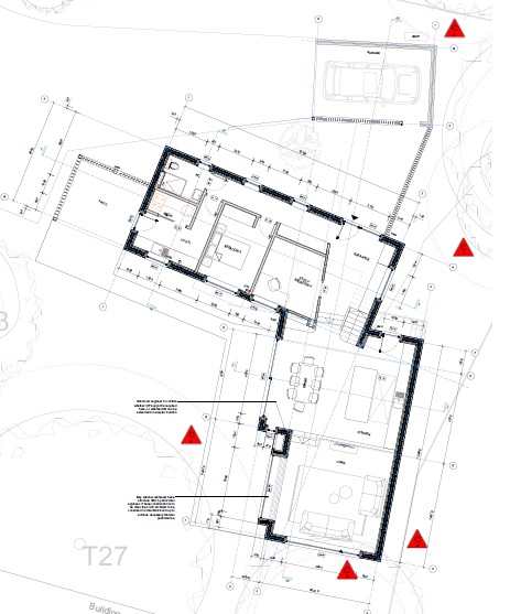

Mulberry View Posted September 25, 2024 Posted September 25, 2024 I'm thinking of having a go at building my internal walls, there aren't too many of them and I have time on my side. We have a hefty spec Block & Beam floor (175mm beams, all blocks in 215 orientation), with sleeper walls under the internal walls that run perpendicular to the beams and double or triple beams where they don't. The floor was designed for an imposed load of 1.5kN/m2 I'm thinking of Marmox Thermoblocks under all the blockwork walls, followed by Medium Dense Concrete blocks up to ceiling height. Doorways built to 905mm. Am I along the right lines?

Mulberry View Posted September 26, 2024 Author Posted September 26, 2024 24 minutes ago, Russell griffiths said: Rough opening for doors is too tight, you need to leave room to pack the lining and get it squared up. just think you can make a wall as soundproof as you want, but as soon as you put a door in it it becomes pointless. What would you suggest for door opening sizes? Also, we aren't decided on internal doors at all yet, do you think the opening size will allow later choice of pre-hung, shadow-gap and so on if we decide to go that way?
Mulberry View Posted September 26, 2024 Author Posted September 26, 2024 11 minutes ago, crispy_wafer said: build yourself a template for door openings, so you can block up to, and lintel over would be the one thing I took away from watching the brickie on mine (he had a few steel welded ones, but timber would work i'd think!) Seems like a decent suggestion. I have lots of timber laying around.
Russell griffiths Posted September 26, 2024 Posted September 26, 2024 45 minutes ago, Mulberry View said: What would you suggest for door opening sizes? Also, we aren't decided on internal doors at all yet, do you think the opening size will allow later choice of pre-hung, shadow-gap and so on if we decide to go that way? You need to work out what you want. as a minimum I would go. 838mm doors 30mm lining 2mm hinge gap 5-8mm packing. so 838 + 60 4 10 rough opening minimum 912mm.
Mulberry View Posted September 26, 2024 Author Posted September 26, 2024 25 minutes ago, Russell griffiths said: You need to work out what you want. as a minimum I would go. 838mm doors 30mm lining 2mm hinge gap 5-8mm packing. so 838 + 60 4 10 rough opening minimum 912mm. That makes sense, I allowed 55mm for a pair of linings as that's what carpenters seem to discuss. I'll shoot for 912mm.

DannyT Posted September 27, 2024 Posted September 27, 2024 22 hours ago, Russell griffiths said: You need to work out what you want. as a minimum I would go. 838mm doors 30mm lining 2mm hinge gap 5-8mm packing. so 838 + 60 4 10 rough opening minimum 912mm. At work we make the door openings 930mm to leave the Chippy happy. That’s for a 838mm door. lintels are dropped on at 2100mm above finish floor. Again to give plenty of room on the height. Any gap between lintel and door lining is packed with insulation before been plastered over. 2100mm will also leave the decision of going 2040mm or 1981mm until another day. As mentioned, knock up some dummy frames. 1 1
Mulberry View Posted September 27, 2024 Author Posted September 27, 2024 This has all been very helpful, thanks to everyone who has contributed. Just a couple of points I need to clear up... So, Medium-dense Concrete blocks for the ground floor walls are a good choice? How high to block up the ground floor walls in terms of the Posi floor above?
