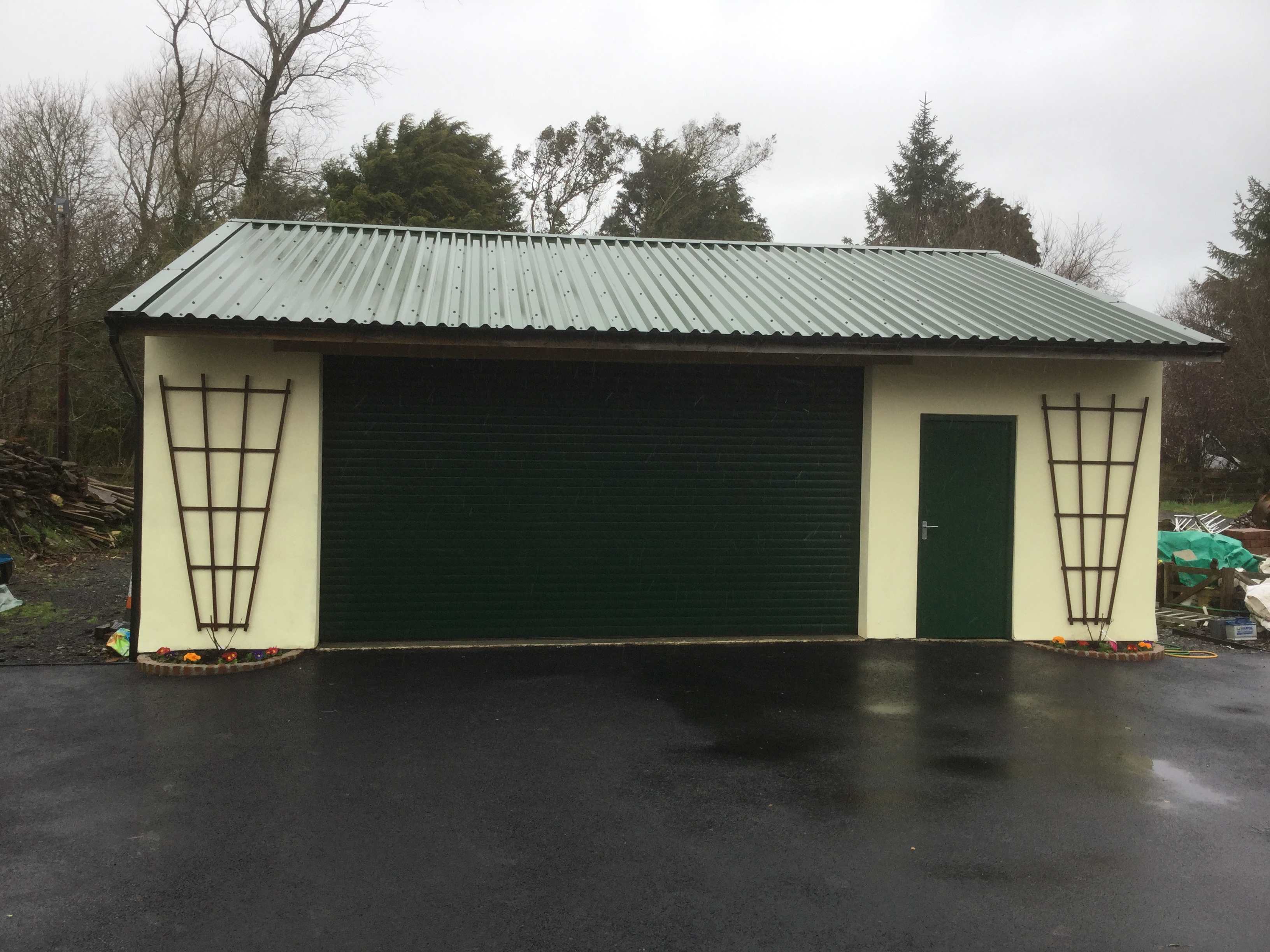

joe90 Posted September 22, 2024 Posted September 22, 2024 Yes I had a large (16ft) wide roller shutter door for them, very pleased with it and installed it myself with help from a friend.

joe90 Posted September 22, 2024 Posted September 22, 2024 (edited) On 22/09/2024 at 15:11, gaz_moose said: Mr joe90, did your door rattle in the wind? did it keep the draughts/weather out etc.. would you buy another one from them? as they seem well priced. Expand It only rattled in very high winds (it was very wide at 16ft) it did keep the weather out. Yes they require 300mm head height for the roller, if you don’t have this 300mm consider a sectional door that slides above the garage. Yes I would buy from them again, a part failed and a new part was sent straight away. Edited September 22, 2024 by joe90 1

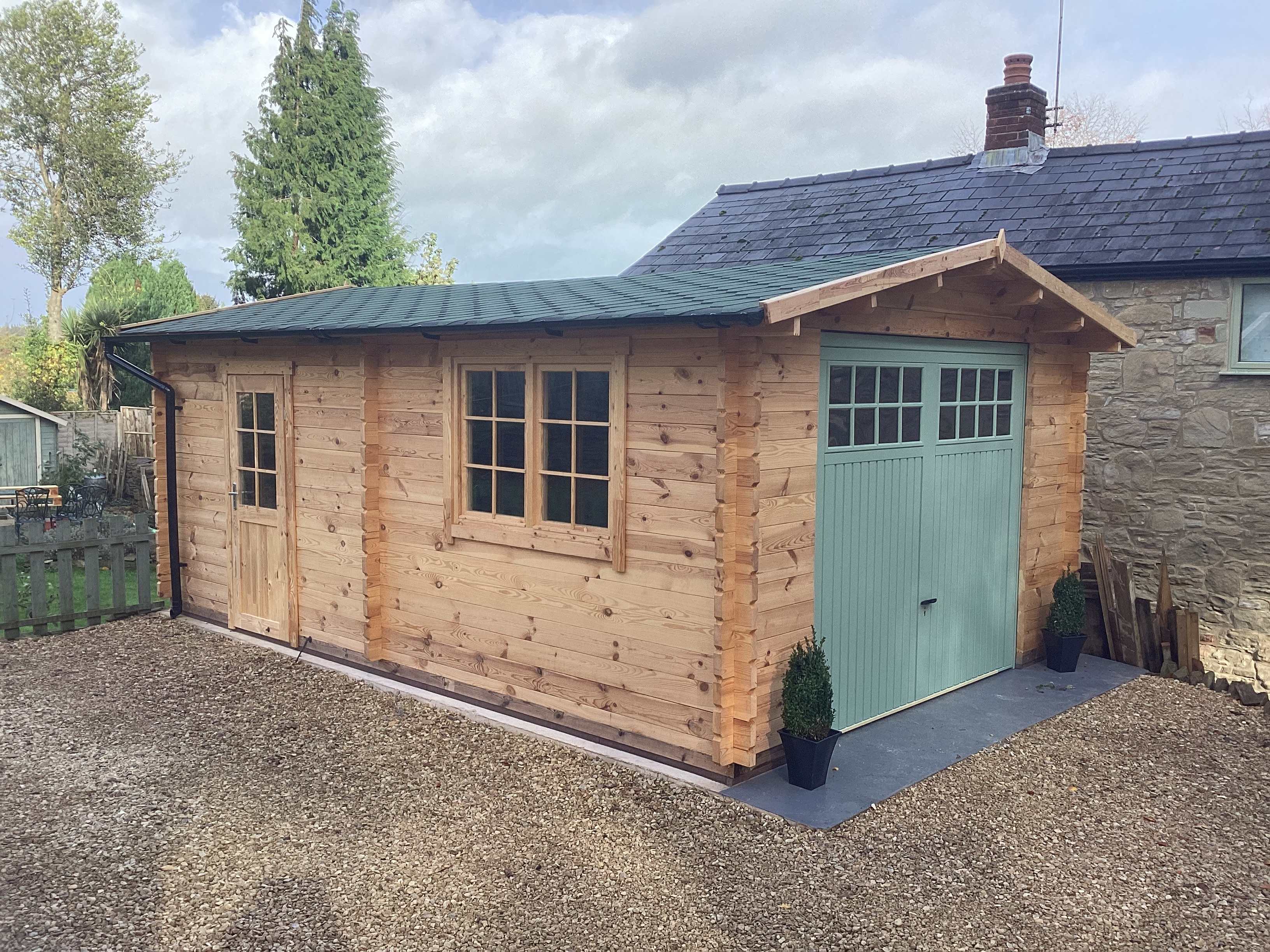

joe90 Posted September 22, 2024 Posted September 22, 2024 On 22/09/2024 at 18:11, saveasteading said: Be aware that there may be a gap above and around the spring allowing air and birds. A boxing may disguise the gap. Just check the detail. Expand My door above had no gap at all, rubber bump strip on the bottom formed a good seal and sides in a draft proof U section. With My recent single Garage I picked a period type up and over, I had to add a rubber strip on the bottom to make more airtight but no gaps otherwise, good mechanics and more in keeping with the garage type.

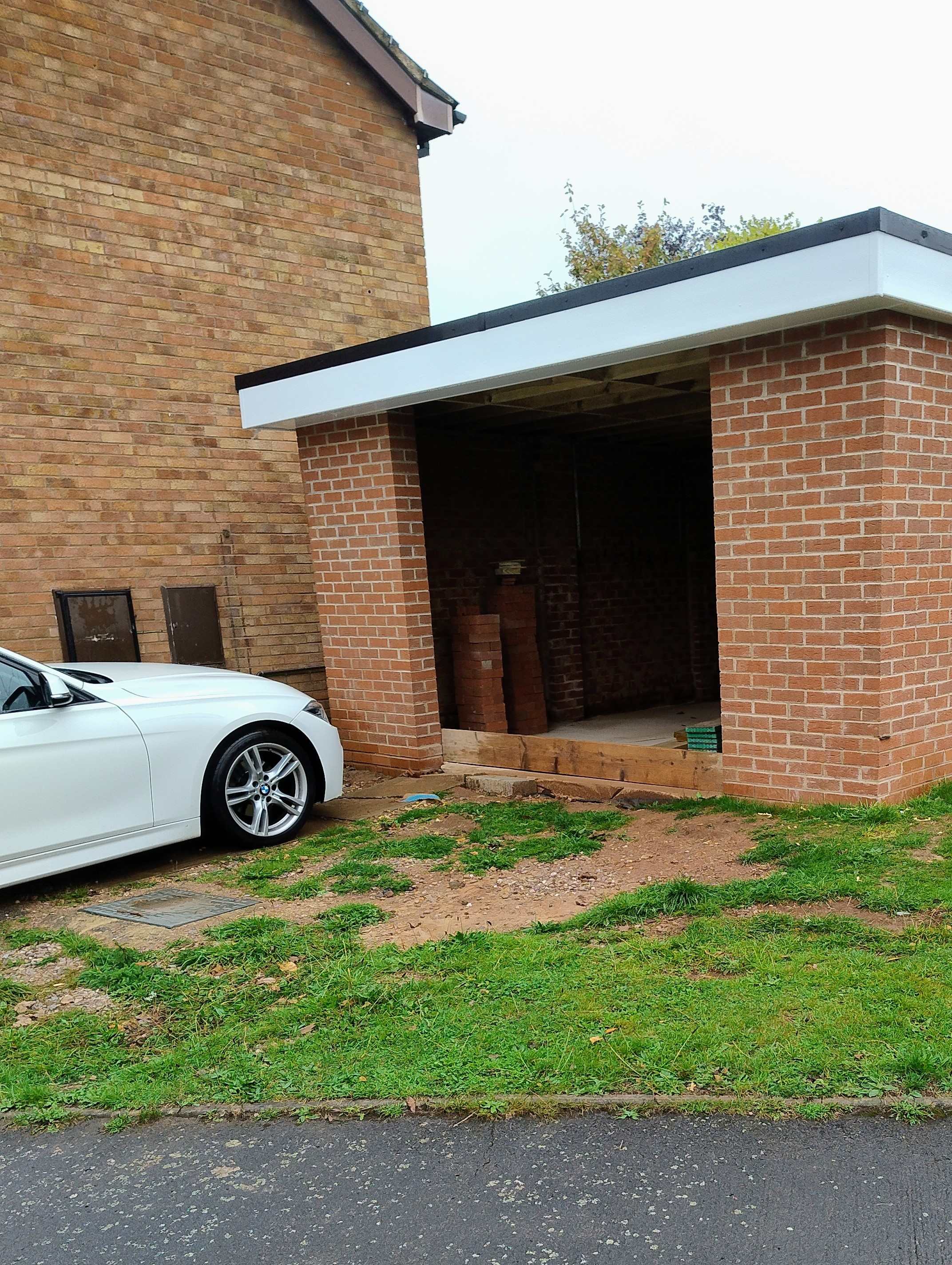

gaz_moose Posted September 23, 2024 Author Posted September 23, 2024 i drove over to a garage door showroom to have a nose around. i think I've decided on a sectional up and over as it would work best. a roller door requires space above the opening for the roller which i don't really have so i would have to lower to opening height and have a massive bit of upvc trim above the door. I'm a bit stuck on what i should put the height as, I did try to pump the ruff sales bird for how its done but she just wanted to send a salesman round 🙄 The roof slopes from right to left and the door is on the front so the brickwork on the right side is higher. i then just cut the bricks to match the angle for the front and back. the joists sit on a 45mm wall plate so i screwed a length of 45 to the bottom of the overhang noggins which gave me somewhere to fasten the soffit. i was going to mount the runners inside the brickwork and not on the back/inside of the pillars. so erm yea, is the height.. A. the lowest side joist B. the lowest side soffit C.

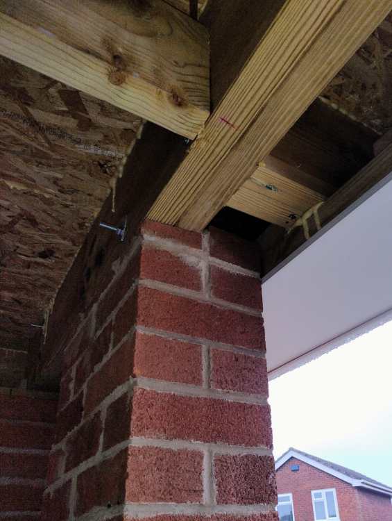

Roundtuit Posted September 24, 2024 Posted September 24, 2024 On 23/09/2024 at 19:25, gaz_moose said: The roof slopes from right to left and the door is on the front so the brickwork on the right side is higher. i then just cut the bricks to match the angle for the front and back. the joists sit on a 45mm wall plate so i screwed a length of 45 to the bottom of the overhang noggins which gave me somewhere to fasten the soffit. i was going to mount the runners inside the brickwork and not on the back/inside of the pillars. so erm yea, is the height.. A. the lowest side joist B. the lowest side soffit C. Expand Looks like you haven't made it easy for yourself 🙂 Traditionalists would have made a square opening I think. How about squaring off the height with some sort of lintel at around the same level as the soffit. That will give you a bit of space to play with. I'd run the tracks down the back of the door piers to maintain opening width and avoid damage.
joe90 Posted September 24, 2024 Posted September 24, 2024 Get the salesman round, he will measure up (his responsibility) and tell you the best way to deal with the slight slope of the roof ( tapered piece of wood making the doorway square 🤷♂️) 1

joe90 Posted September 24, 2024 Posted September 24, 2024 On 24/09/2024 at 17:49, TommoUK said: the roll itself takes up about 300mm of headroom. Expand But @gaz_moose says he does not have room for the 300mm 🤷♂️
TommoUK Posted September 24, 2024 Posted September 24, 2024 On 24/09/2024 at 17:52, joe90 said: But @gaz_moose says he does not have room for the 300mm 🤷♂️ Expand ...I guess you would see 100mm or so of the 300mm roll below the existing white fascia? You could hide this with a bit of timber frame and cladding that sits flush with the external brickwork?
joe90 Posted September 24, 2024 Posted September 24, 2024 On 24/09/2024 at 18:20, TommoUK said: ...I guess you would see 100mm or so of the 300mm roll below the existing white fascia? You could hide this with a bit of timber frame and cladding that sits flush with the external brickwork? Expand From the photo the bottom of the white facia is only about 30mm below the inside timber 🤷♂️
TommoUK Posted September 25, 2024 Posted September 25, 2024 On 24/09/2024 at 20:28, joe90 said: From the photo the bottom of the white facia is only about 30mm below the inside timber 🤷♂️ Expand Ah..I see the other pic. Still possible with fascia cladding to hide the roll but you'd have less than 2m when open so may not be practical

gaz_moose Posted September 26, 2024 Author Posted September 26, 2024 Sorry for the lack of reply's I've just been crazy busy. i was speaking to the guys at rollerdoor and because my door is wide i would have to go for the 300mm roller box and not the smaller 205mm one. i was doing some thinking and i have 260mm of depth in the joists/wall plate and my total door height at the lower side of the opening is 2350 from floor to bottom of joist so will probably cut my noggins out and put the roller box up into that space. If i go up into the joist space by 200mm then have 100mm which i can trim over in soffit to match, this will give me an opening height of 2250 which is still decent. 1
