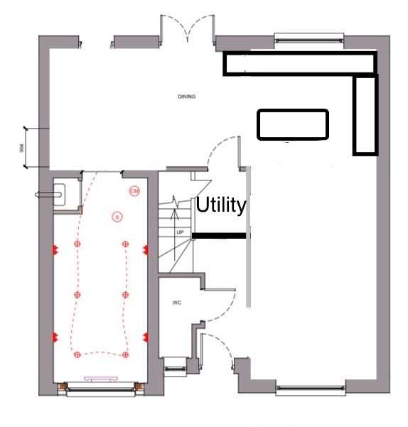

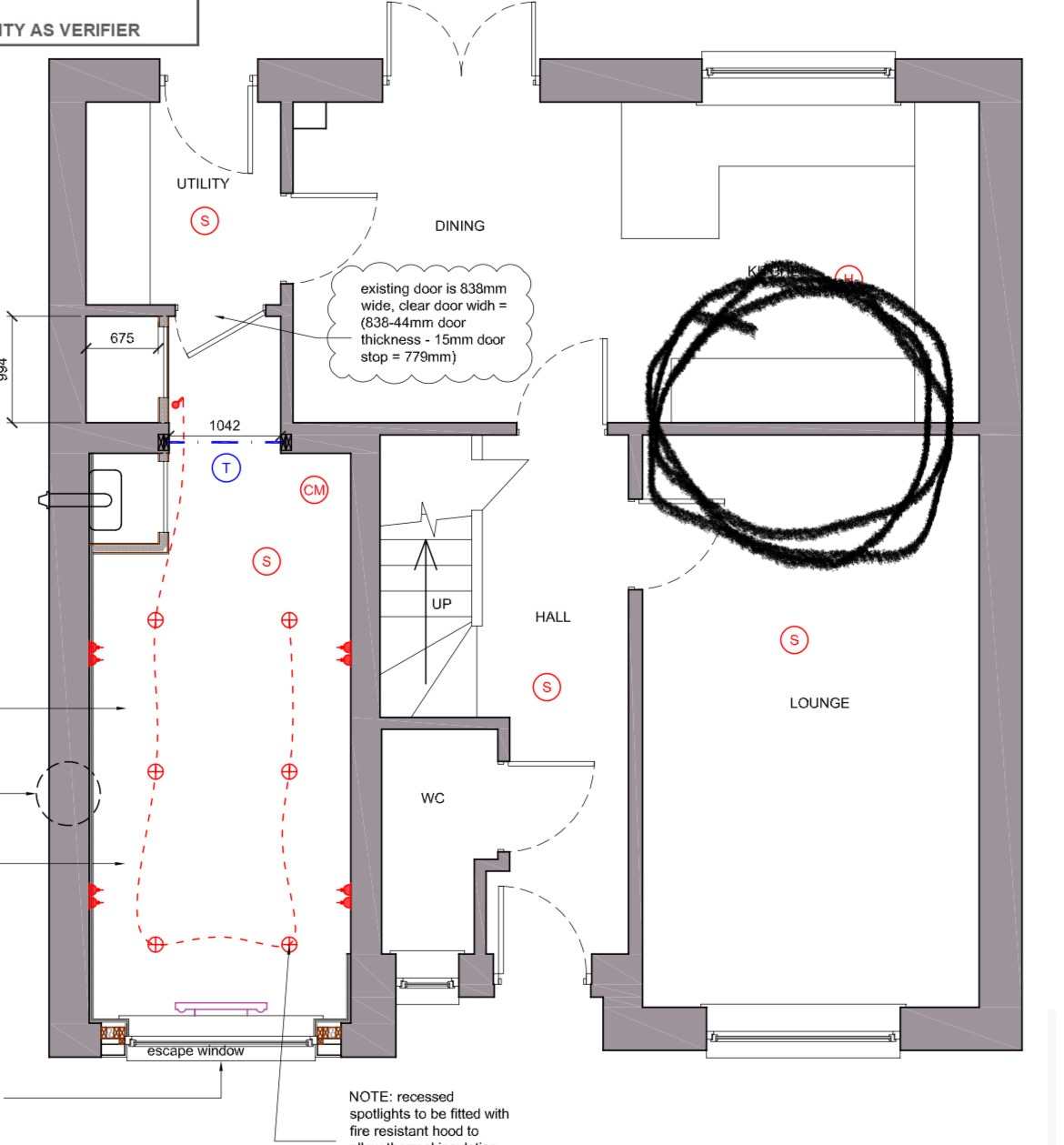

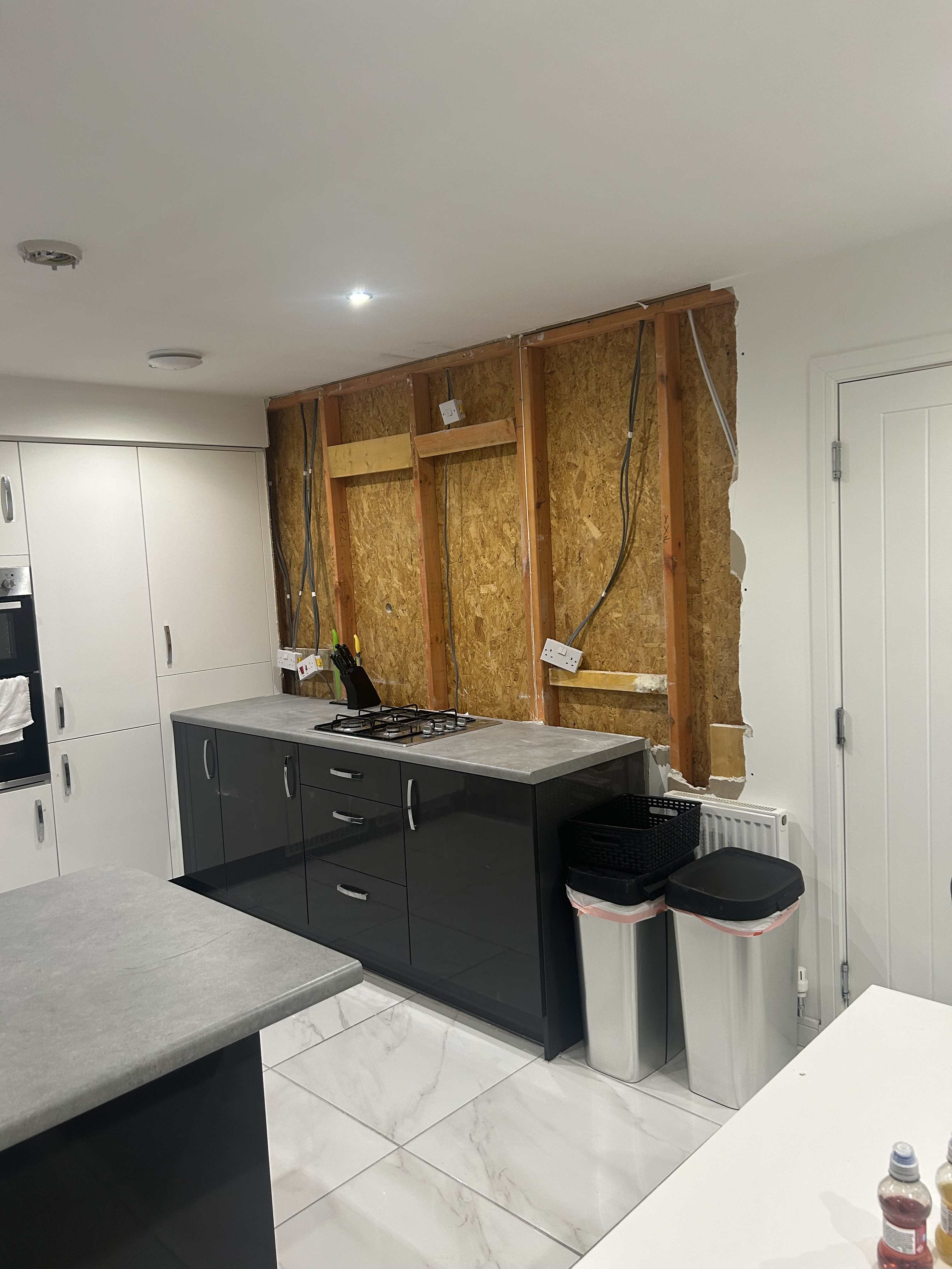

Jduncan Posted September 9, 2024 Share Posted September 9, 2024 Hi all, We are currently trying to give our downstairs a more open feel so are moving doorways and taking down a wall or 2. I’ve attached the plan we are aiming to achieve. While removing plasterboard between the kitchen and livingroom noticed some OSB in the wall. I thought it was just behind the hob section but it’s across the whole all. I’ve stripped back where we want the opening - from the kitchen units to half way through the radiator (where it meets the hallway wall). The house is new build 5 years old. Doing some quick research it seems that this wall is load baring and I’ll need to get a structural Engineer and get a beam placed? The opening is 2m While we wait on the structural engineer etc I’m assuming it’s ok to remove the OSB as long as the stud work remains until we can replace it with a recommended beam? Link to comment Share on other sites More sharing options...
Dave Jones Posted September 9, 2024 Share Posted September 9, 2024 doesnt look structural at 900 centres and no double studs, no noggins etc. is it a legoland house ? whats above it, what is sitting on top of the top plate can you post a close up Link to comment Share on other sites More sharing options...
Jduncan Posted September 9, 2024 Author Share Posted September 9, 2024 I thought the OSB took away the need for noggins? I’ll open it up this morning and post a picture. Going to double check what way the joists run for the first floor Link to comment Share on other sites More sharing options...

ProDave Posted September 9, 2024 Share Posted September 9, 2024 Is the house detached or joined? The OSB cladding could be because the wall is rated as a racking wall, to resist wind pressure on the side wall (assuming it is detached) Link to comment Share on other sites More sharing options...
Jduncan Posted September 9, 2024 Author Share Posted September 9, 2024 Detached house Link to comment Share on other sites More sharing options...
ProDave Posted September 9, 2024 Share Posted September 9, 2024 Another thought. Joist directions (and this is speculation) I would expect the joists above the living room to span side to side of the house as that is the shorter span. But the joists above the kitchen / diner would be a long span doing that, so could that wall you are wanting to alter be supporting those joists and they are running front to back? I would start by dropping the downlighters in the kitchen and having a look to see if you can determine joist direction in the kitchen / diner area. 1 Link to comment Share on other sites More sharing options...
saveasteading Posted September 9, 2024 Share Posted September 9, 2024 Im guessing a bit here. The wall is not supporting floors or an upper wall, or the studs would be closer together. But it is an important racking (anti domino effect) wall, hence the osb and should not be removed. Needs a proper assessment by an SE. Because other people have done it, doesn't make it ok. This really could fall down. Was this built as part of a big development? 1 Link to comment Share on other sites More sharing options...
Jduncan Posted September 9, 2024 Author Share Posted September 9, 2024 Yeah going to have a feel up at the downlights just now. Contacted a couple local structural engineers so hopefully hear back this week. Yeah my thought process is the OSB is there for a reason so must be serving a purpose. it is a part of a bigger development. My house type has 2 floor and 3 floor option. We are in a 3 floor - which might be why we have the OSB in place Link to comment Share on other sites More sharing options...
saveasteading Posted September 9, 2024 Share Posted September 9, 2024 29 minutes ago, Jduncan said: part of a bigger development Was there a manual with the house? There should be, and advising what the walls are doing..... I've only seen one such and it was junk.... no useful info at all. Link to comment Share on other sites More sharing options...
saveasteading Posted September 9, 2024 Share Posted September 9, 2024 38 minutes ago, Jduncan said: part of a bigger development The reason I asked is: if this was a mass produced timber frame, then it is very unlikely the wall was built incorrectly. I think 900 cc is very unusual and with osb being 1200 wide the boards would be horizontal. Link to comment Share on other sites More sharing options...
ProDave Posted September 9, 2024 Share Posted September 9, 2024 I have never seen a stud wall built at 900mm spacing. That is extreme penny pinching and makes life awkward for the trades as already mentioned. What plasterboard was on that wall? Standard 12.5mm is surely not intended for a 900mm span is it? Link to comment Share on other sites More sharing options...
ProDave Posted September 9, 2024 Share Posted September 9, 2024 P.S I don't like your proposed new layout, it would force the living room into being a through route corridor and be tedious to keep going round through that to get to the stairs. It flows much better as it is. Utility is best left where it is as far from the living room as possible. You don't want a washing machine that close unless you don't mind noise. From my point of view it would devalue the house and make it less appealing to me, but others may differ. Link to comment Share on other sites More sharing options...
kandgmitchell Posted September 9, 2024 Share Posted September 9, 2024 11 hours ago, Jduncan said: It’s a 3 story plan. The garage conversion has already been done. All doors are fire rated. The doors are fire rated for a reason - they protect the means of escape in case of fire, down the stairs and out the front door. The proposed layout negates this with any fire in the lounge/kitchen making the stairs unusable. Those on the first floor may have access to escape windows but those on the second would have no way out. It'll contravene the Building Regulations and be too much of a risk. At least retain the separation between the lounge and the hallway to protect the escape route. Link to comment Share on other sites More sharing options...
Mike Posted September 9, 2024 Share Posted September 9, 2024 (edited) 10 hours ago, saveasteading said: But it is an important racking (anti domino effect) wall, hence the osb and should not be removed. Needs a proper assessment by an SE. This really could fall down. +1. If it is a structural wall, you will also need Building Regulations approval. 8 hours ago, ProDave said: I don't like your proposed new layout, it would force the living room into being a through route corridor and be tedious to keep going round through that to get to the stairs. It flows much better as it is. Another +1. It will also make the staircase feel enclosed, it's not good to have to walk through a kitchen to get to another room and there doesn't look much space for the kitchen island. As a minimum, more the kitchen to the garage side of the new room. 52 minutes ago, kandgmitchell said: The doors are fire rated for a reason...It'll contravene the Building Regulations and be too much of a risk. At least retain the separation between the lounge and the hallway to protect the escape route. +1. If do you open it up then you'll need to install a fire suppression system to comply with Building Regulations. Edited September 9, 2024 by Mike Link to comment Share on other sites More sharing options...
Jduncan Posted September 9, 2024 Author Share Posted September 9, 2024 2 hours ago, kandgmitchell said: The doors are fire rated for a reason - they protect the means of escape in case of fire, down the stairs and out the front door. The proposed layout negates this with any fire in the lounge/kitchen making the stairs unusable. Those on the first floor may have access to escape windows but those on the second would have no way out. It'll contravene the Building Regulations and be too much of a risk. At least retain the separation between the lounge and the hallway to protect the escape route. sorry poor drawing on the plan. There is a door from the hallway to the livingroom. I get the points about going through rooms etc. the garage conversion is currently our play room. So we need to go through the utility room to get into it. Without ripping out the relocating the WC this is the only way. I feel the livingroom, kitchen, playroom flows a lot nicer than Kitchen, utility, playroom. Got a structural engineer coming out this week and had a family friend come in who’s done similar work who’s said it will probably need steel goalposts. Link to comment Share on other sites More sharing options...
saveasteading Posted September 10, 2024 Share Posted September 10, 2024 A worrying thought. That stud wall would need 2 more studs to be at 600cc. An extra £6. And it should have noggins. I don't think a designer or the developer decided that. Was this subbed to a little builder who put 4 studs in the wall and 2 in the van? How often do I see someone on Facebook selling a pile of stud? Why do they have it? Where did it come from? Link to comment Share on other sites More sharing options...
Jduncan Posted September 10, 2024 Author Share Posted September 10, 2024 The stud wall was put in by the builder. Just measured and they are 550 apart. Don’t know where the 900 chat is coming from. the OSB defeats the need for noggins? But even so they are present. Just below the kitchen unit height Link to comment Share on other sites More sharing options...
FuerteStu Posted September 10, 2024 Share Posted September 10, 2024 6 minutes ago, Jduncan said: the OSB defeats the need for noggins? But even so they are present. Just below the kitchen unit height Looks like they were not there as part of the wall, but for making a good fixing for cabinets and sockets etc Link to comment Share on other sites More sharing options...
Jduncan Posted September 10, 2024 Author Share Posted September 10, 2024 5 hours ago, FuerteStu said: Looks like they were not there as part of the wall, but for making a good fixing for cabinets and sockets etc no it’s rack panels. If it was for cabinets it would have been the other side Link to comment Share on other sites More sharing options...
Mr Punter Posted September 10, 2024 Share Posted September 10, 2024 Standard timber frame kit is studs at 600 centres and no noggins. Top and bottom rail plus connecting plate at the top. The noggins in the pic are for wall or tall units. OSB is for racking and strength. Amazing how a sheet of 9mm OSB stiffens a wall. Link to comment Share on other sites More sharing options...
saveasteading Posted September 10, 2024 Share Posted September 10, 2024 12 minutes ago, Mr Punter said: Amazing how a sheet of 9mm OSB stiffens a wall. As discussed elsewhere I've recently been knocking up such a wall. What I found was that the osb is very fragile at the perimeter, where a squint screw or a little twist will break it. But on the central stud they fix snugly, as they do on noggins and any other non perimeter surface. Then it is stiff and think the perimeter ones work well enough in shear. 6 hours ago, Jduncan said: Don’t know where the 900 chat is coming from. Glad it's all ok. It's the danger of misinterpreting a photo. There are a few options to keep the house standing. Will you keep us informed? Link to comment Share on other sites More sharing options...
