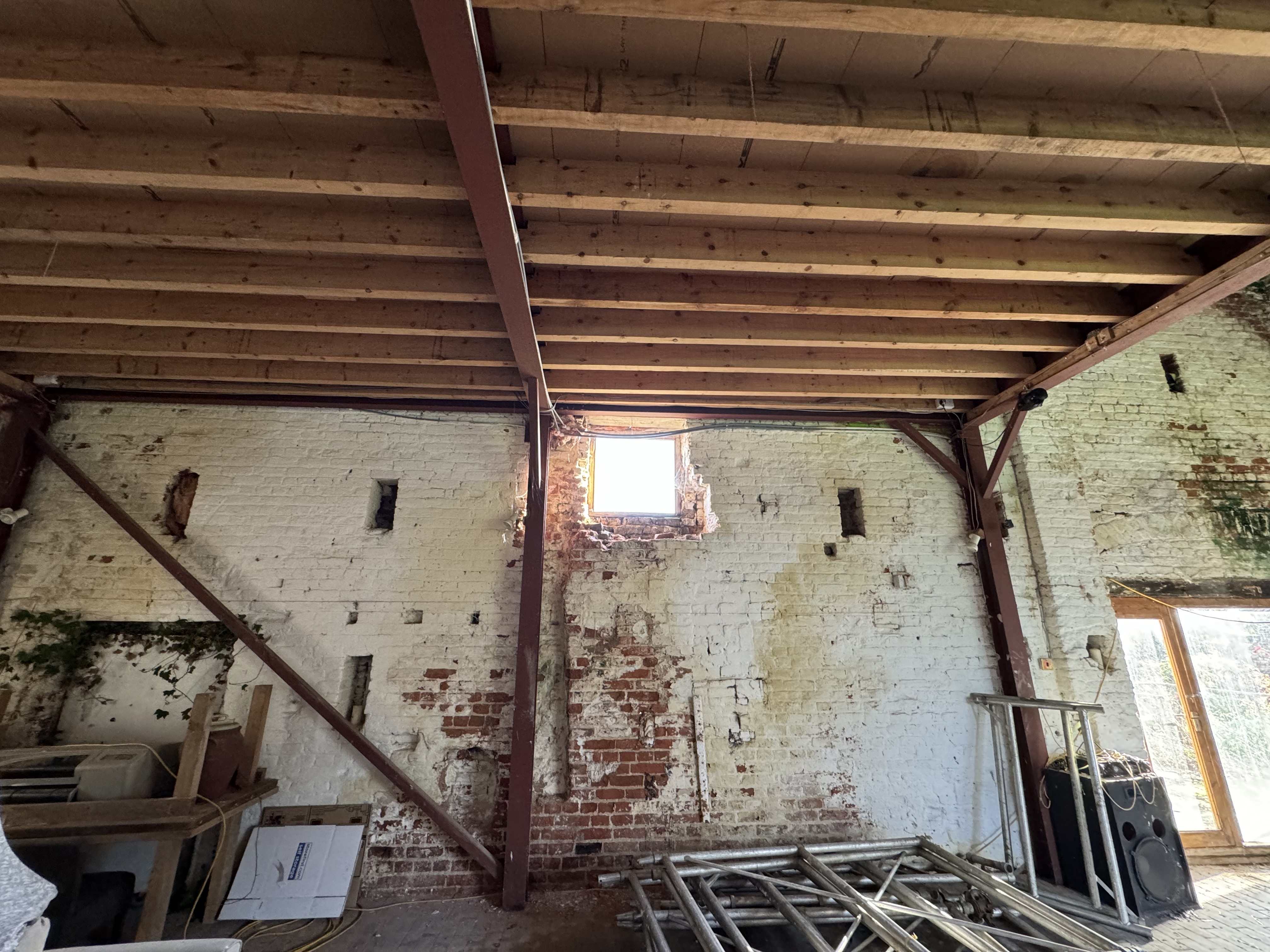

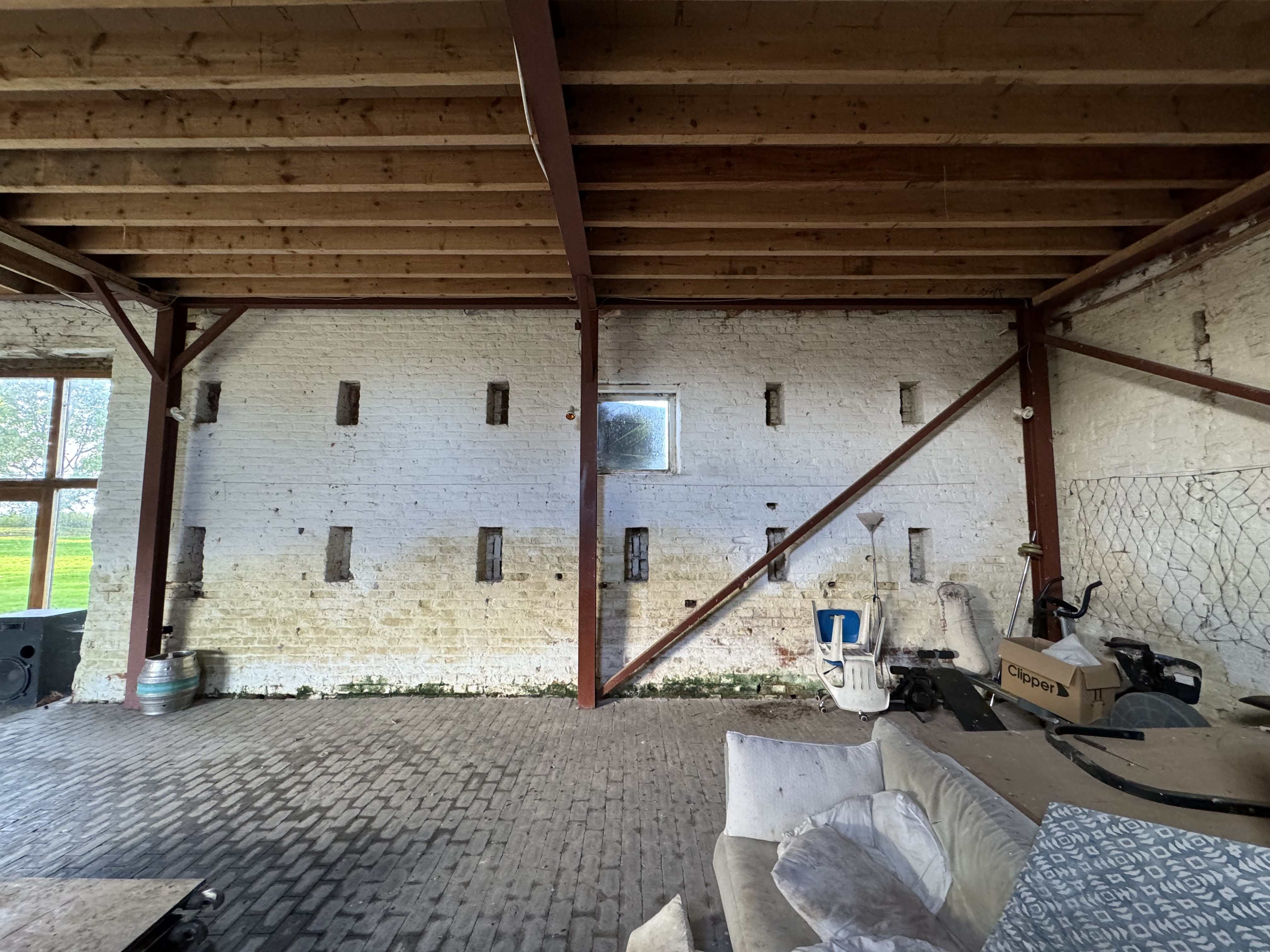

November 16, 20241 yr @Annker I am planning a barn conversion with IWI. I think we are considering similar strategies. Architects preference was for natural breathing solution but my preference was for a more commercial bag it up and stop it moving solution. In the most extreme case the external walls deviate 200mm from plumb…. We have an internal steel frame and are looking at currently looking at a minimum 50mm ventilated cavity, treated timber stud with PIR infill between. Likely 120mm. VCL to the inside face counterbatten and then PIR backed board to the front which will also be used to cloak the steel frame (potentially with and addition 25mm board to further limit cold bridging). Window openings will have VCL dressed through to the frame and the PIR bonded board will form the reveal which will vary I depth but be a minimum of 350mm deep. I’m considering the use of a breather on the outside face of the stud to protect the timber better but I think it might be unnecessary and make buildability challenging. Currently planning erecting stud frames at ground level and offering up for fixing to steel. If I were in your position, and wanting square wall I’d batten up at fixed centres and plumb with packers before affixing the next product. IMHO VCL could then be either to front or rear of PIR and dare I say it if you’re just driving improvement but without a specific figure you could just use foil faced PIR and tape with alutape… that’s the rougher side of me. Compromised VCL is almost always inevitable and I take one of two approaches I see as being practical and pragmatic. Either tape VCL to timber battens using some butyl tape strips then PIR backed PB could be directly affixed with the butyl tape “self healing) the fixing point OR (and this is how I always approach it) sandwich the VCL between two sheet products. In this case PIR and PB. The “trapped” nature of the fixing point and sandwiching between two impermeable products means leakage is minimal. The first option is a belt and braces version of the latter. Also might be worth considering a gypliner system… these can form a void of 30mm if I recall. Quick, easy, cheap and maintains a continuous cavity… https://www.british-gypsum.com/Systems/wall-linings/gyplyner-single#description Other variants exist Edited November 16, 20241 yr by BadgerBodger Addition of gypliner
