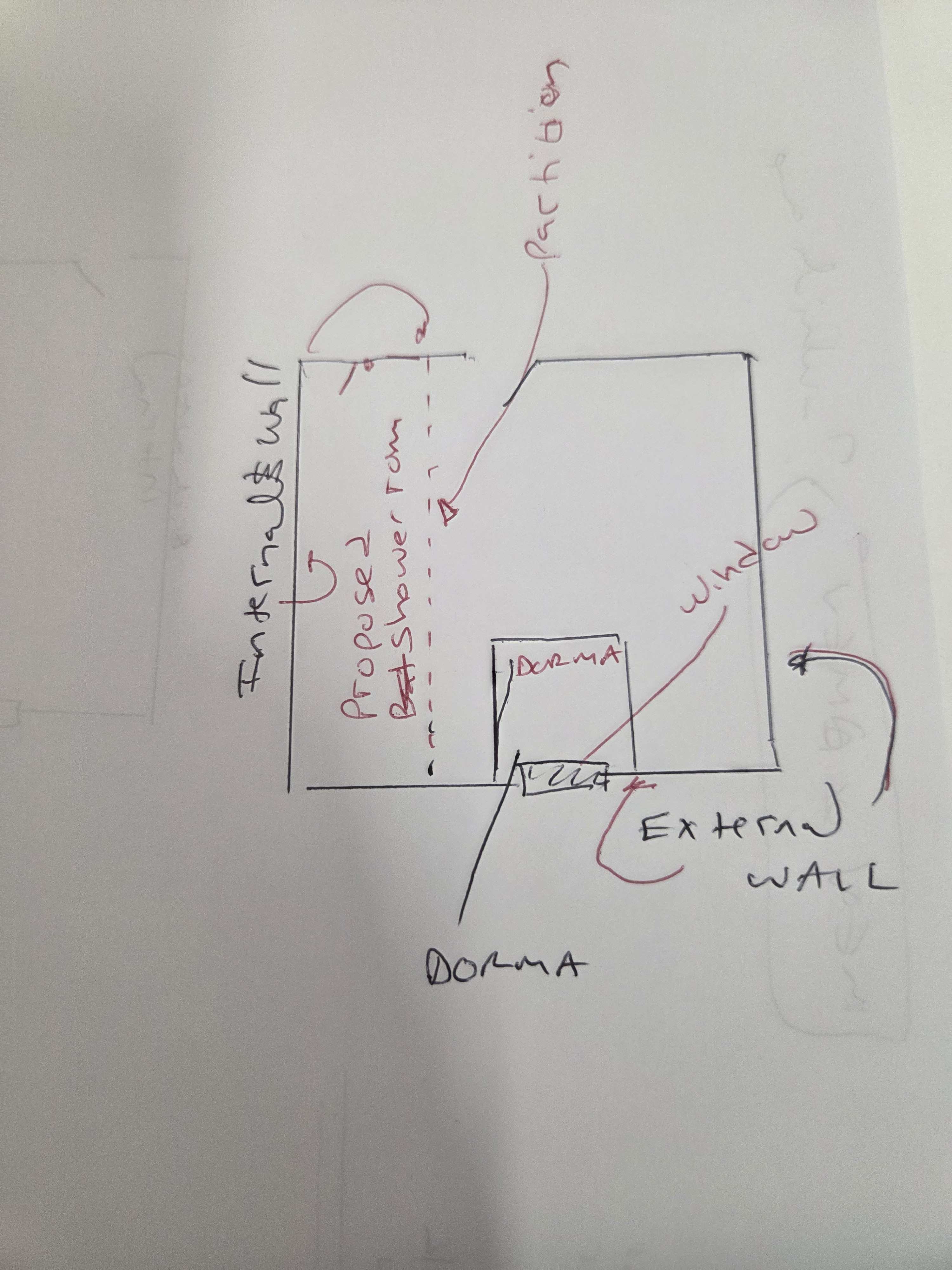

I would be grateful if you could explain the reasoning behind this please. Im about to do my roof and have a dormer like this but it finishes flush with the external gable wall rather than on the pitched rood part. Now I would like to have toilet, shower and sink in the new room to be formed by a partition next to the dormer. Of course will have a good extractor fan in there. Is there a risk I will be introducing problems with moisture or condensation by having a shower room there? How can I mitigate any risk? Thanks -

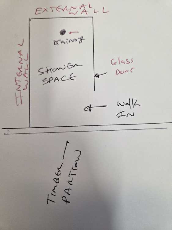

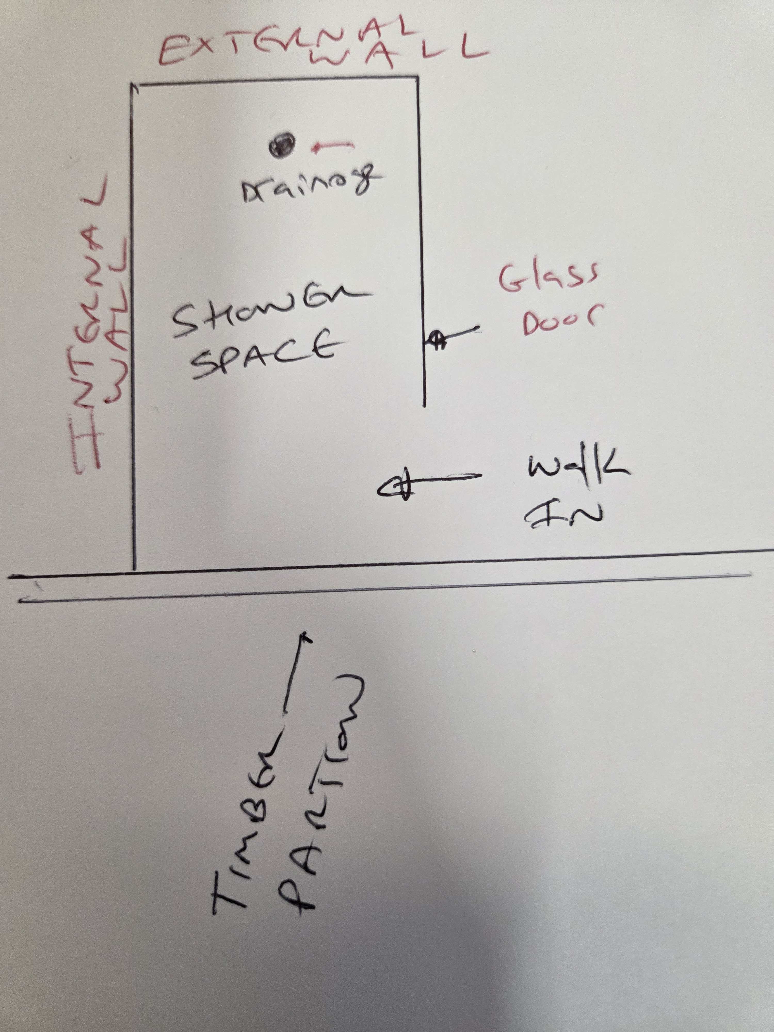

Having UFH for 3 rooms: a kitchen , a bathroom and a living room. In the bathroom I will be having a walk in shower in the shape of a rectangular box dimensions 165cm long and 90 cm wide but without a shower tray. Worried shower trays break easily and also I think it will more cost effective to create the falls needed in the shower area with dry screed. On one of the longer sides will be a fixed glass screen running from external wall with a gap to walk into the shower space and on the opposite side is the internal wall. Shower head and taps will be affixed to external wall on one of the shorter sides of the rectangular box- see diagram attached I will make a small rectangular partition in the floor where the shower space will be if I use wet screed so can get the falls for the drainage. Floors will be finished with tiles. I am in 2 minds about Dry vs Wet screed. Dry Screed will be cheaper but a bit more laborious which I don't mind. Wet will off course be a quicker install but cost premium attached. For Dry I will go with 75mm thickness and for Wet I think the recommended is 60 -65mm thickness. Considering it's a DIY project which screed finish would you opt for? Are both types of screed equally effective for UFH in terms getting the space warmed up quickly and avoiding cold spots?. I suppose the thicker the screed the more time the slab will take to warm up but equally I suppose the more time that heat will be stored in the slab. BTW I have no prior experience with living with UFH so not sure about which direction to proceed.

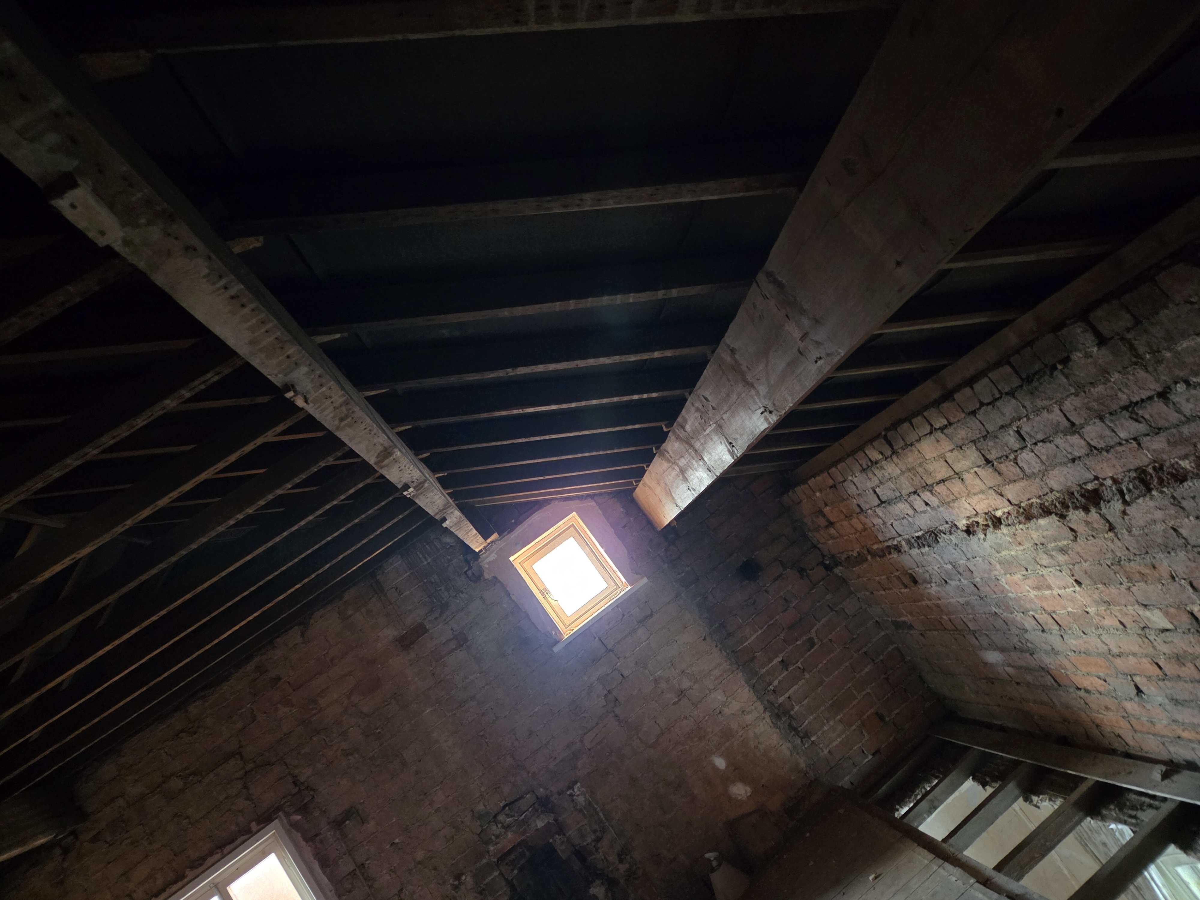

Want to re-roof 100 year semi detached property as 1 ) non breathable felt is failing and allows leaks into the rooms below 2 ) old 3 by 2 rafters in place, appear in good condition and supported by purlins .Purlins placed on opposite side of the room allowing for flat ceiling between the purlins in the room centre and sloped ceiling between the walls and purlins ( I have attached photograph for reference). Gable end is on the side of the property and not the front. There is a single 1 inch ridge board, about 9m, from wall to wall of the 2 adjacent rooms, Ridge board is not slotted into the brick work of either walls, its shy of the brickwork at either end by about 3 inches. There is no visible scarf joints in the board and although its old and it is in good condition. Plan: I want to install 8 by 2 rafters or even 9 by 2 rafters so I could maximally insulate between the rafters. Questions: 1) Can the old ridge board remain or will I need a new one.? Had chat with timber merchant, max timber length he can get is about 7.2m. How do I overcome this? Scarf joint between 2 lengths of timber to make one massive ridge board 2: Which is best breather membrane which allows both air and vapour to pass through it? Roof will be finished off with Fibre Cement tiles. Currently there some Vented fibre cement tiles above the flat ceiling spacing between the 2 purlins. Current fibre cement tiles are probably about 15 years old (a guess). Is it worth replacing them? How can I tell if they had their and need replacing I take it as I'm using a breather membrane I wont need vented tiles any longer. Thank you for the advice.
