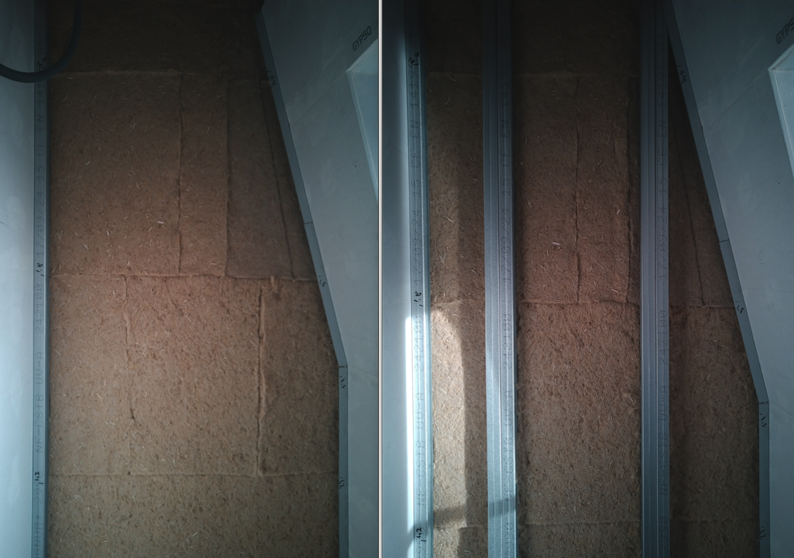

Just found a pair of images to illustrate the above. This is hemp insulation on a wall about 1m wide x 2.6m high, self-supporting (left) before I put the studs in place (right). The batts here are 100mm thick, but the lowest (out of shot) was sawn through to about half that as the wall behind was out of plumb.
Mike. This is interesting. How did you manage to fix the hemp flexi batts to the walls? With some sort of glue?
Very much like this concept and the following dawned on me. can everyone please critique this:
50mm hemp batts fixed to the wall as shown in Mike's photo's with timber battens above instead of the metal studs shown in Mike's photo's to allow for fixing of  either plasterboard with standard gypsum finish or rigidi fibre board with lime finish.
Critically will the flexi batts stay in play independant of the studs.
Previously was going to fix timber studs to wall and push fit flexi batts between the studs but Mike's strategy is much better as it allows for continous layer of insulation not broke by the studs.
In addition electrical socket back boxes can be fitted infront of the flexi insulation batts.
Dunno whether this is eureka moment, atleast appears to be so thanks to Mike's suggestion.
No glue required - they're just cut a little over length so that they gently wedge themselves between the walls.
Short lengths will stay in place until you put the studs in place, or you can slide the batts behind the studs, or a mixture of both - slide just one end of the batts behind a stud, put the batts in place, then the rest of the studs. It depends on the situation.
In this photo there wasn't much space to slide them behind the studs so, as there were walls either side to hold the batts well, it was easier to fix the studs afterwards.

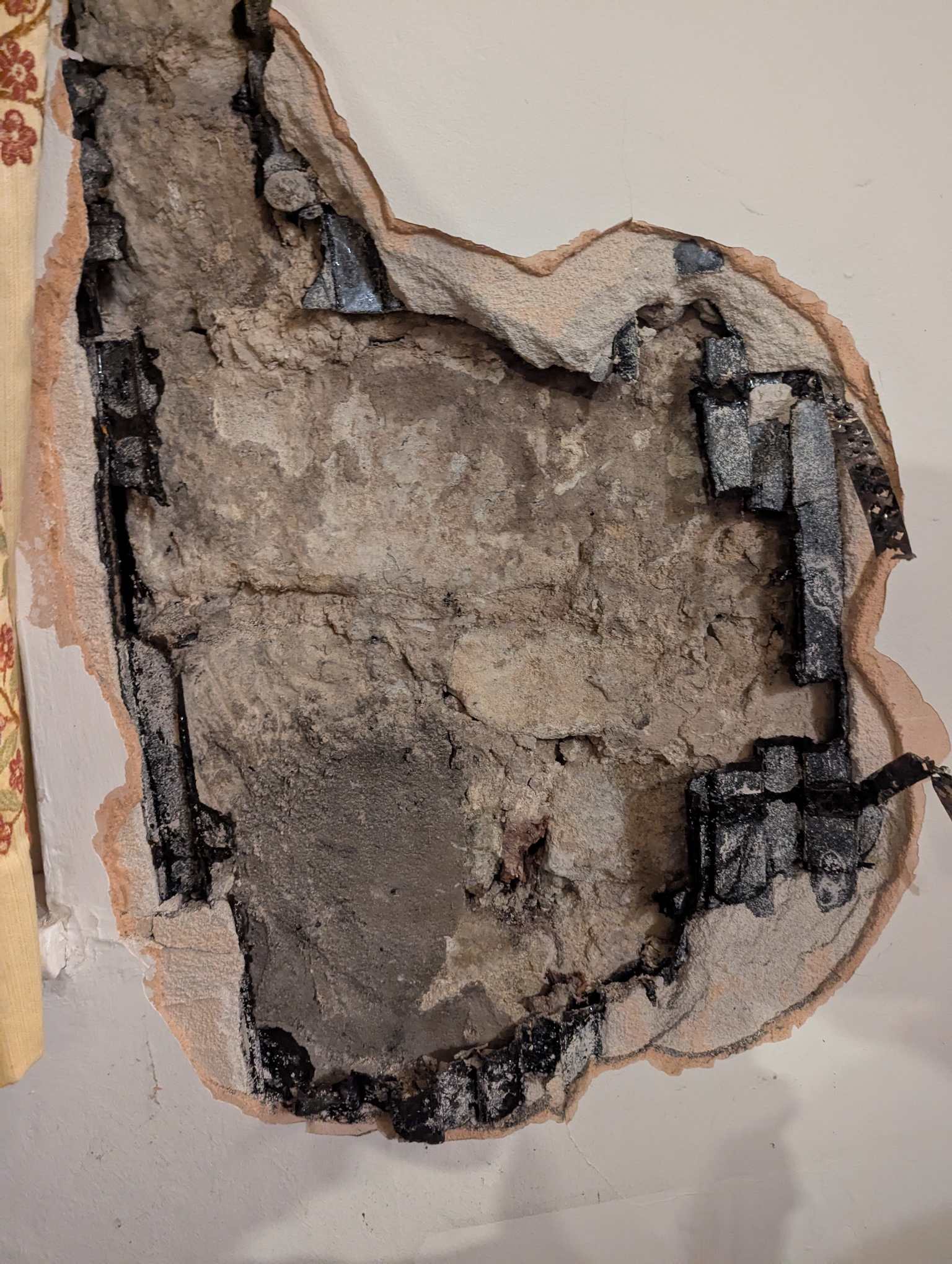

I've been looking more into this after taking some plaster and old newtonite off the walls at home. As expected the stone is pretty uneven, but looks pretty dry. This is about 2 feet above the ground.
I'm thinking about making up my own base layer of lime plaster as a levelling and airtight coat, rather than a cement based parge coat. I was thinking that a 3:1 mix of sharp sand and lime putty (slaked quicklime) with some synthetic hair added is probably the 'best' thing for the walls.
I assume this would suffice from an airtightness perspective and would likely be cheaper than bagged alternatives like Baumit and better than a cement based parge from a drying and wall-health perspective. If I'm only using this to roughly level, hopefully I can get it done in one coat and it won't have to be particularly neat.
Over this I'd do the aformentioned wood fibre or mineral wool with ~50mm battens or a 63mm CLS stud wall creating a service cavity, then plasterboard and skim. If the plasterboard turns out to be problematic down the line, it would be possible to swap these out for a wood fibre board with lime skim, but I'd hope not to have to do this obviously!
Window reveals would also be lime plastered, then lined either with some PIR or somthing like Bosig Phonotherm (https://www.ecologicalbuildingsystems.com/product/phonotherm) or maybe a wood fibre reveal board.
Any thoughts on the above? If the lime putty based plaster is sufficiently airtight I wouldn't bother with an intello membrane, and instead would focus on getting the details of the lime plaster and taping to joists/floors etc right.
