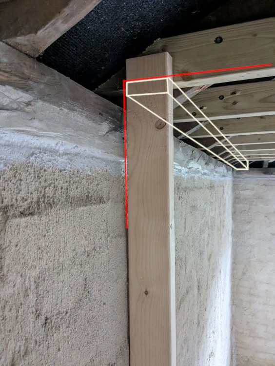

October 4, 20251 yr 1 hour ago, Annker said: Should my airtight layer continue up from the external brick wall and across my 1st floor ceilings; or can it terminate at the top of my external wall? I'd run a timber underside the rafters (yellow below) and fix the vertical studs to the underside of that. The red would be the VCL but, since the wall isn't vertical, leave a little slack so that the insulation can push it flush with the wall. Where you joint the VCL isn't vital, as long as you can access it to make the join.
October 5, 20251 yr Author 15 hours ago, Mike said: I'd run a timber underside the rafters (yellow below) and fix the vertical studs to the underside of that. The red would be the VCL but, since the wall isn't vertical, leave a little slack so that the insulation can push it flush with the wall. Where you joint the VCL isn't vital, as long as you can access it to make the join. In the photo I had only offered up that uncut 4x2 to help illustrate the detail. You are correct Mike, I will be running a top plate along the studs as you've expertly shown in isometric! Just to clarify, you would opt to continue the VCL below all the entire ceiling area, or just ~300mm or so into the ceiling area proper? From my research it seems that where the loft space is a cold roof, installing a VCL at the ceiling level has its pros and cons. It is suggested by some that the ceiling/cold roof space interface may provide a function similar to a dehumidifier removing moisture from the habitable room; installing a VCL would prevent that function from operating. Although in a bathroom perhaps it it best to have a VCL in the ceiling as the required mechanical extraction will remove moisture at a good and controlled rate. Perhaps in terms of ensuring the IWI assemble is air tight, a good option would be to just wrap the top of the studwork in Intello Plus; taped to the wall and tape to the top plate. (As illustrated by the blue line in the mark up below) Seems to tick the boxes of building with the princple of vapour open and air tight to the forefront. Edited October 5, 20251 yr by Annker Spelling
October 5, 20251 yr 6 hours ago, Annker said: you would opt to continue the VCL below all the entire ceiling area, or just ~300mm or so into the ceiling area proper? I would add an airtight barrier across the full ceiling on the the warm side of the insulation in the position of that red line, probably using Intello (which is suitable for the task according to Pro Clima; 'traditionally' it would have been polythene sheet). The main reasons are the second and third ones that I gave for requiring a parge coat: it prevents wind blowing through any cracks in the ceiling, and stops air escaping out due to the 'stack effect' (warm moist internal air is more buoyant than the outside air, so will rise and escape through any gaps, drawing outside air in as it does so). Ideally you'd have a service cavity below the Intello and above the plasterboard. I'd also want eves ventilation trays above the insulation at the eaves, to deflect wind that would otherwise blow into the insulation - the eaves insulation is very exposed without that. Edited October 5, 20251 yr by Mike
October 6, 20251 yr Author 17 hours ago, Mike said: I would add an airtight barrier across the full ceiling on the the warm side of the insulation in the position of that red line, probably using Intello (which is suitable for the task according to Pro Clima; 'traditionally' it would have been polythene sheet). The main reasons are the second and third ones that I gave for requiring a parge coat: it prevents wind blowing through any cracks in the ceiling, and stops air escaping out due to the 'stack effect' (warm moist internal air is more buoyant than the outside air, so will rise and escape through any gaps, drawing outside air in as it does so). Ideally you'd have a service cavity below the Intello and above the plasterboard. I'd also want eves ventilation trays above the insulation at the eaves, to deflect wind that would otherwise blow into the insulation - the eaves insulation is very exposed without that. Thanks Mike. Rationale for installing a continuous VCL makes sense. As with any renovation, each room ceiling will have its own challenges to overcome; Plan was that 1x existing ceiling only needs reskiming and 1x ceiling only needs overboarding. Elsewhere 1x ceiling needs a new MF ceiling installed to get it back to level, remaining ceiling are in a state in which a VCL can be install as is. I have the ideal princple in my head so just have to tailor it to each situation. Understood on the eves tray. A full re-slate of the roof will be done next year so ventilation of the roof space will be entirely dealt with then.

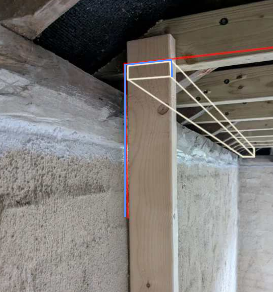

November 23, 2025Nov 23 On 05/10/2025 at 09:26, Annker said: In the photo I had only offered up that uncut 4x2 to help illustrate the detail. You are correct Mike, I will be running a top plate along the studs as you've expertly shown in isometric! Just to clarify, you would opt to continue the VCL below all the entire ceiling area, or just ~300mm or so into the ceiling area proper? From my research it seems that where the loft space is a cold roof, installing a VCL at the ceiling level has its pros and cons. It is suggested by some that the ceiling/cold roof space interface may provide a function similar to a dehumidifier removing moisture from the habitable room; installing a VCL would prevent that function from operating. Although in a bathroom perhaps it it best to have a VCL in the ceiling as the required mechanical extraction will remove moisture at a good and controlled rate. Perhaps in terms of ensuring the IWI assemble is air tight, a good option would be to just wrap the top of the studwork in Intello Plus; taped to the wall and tape to the top plate. (As illustrated by the blue line in the mark up below) Seems to tick the boxes of building with the princple of vapour open and air tight to the forefront. Thank you for sharing info re: IWI. I have to get started soon and just working out the easiest DIY setup for my limited skill set. If it's going to be too much of a skill set challenge might get someone with experience to do it. Are the 4 by 2 timbers mechanically fixed directly to the brick wall without any substantial space between the wall? Are you considering fully fitting space between timbers with some sort of breathable type insulation OR leaving a sevrive cavity gap between the insulation and plaster board to be affixed to the timbers? Definitely like your setup. Thanks

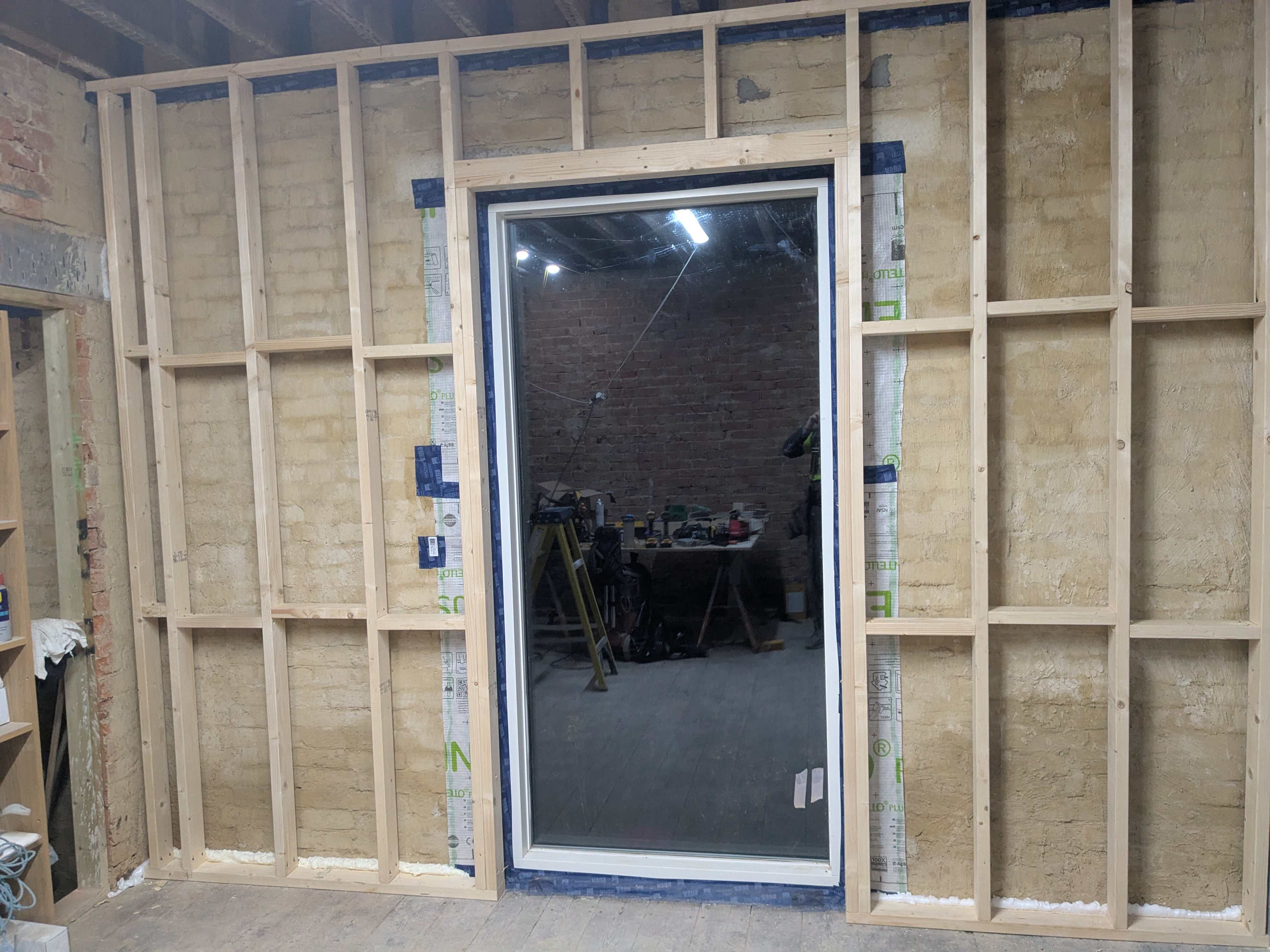

May 25May 25 On 13/12/2024 at 22:12, Iceverge said: Stand the studs off the wall a little. If you're feeling really picky you can jamb a little fluf behind them, but the batts will fill the gap, espically if you space the studs close enough as they're a little hairy at the edges. The batts will just stay there all by themselves if you get the spacing right. Here's one my mate is doing at the moment. These batts are only 50mm too. Even where they're 2 batts in one bay they stay there fine. Use a slightly thicker batt than the depth of your cavity and it'll take out the imperfections. I need to do the same stud walls and fluffy insulation between the studs- DIY project. I know its basic question but can you advise how to make sure I get the studs level both vertically and horizontally so that when plasterboard is attached to the boards it sits nice and flush and wall is nice and even to prevent cracking of plaster at the joins between adjacent boards. Will I need to use packers behind the studs to level them. I should have added some of the walls are bare to the brick so I will be getting plasterer to do a parge coat of lime based plaster for breathability. How long do I leave between the parge coat and adding the stud wall? dunno how long lime based plasters take to dry up and become nice and firm Edited May 25May 25 by ab12
May 25May 25 A laser level head and sole plate and stand them studs between them. Shims behind and concrete screw through the studs to the brick wall intermittently to brace it. A parge coat will dry very quickly. You could do it straight away. Edited May 25May 25 by Iceverge
June 1Jun 1 I've got very uneven walls and my plan is to build the stud wall on the floor then stand it up and get it plumb and straight, then using a laser and a level go stud by stud packing and screwing to keep it level. You can do it in relatively small sections.

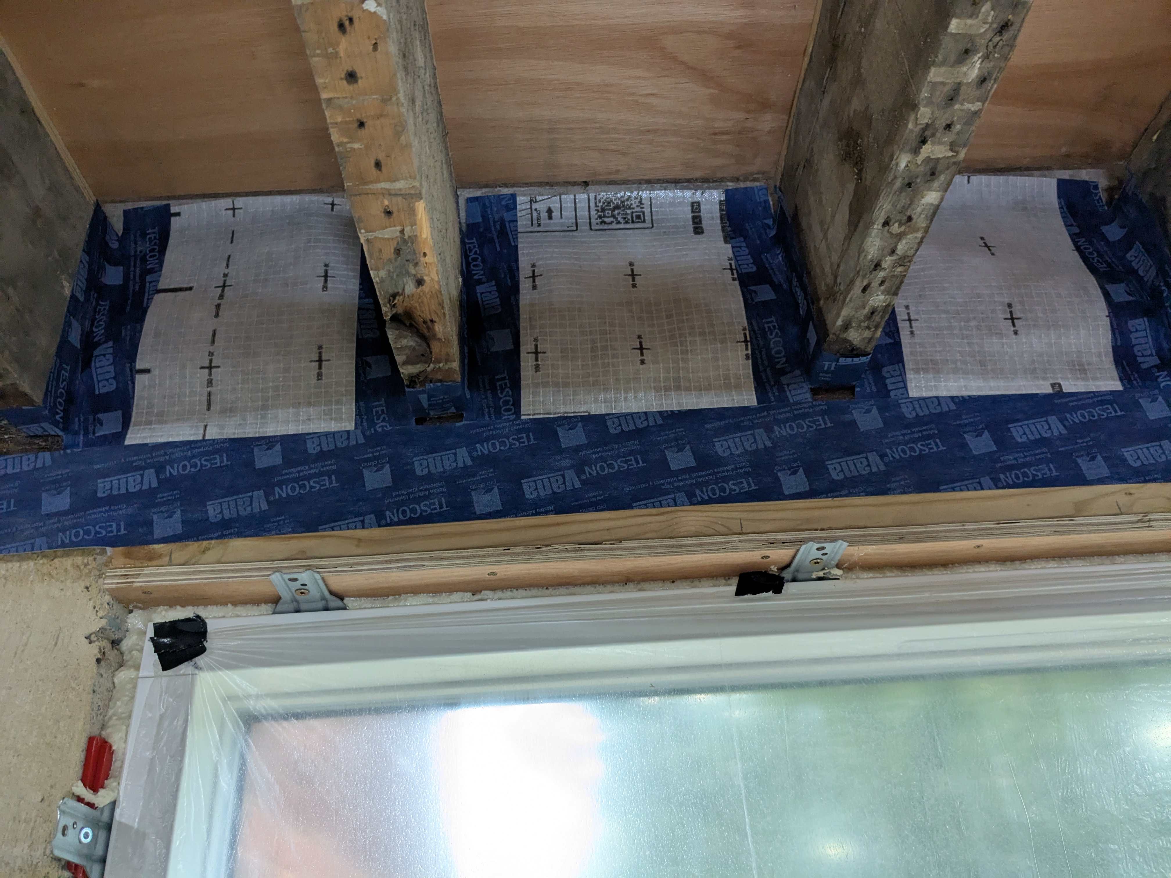

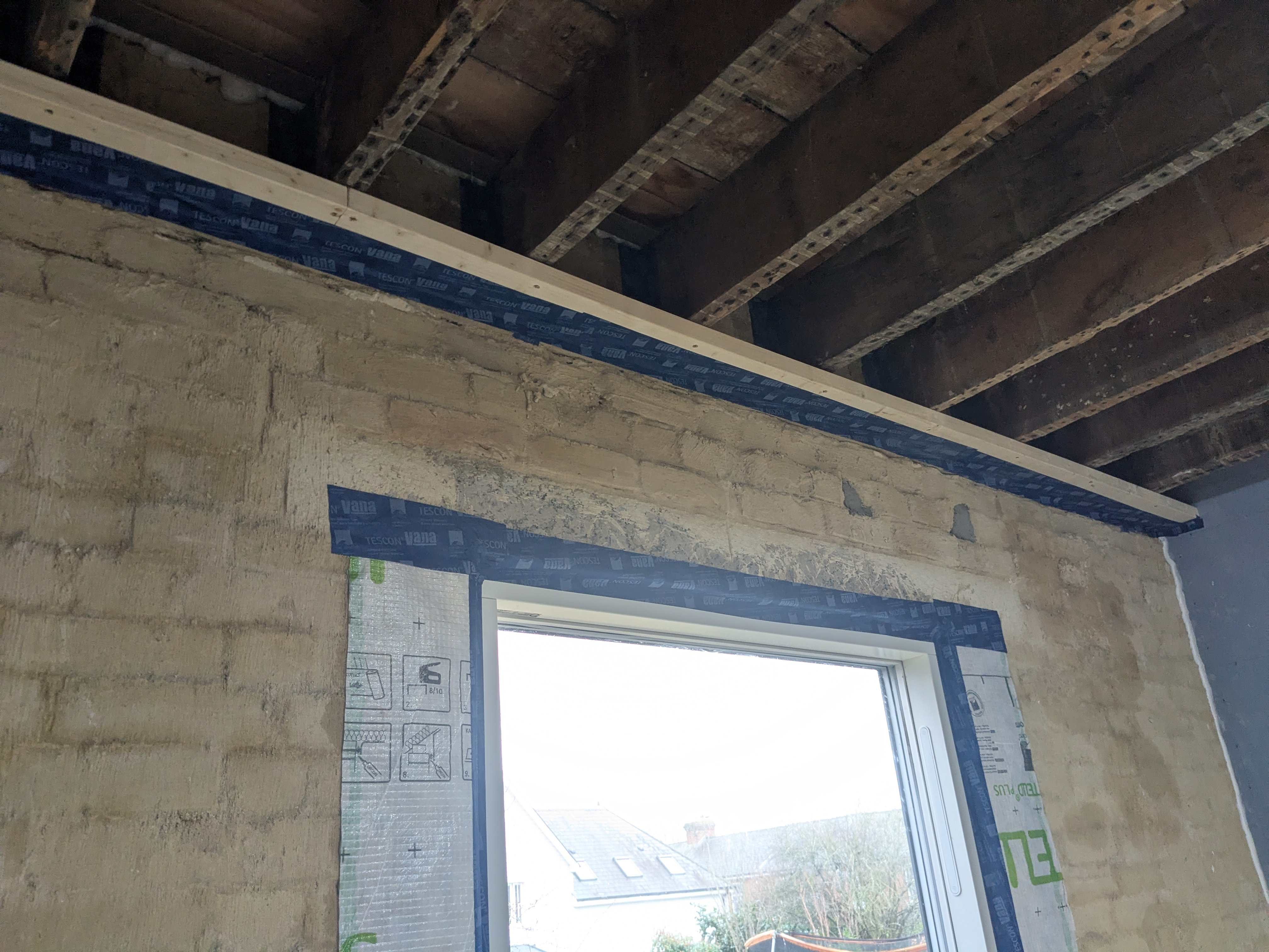

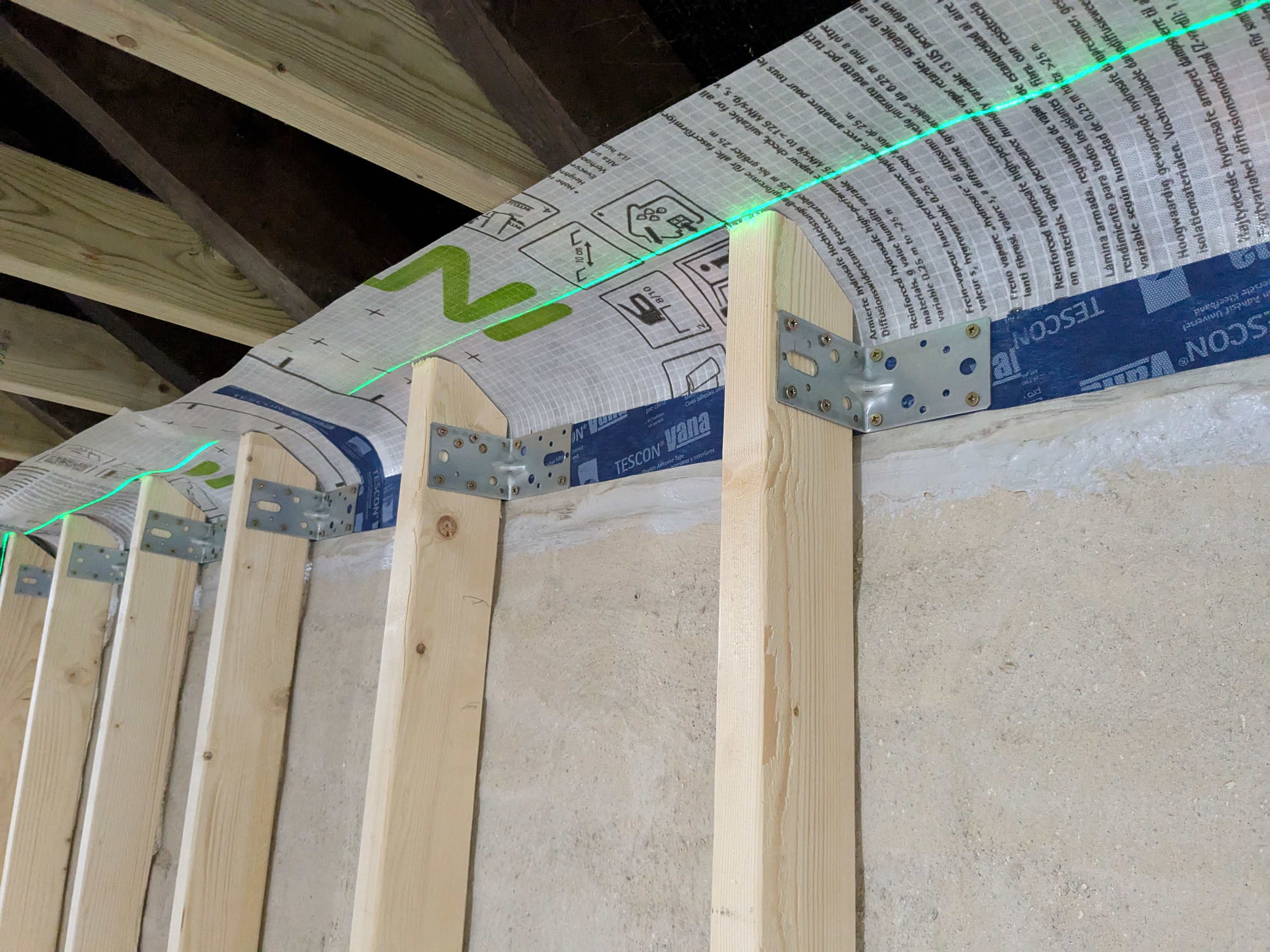

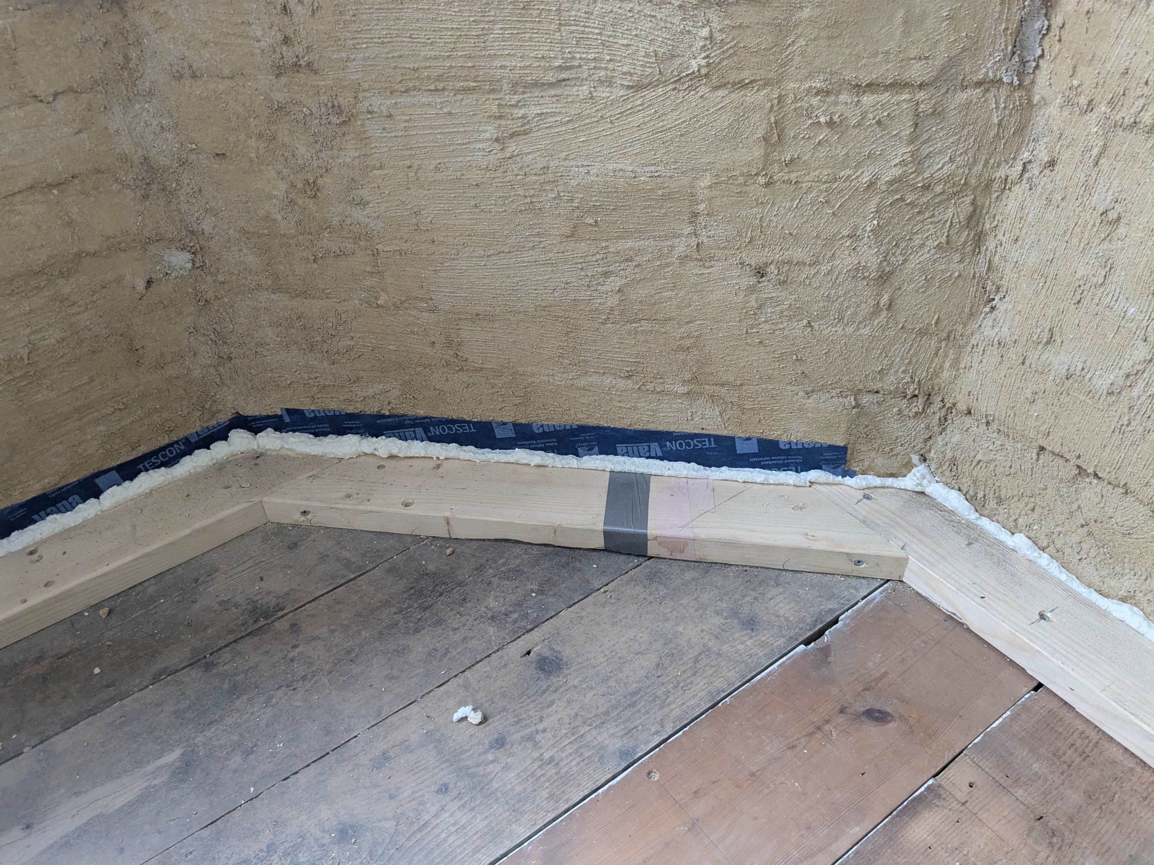

June 23Jun 23 Author Thought I'd do a photo dump of some the onsite installation of the details discussed and generously advised on by some of the member here. Just some notes of interest if you are doing a similar job: Lime parge coat. Absolutely brilliant base before doing anything. Fast to apply, inexpensive and It has sealed up the walls greatly. What I have also noticed is the complete lack of any insects, mold or any living organism on the walls, I'm assumed this is due to the dryness and alkaline nature of lime. Pro clima Tescon tape. Not convinced how well this tape will stay adhere to masonry over decades, stick better to timber and best to membranes so assemble it around joist ends accordingly. And get the primer as it greatly increases the bond. Airtightness of studded walls units: I build the wall studs in situ, and before I installed the individual studs I ensured that the floor/ceiling to sole/head plate junctions were airtight. I used a combo of Illbruck FM330 and tapes. I think having a compartilization model in mind is useful so if there are any individual air leaks into the build-up they wont aggregated from wall to wall, cellar to 1st floor, etc. Insulation will be Rockwool as recommended by @Iceverge I also considered using a glass mineral wool, probably also suitable and less expensive but I have better confidence that RW will sag less in the fullness of time
June 23Jun 23 Author 57 minutes ago, Iceverge said: Top class. That's a pucker job. Keep the pics coming. Will do and thanks again for all your input. Received great advice from yourself and other here, and confident I have a good understanding of the principles at work.
