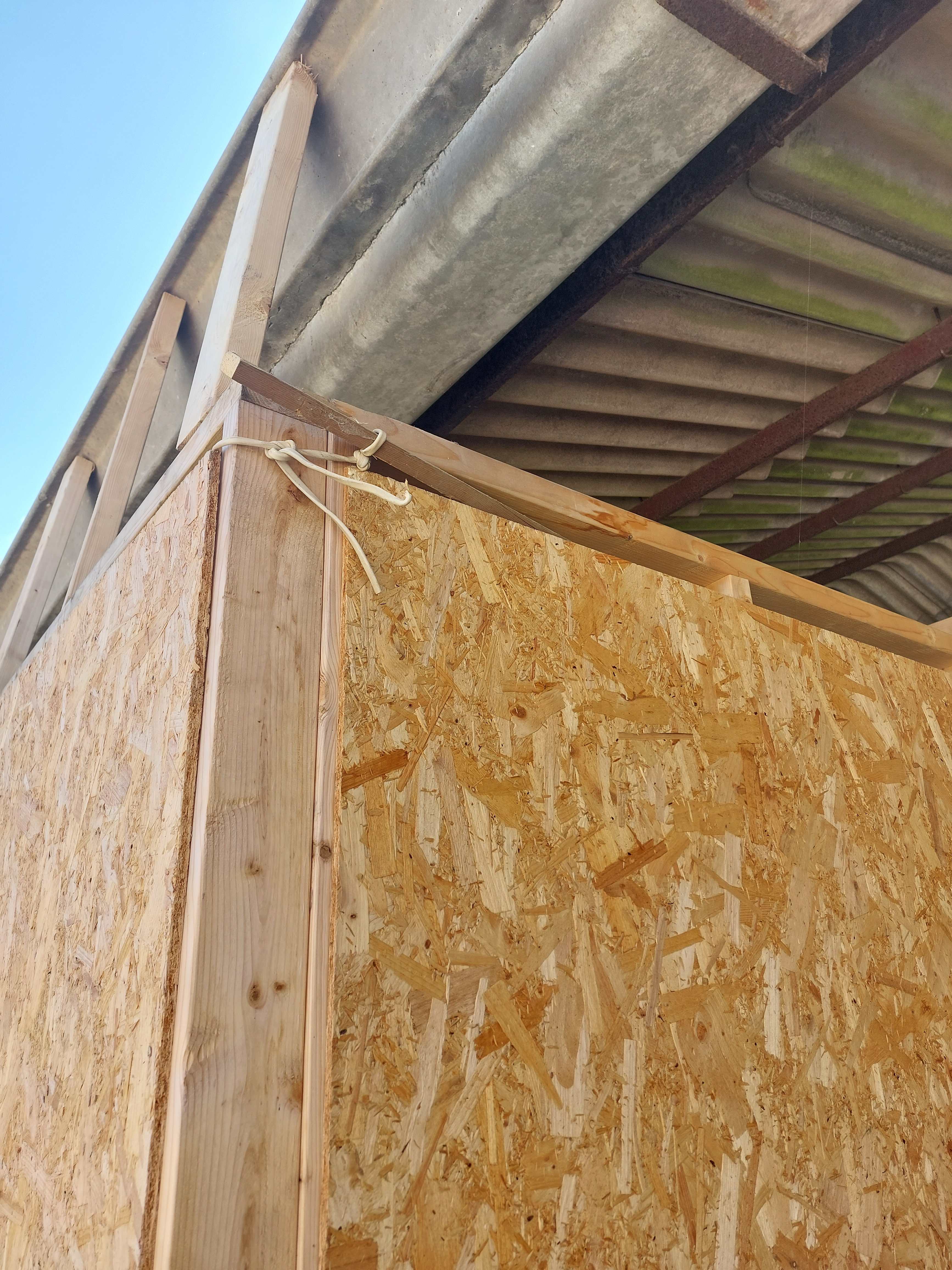

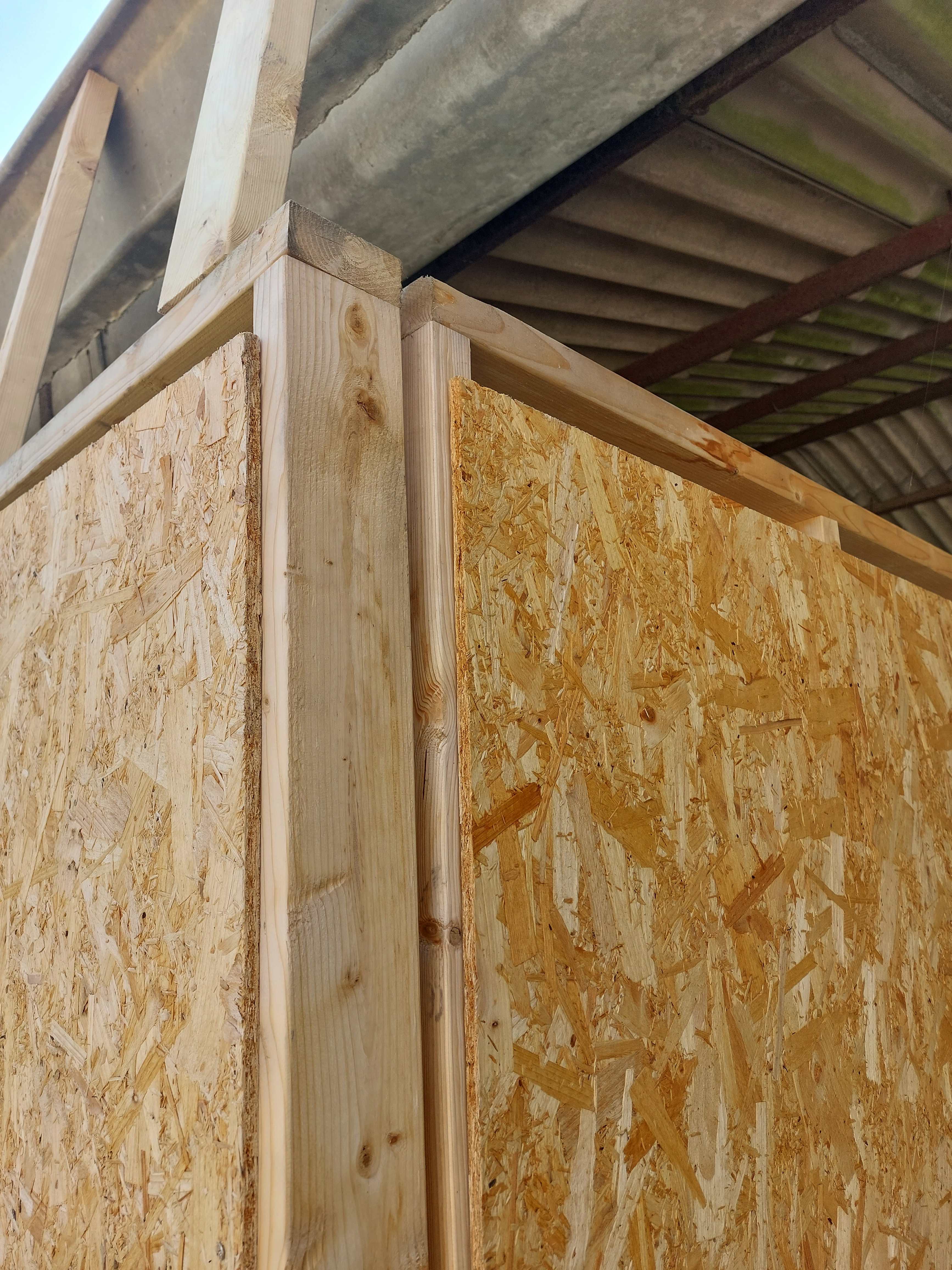

saveasteading Posted September 2, 2024 Posted September 2, 2024 I have been very slowly constructing a toilet enclosure, using 4 x 2 and osb. It is under cover but open to the air. As I am working alone, and not the strongest, I have limited the size of premade panels, and some details aren't too clever. At an external corner, I have studs on both panels and didn't fix them together at the top. . With leaving it a fortnight, one of the studs has bent in the 4" direction, and there is a gap of about 30mm. Any tips on how to bend that back before I whack a big screw or 2 through? I have vague recollections of my father using wires on nails, perhaps levering with a claw hammer or nail bar. I am doing this dreadfully slowly. nothing is quite square or lining up. The main lesson is that properly, fully made panels on the ground and including the osb, must be the way, if there is muscle available to heave them up. Also that a lumpy concrete floor makes panel building on it very tricky. Fortunately a rough* job will suffice, as it will be site toilets and then a workshop toilet. *Characterful / rustic

saveasteading Posted September 3, 2024 Author Posted September 3, 2024 Here it is. A powerful clamp would do it but I don't have one. Going to try a Spanish windlass.
joe90 Posted September 3, 2024 Posted September 3, 2024 If you drill the 2” side with a ciearence hole you might find a 6” screw will pull that tight, you might need a washer under the head tho 1
saveasteading Posted September 3, 2024 Author Posted September 3, 2024 Exactly so. At the second attempt the windlass brought it to 10mm. Any tighter and the flex was about to break again...twisting failure. From there I used a heavy threaded hex head screw, with a predrilled hole in the 2" stud to clear the threads. One at about 600mm down , pulled it in tight there. Repeated at top. There was lots of pinging of osb screws so that needs looking at. Simply in looking for the photo I saw the windlass potential, so it goes down as another success for BH. 1
saveasteading Posted September 3, 2024 Author Posted September 3, 2024 Pic now attached showing length of cable and lever of roofing batten. 1

Dave Jones Posted September 3, 2024 Posted September 3, 2024 2 hours ago, saveasteading said: Here it is. A powerful clamp would do it but I don't have one. Going to try a Spanish windlass. so you built the corner wrong. the top plates need to be continuous and not floating in the air, BCO should fail it as its structurally not safe. Google California corner.... Whats with the osb not cut or fixed square?

saveasteading Posted September 5, 2024 Author Posted September 5, 2024 On 03/09/2024 at 16:09, Alan Ambrose said: ventilation maybe? Exactly. No need for it to reach the roof or have a ceiling. But if I do put a ceiling on I might leave the gap. I simply decided to let the osb rest on the floor (it's on a concrete plinth) so it was short at the top. Plus the plinth is miles off level.No sole plate as that was another piece of wood..... Obv I could add a top plate if I want. I've learnt that this is tricky. Panels on the ground are very heavy. Leaving off the osb leaves them wobbly. Stick building in the air is very tricky. Def a 2 person job. No building regs. It's an existing pair of wcs in an outbuilding, where the enclosures had been removed for some reason. Goes to a septic tank. Site toilet is quite a bonus. 1
