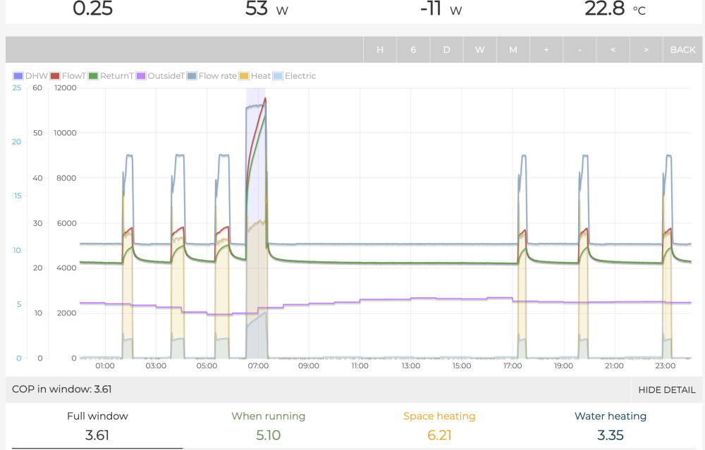

If you running WC it's pretty difficult to overheat any part of the house. Unless you're curve is way out.
Local rooms overheating via solar gain pretty much self manage anyway, delta T between floor and room decreases and output from floor stops. No controls needed.
2 hours ago, ringi said:
may wish to overheat the living room area of our banaglow on cheap rate electricity
You can use your floor to buffer loads of heat and it really has very little impact house temp (to a point). Thicker the screed the easier and least fluctuation on house temp.
With gas boiler I routinely heated whole house floor for 6 hours and lived of the heat for the next 18 hrs, about 1/2 Deg house fluctuation. Heat pump isn't powerful enough, to do that on a cold day.
