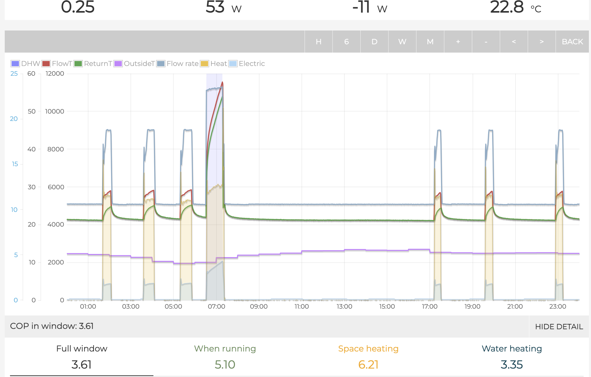

JohnMo Posted September 13, 2024 Share Posted September 13, 2024 (edited) 43 minutes ago, IanR said: mid-September Tell that to Scotland, was 2.5 last night. Highest average temp over the last 4 days was 9 degs. A 6 Deg OAT is getting 4.9 CoP and a 2.5 OAT getting 4.7 CoP. 43 minutes ago, IanR said: Thankfully there doesn't need to be a "one size fits all" solution, there are plenty of options. You pay - you choose. Forums like this give people options, to allow an informed choice. No right answer just informed posts. Buffers that are big, I see zero issue with, very little mixing occurs, you can fill the buffer to your heating temp via WC, very little cycling very little over temperature required from the heat pump - but not many people have room for a DHW let alone another 200L or bigger buffer. I just use my floor as a buffer. Small buffers on the other hand, that most installer fit, are the devils work. Plenty of mixing elevated return flow temperature knocking down the CoP considerably. 43 minutes ago, IanR said: you appear to have put many hours into to getting yours to run correctly Not really, I have spent lots of time learning about low energy, low flow temp heating systems. And used these lessons through trial and error on my own system. Mostly because I have enjoyed it. Most people are paying a very high price for a heat pump install, they should be getting this level learning as part of the price - not many seem too. Did an experiment the other day, ran the heat pump at a fixed flow temp, set a thermostat at target house temp. House temp super stable, just like well set up WC. Like for like outside temp CoP dropped from 6 to 5. Edited September 13, 2024 by JohnMo Link to comment Share on other sites More sharing options...

JohnMo Posted September 13, 2024 Share Posted September 13, 2024 45 minutes ago, IanR said: ASHP has just modulated down and the the rooms without solar gain are now not getting enough energy, so will start to chill off Not really, the heat pump is never off, the compressor only will go off. So if you need a floor surface temp of 22 to keep room temperature stable, once the return temp gets 22 the compressor restarts tops up the floor. With the flow on all the time, the floor temp never drops below a useful temperature. All set via the WC curve. Link to comment Share on other sites More sharing options...

JohnMo Posted September 14, 2024 Share Posted September 14, 2024 7 minutes ago, IanR said: that @ 11°C OAT your WC is setting the Flow Temp to around 28°C Correct, flow temp will 28. Flow temp doesn't equal floor surface temp, there is a temperature gradient away from the pipes. But at 11 degrees the compressor runs for about 20 to 30 mins and is off for about 3+ hrs. While the compressor is running heat radiates from the floor pipes in to concrete, so floor surface temp gets a small increase in temperature, it's not 28 degs. If my heat pump would turn down to less than a kW at 11 degs, it would be set to the lowest flow temp I could - it would not run to 28 degs. I have tried to run shorter cycles at a lower temperature, but energy transfer wasn't great. So the fact is as I sit here, the heat pump compressor ran 3 hrs ago, water is being circulated at 22 degs, summer house is being heated by 22 Deg water. It is unlikely the heat pump will do anything other than DHW for the rest of the day. If I get solar gain in the lounge the floor output will go negative and that heat will be redistributed. 27 minutes ago, IanR said: The over-heating room will cause the compressor to switch off before the non-solar gain room's energy requirements are met. No not so, if you are getting a lot of solar gain, the compressor goes off, but the floor is a huge buffer, it always at or above minimum temperature required to keep room temperature stable. Last year I was using the floor as a storage heat, heating for 7 hrs (longer when below -3) , extracting heat for 17 hrs. House had a 0.5 Deg fluctuations generally. Link to comment Share on other sites More sharing options...

JohnMo Posted September 14, 2024 Share Posted September 14, 2024 As I said my heat pump compressor runs for 20 mins and is then off a few hours at 11 degs. So I doubt the sun coming out and the heat pump being on would, A. likely occur within the same time period, and B in that 20 minute period I am only adding 1.3kWh to the slab. My wife just had the hairdryer on and put close to that into the air. As I said we are only here to give opinions, ours are different and that's good. Your system works for you, mine works for me. Link to comment Share on other sites More sharing options...
