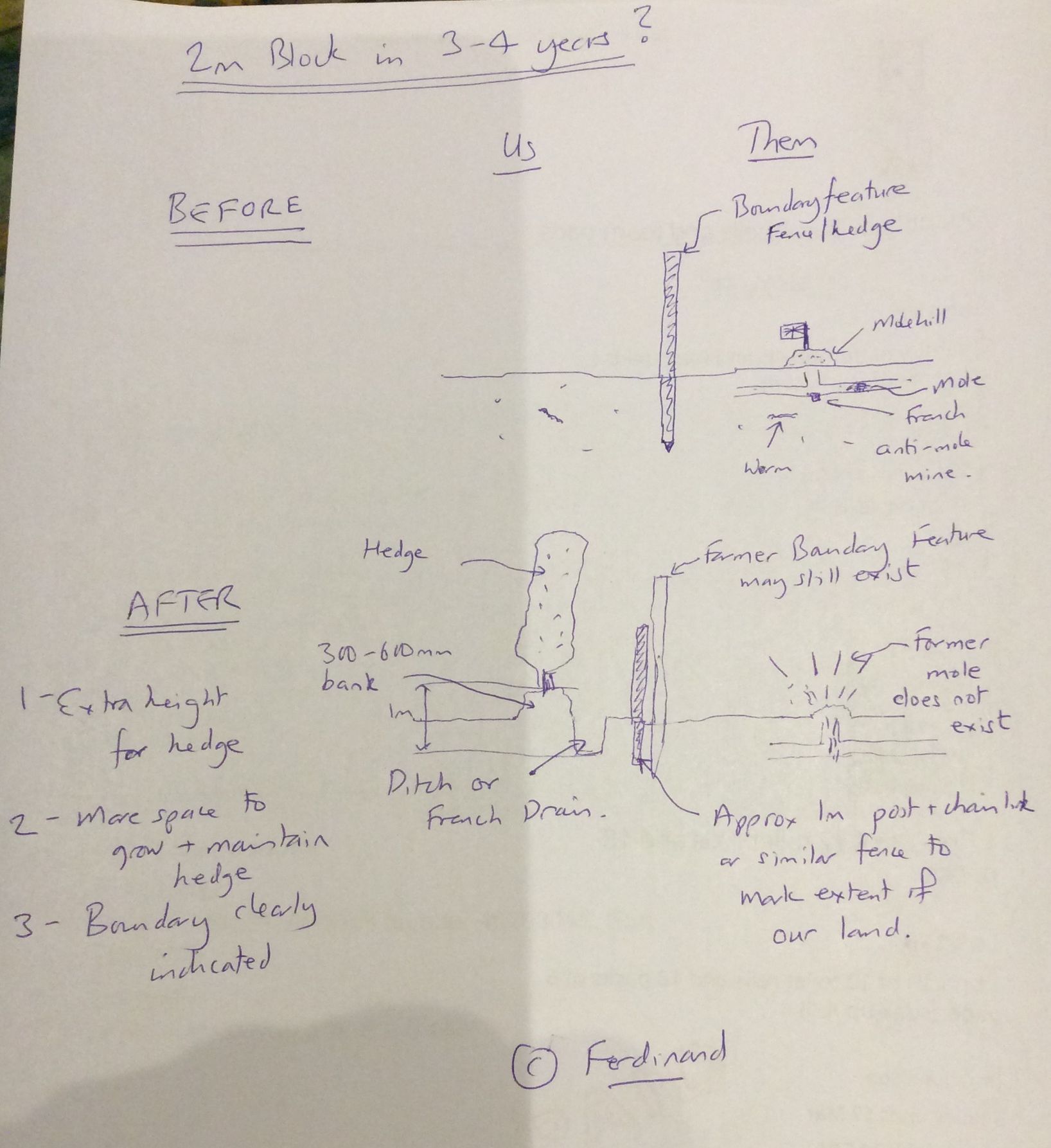

Ferdinand Posted November 9, 2017 Author Share Posted November 9, 2017 (edited) Thanks for the comments on this thread, @A_L, @Hecateh, @JSHarris, @PeterStarck, @Temp, @ProDave I agree with most comments. 2m in 3 years is doubtless demanding, though something a little ambitious - say 1.4-1.6m in 4 years - may be achievable. As to how I would do such a boundary, I think I might adapt the traditonal field hedge principle of "dig a ditch, build a bank, plant the hedge on the bank" but with a definite boundary feature as the location of the boundary on the traditional hedge-bank-ditch layout is less recognised than it used to be, like the "your fence is on the left (or is it right?)" rule of thumb. So I would probably do something like this, which should add to the height of the hedge and give it a boost. Would require a minidigger and perhaps a post-hole borer for any long length of boundary, but to me it does not look particularly difficult to do. I would go for the concrete + postcrete + strainer wires + chainlink type boundary fence here because I cannot guarantee a post + rail horse type fence to last more than about 12-15 years once it is inside a hedge. 1 - Put in boundary feature - I am suggesting something like one of those 1950s concrete post + chainlink fences that are still in many of the hedges on our council estates. Cheap and last a long time. 2 - Dig a ditch / French drain inside the boundary to allow for hedge maintenance / growth. Elsewhere on the forum we know the potential value of a French drain round the boundary. 3 - Plant hedge on bank made from contents of ditch - may need top / sub soil managing, compost and careful choice of hedge species. Would very much help on some soils. Ferdinand Edited November 10, 2017 by Ferdinand Link to comment Share on other sites More sharing options...
