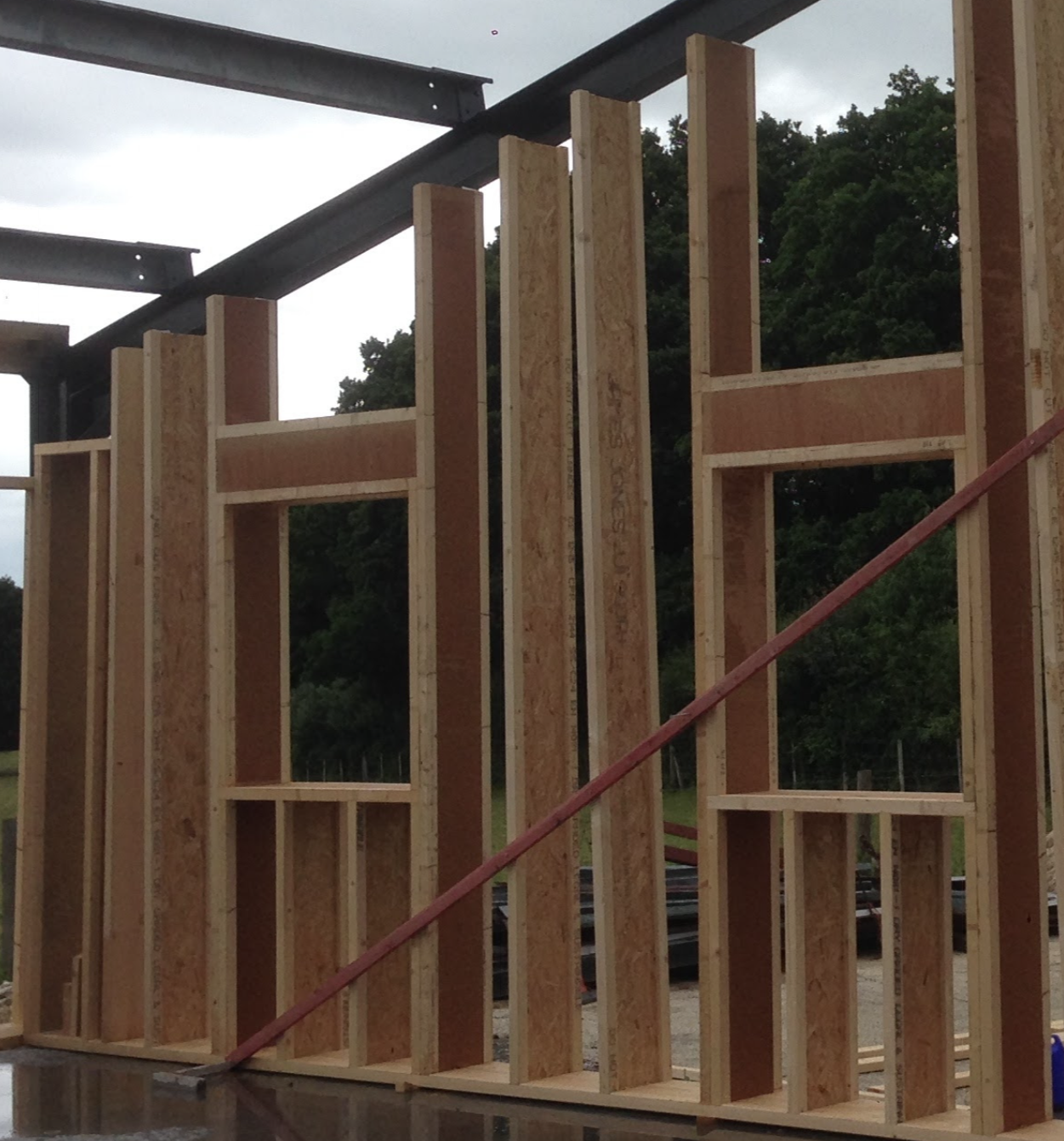

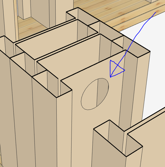

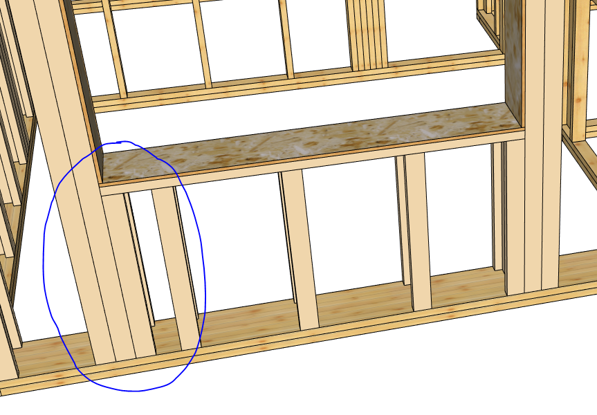

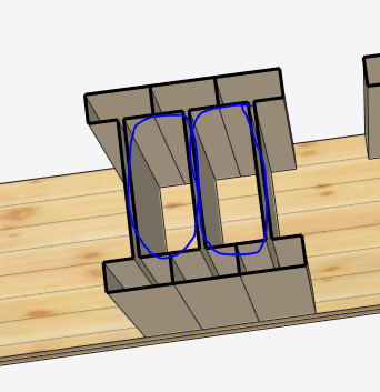

Duncan62 Posted August 2, 2024 Posted August 2, 2024 Hello all, we have cripple studs in our TF IBEAM design. My question: how best to get insulation into these? I'm don't want to reinvent the wheel, so please chime in with how it's done! The plan is for woodfibre/cellulose blown insulation in the main voids. Here is the cross section FIRST idea is to make holes either side, with an adjacent hole on the inside air tightness board, and feed the pipe through the first void into this difficult one. Fill. Repeat up the wall. SECOND idea is to fill with 100mm Rockwool in the 88mm void - As it is being constructed. The Rockwool will friction fit on one side as the second is positioned and fixed into place. Thank you!

joe90 Posted August 2, 2024 Posted August 2, 2024 Either will work but the advantage of no 2 is you know there is no voids

Duncan62 Posted August 2, 2024 Author Posted August 2, 2024 26 minutes ago, Alan Ambrose said: +1 keep it simple 3 hours ago, joe90 said: Either will work but the advantage of no 2 is you know there is no voids Great. I thought so. I'll get rockwool slabs to fill them.

Duncan62 Posted August 5, 2024 Author Posted August 5, 2024 The I-Beam flange depth is 210mm. If I cut in HALF 455mm NyRock® Cavity Slab 032 (or similar) 455mm / 2 = 227mm Will this friction fit nicely? Or is 17mm excess not enough for a nice friction fit?

Duncan62 Posted August 20, 2024 Author Posted August 20, 2024 Thank you all. Following up: how is best to ensure insulation stays in place during construction? Will use Rockwool RW3 60kg/m3 insulation, in 100mm/50mm/25mm depths as required. 600mm wide, 1.2m long. This is cut into 240mm/240mm/120mm strips, 1.2m long. This will nicely fit the 220mm void. (doubled up when using 120mm width strips, obviously) Shall I simply apply wood glue to the inside of the I Beam, then lay the cut Rockwool strips - and wait for it to stick?
