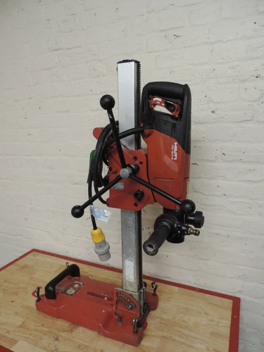

saveasteading Posted July 31 Share Posted July 31 I have hired a serious bit of kit, a Hilti D150 drill with stand, and a 110mm diamond core drill. One of those drills and a core a bit like that but longer ( and blue) I'm looking for any experienced advice. This is to take samples through the existing floor slab which is clearly very strong, and which the drawings from 40 years ago say to be 6" thick. I simply want to confirm the thickness, and the quality by inspection, and will take a few cores. They sold me some anchor sockets to drill into the slab to hold the stand in place. I wasn't expecting to have to do that, Now I see that the 4 bolts that should screw down into the floor are jammed. Therefore I know that the previous hirer did not have to bolt it down. Maybe they are really for horizontal drilling. it also looks like a very precise bit of drilling for those 4 fixings. Has anyone used one of these? Will it likely work without bolting down? especially if I take it very slowly and gently on the lowering handle. I have a water connection for it. But there is no instruction leaflet and I am deemed to be an 'experienced operator' who did not need a demo. All the signs are that it will indeed be as designed, 6" thick on average with a single layer of mesh, probably stamped in after the pour. ie a thorough design with rural construction processes. So it will need this heavy drill to get through it. Has anyone used one? Any other suggestions or hints? Just for fun, assuming this works, I am estimating an hour per hole, including moving it, if it doesn't need bolting down. Link to comment Share on other sites More sharing options...
saveasteading Posted August 1 Author Share Posted August 1 I like that BH members say nothing if there is nothing to say. I've had a day with the machine. 4 cores successfully removed and the quality and thickness is all good. I didn't bolt it down, instead using 14.5 stone carefully placed on the stand and applying the lever pressure gently. If I was 11 stone it wouldn't have worked. I am now the BH expert on the reality....a hole should take 10 minutes but 4 holes took 5 hours, including umpteen hassles. 2 Link to comment Share on other sites More sharing options...
Gus Potter Posted August 2 Share Posted August 2 Well done! Who told you a proper core would take 10 min? This is a proper core sample not making a hole for a duct say where you can afford to be rough. Coring a slab for techinical investigative info takes time. If you thrash into it you won't get a proper slab depth. Every 10mm matters when you are coring a slab for strength analysis / verification. From memory the going rate is £100 - 150 a core on a 150mm anticipated slab depth with a recovered sample (in good shape) for the operative time. If you have managed 4 in a day then that is not bad. Each one needs to be logged, photgraphed etc and they need thinking time too! 1 Link to comment Share on other sites More sharing options...

markc Posted August 2 Share Posted August 2 (edited) I didn’t see the post until now, the 4 corner screws are for jacking the base to plumb and account for uneven surface. You generally use a single bolt in middle of the base plate (for horizontal or overhead drilling) or stand on it for slab work. many bases have a rubber ‘skirt’ to seal using a vacuum pump but bolting or standing on it are the usual methods Edited August 2 by markc Link to comment Share on other sites More sharing options...
Alan Ambrose Posted August 2 Share Posted August 2 >>> a serious bit of kit That, pah, a kids thing - could probably hurt a soft human some though. The Hatton Garden guys didn't seem to bolt theirs down and it was horizontal. I wonder how that worked - some kind of frame maybe? And that's, say, 400mm? No rebar at all? Link to comment Share on other sites More sharing options...
saveasteading Posted August 2 Author Share Posted August 2 5 hours ago, SteamyTea said: I posted a response, asking you to video it. I have one more to do so may ask for spousal assistance. The whole kit wants to rotate counter to the drill, of course. Plus it lifts at the drill end in response to downward pressure on the rig handles. 3 hours ago, Alan Ambrose said: didn't seem to bolt theirs down this must have been serious kit, and serious expertise. I wonder if it had a bolt down through the drill, so it would come out with the core. Or Acrows across the room. Anyway, the tech guy should be given a job in the army where he could do some good while being contained. Where has the filth gone? No cooling water? Link to comment Share on other sites More sharing options...
