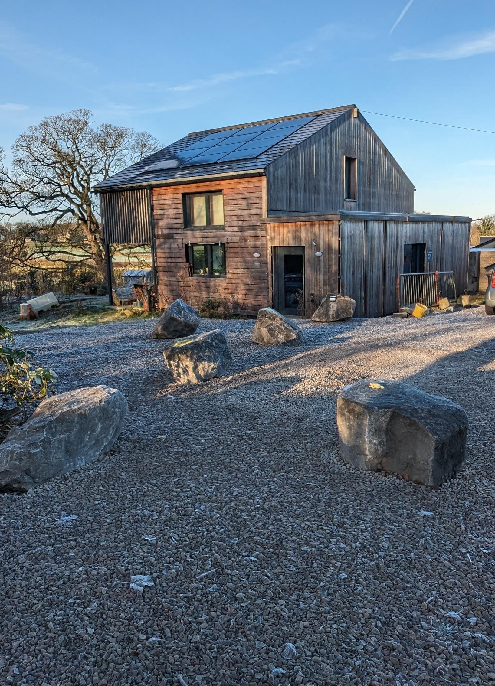

HerbJ Posted July 26, 2024 Posted July 26, 2024 We used Sweet Chestnut for our build in 2015/16. There was post on the subject on April 2022 - see attached. I can take some current photos, if useful?
G and J Posted July 26, 2024 Author Posted July 26, 2024 Thanks @HerbJ that' kind. The problem we have is finding something that can take both the fire treatment and the coating that accelerate and even out weathering to silver.

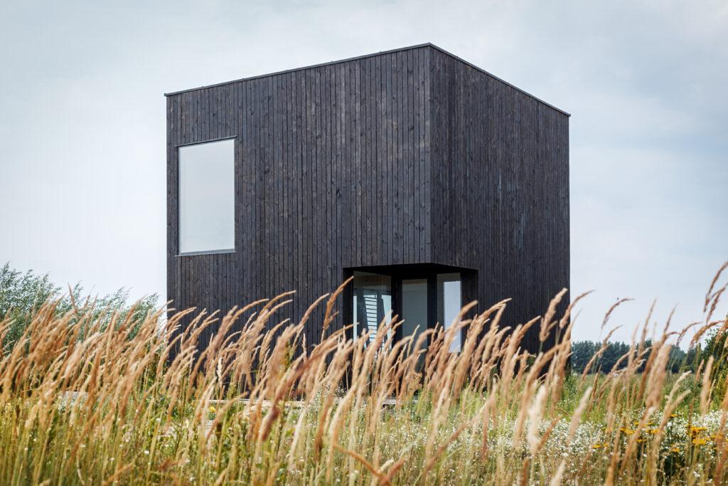

oksleator Posted July 26, 2024 Posted July 26, 2024 I love charred timber, Shou Sugi Ban style, I think you can use various different timbers for that, and it's already burnt so resistant to further burning?
G and J Posted July 26, 2024 Author Posted July 26, 2024 5 minutes ago, oksleator said: Shou Sugi Ban style It looks good, but we are in a an area(residential) that was up in arms about cladding, even though the silvered timber will be in keeping with the boat yards in the conservation area about 500 yards away......our planner was supportive, the neighbours not so much....
oksleator Posted July 26, 2024 Posted July 26, 2024 Ugh frustrating. We've had the opposite on our street. Neighbour has a big extension being built and she wanted charred wood, we (neighbours) were all excited to see it. Planning said it's not in keeping so she's had to go the Ayous route, which definitely wont fit with our yorkstone mill cottages. It's not clad yet or I'd take a photo for you.
