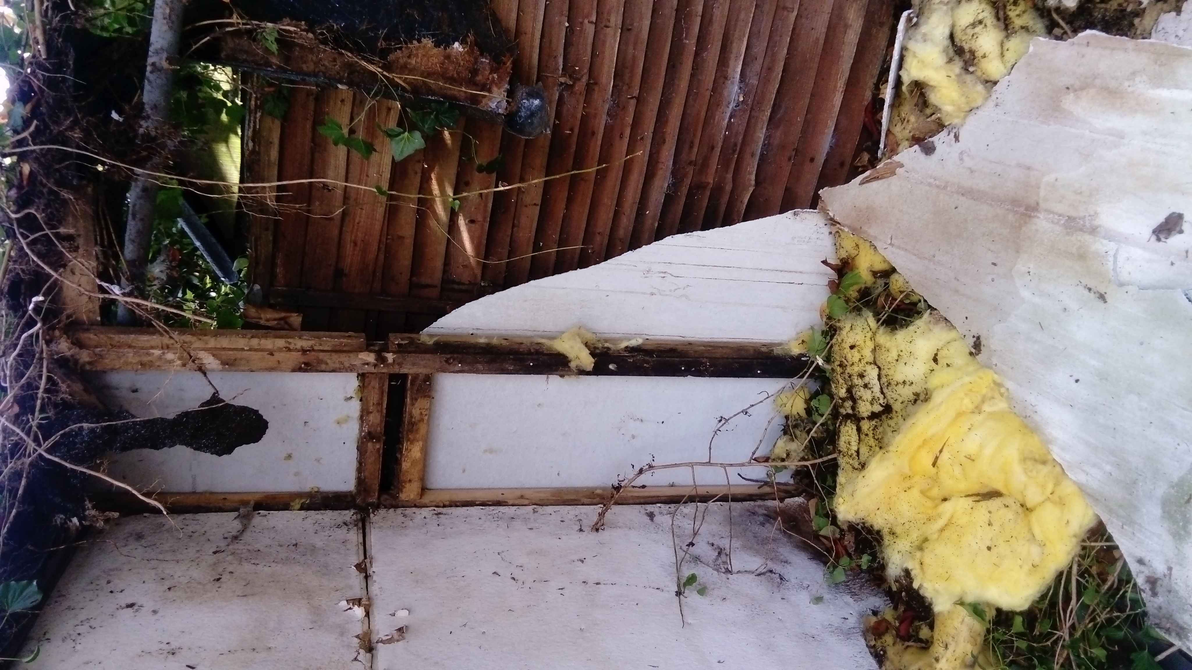

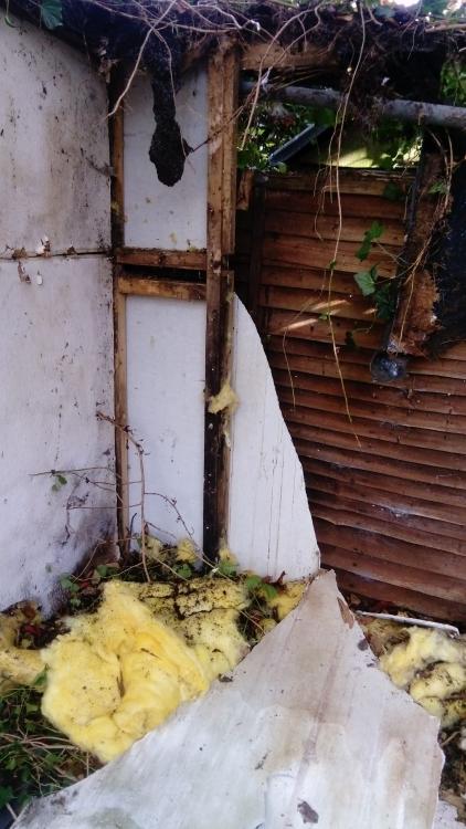

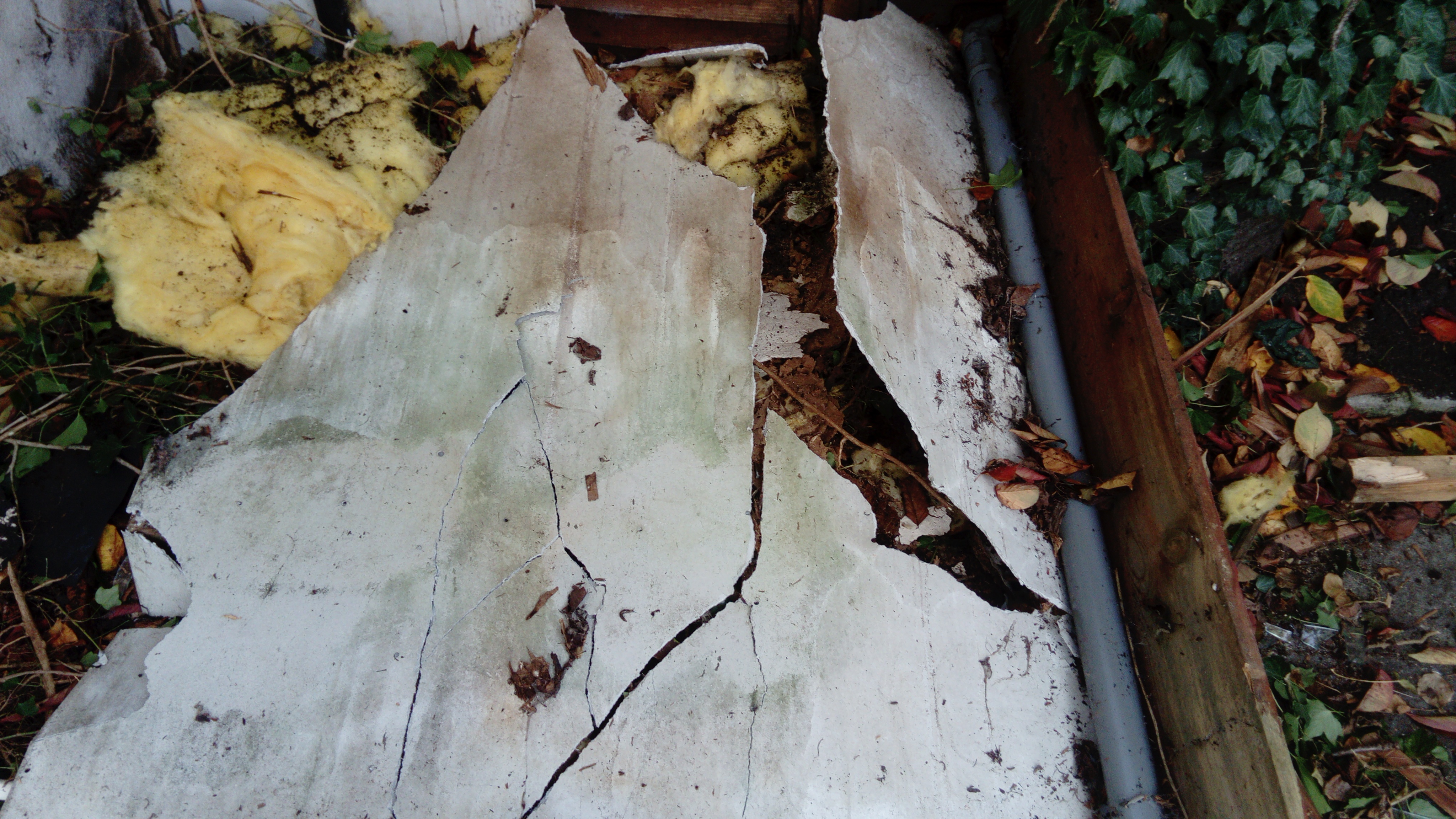

Dee Posted October 27, 2017 Posted October 27, 2017 Can anyone identify this? Think it's been up since the 70s
Ian Posted October 27, 2017 Posted October 27, 2017 (edited) It does indeed look like asbestos cement panels but impossible to say for certain from those photos. There are labs who would analyse it for you and give you a definitive answer. BTW - the rule of thumb for asbestos in buildings in the UK is that new construction dating since the year 2000 is safe (it was finally outlawed in 1999 but some may have been held in stock hence the 2000 date). Anything prior to that date should be treated as suspect. Edited October 27, 2017 by Ian 1
Dee Posted October 27, 2017 Author Posted October 27, 2017 I've had a registered company remove it all plus sealed the ceiling in the garage. He said it was RAW asbestos.... The worst you could get. My concern is my young nephew put his foot though it when it was collapsed on the floor.... I'm terrified he might have inhaled some particles. The property is 1963 but I think the shed was about 80s. It's too late for analysis,, stuffs gone. I want someone to say it's cement asbestos and NOT raw, think he might have played on my fear (my Dad died of Mesothelioma!) Thanks for your input
A_L Posted October 27, 2017 Posted October 27, 2017 10 minutes ago, Dee said: I want someone to say it's cement asbestos and NOT raw, think he might have played on my fear (my Dad died of Mesothelioma!) 'Raw' asbestos is a fibrous material, not something encased in a matrix and formed into a sheet! Obviously cannot say for certain what the matrix is. 1
Ian Posted October 27, 2017 Posted October 27, 2017 It's definitely not 'blue' asbestos which is the worst kind. It looks much more like asbestos cement which is the least dangerous 1

Jeremy Harris Posted October 27, 2017 Posted October 27, 2017 As above, it looks very much like asbestos cement board, which isn't a massively high risk. You're also right, asbestos cement board was used as an external rain screen or roof covering, whist raw fibrous asbestos was mainly used as pipe insulation, often around steam pipes. Our lungs are pretty good at cleaning stuff that we breathe in, out, especially when we are young, so the risk of fibres remaining lodged after a one-off, short duration exposure will be extremely low. 1
