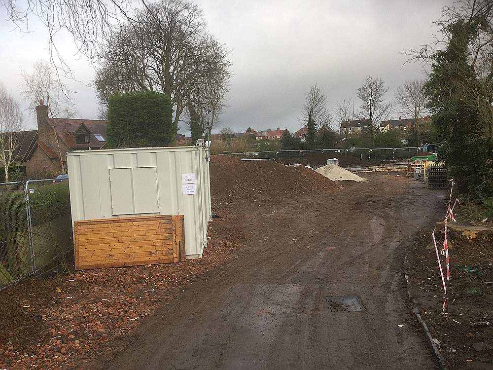

Ferdinand Posted December 3, 2017 Posted December 3, 2017 New cul-de-sac development near me with highish spec finish, including .. wood burning stoves. http://www.broadleafclose.co.uk/

Oz07 Posted December 3, 2017 Posted December 3, 2017 16 minutes ago, Ferdinand said: New cul-de-sac development near me with highish spec finish, including .. wood burning stoves. http://www.broadleafclose.co.uk/ Haha outside tap ✅ someone had to come up with a certain number of ticks! higest spec?! Haven't they heard of solid work surfaces or is a £50 outside tap more of a deal breaker

Ferdinand Posted December 3, 2017 Posted December 3, 2017 Just now, Oz07 said: Haha outside tap ✅ someone had to come up with a certain number of ticks! higest spec?! Haven't they heard of solid work surfaces or is a £50 outside tap more of a deal breaker Highish for a developer house ie better than average eg ufh, an ensuite, and all double bedrooms in the 4 bed. I need to get the gumf as it is quite close. The detailed planing ref, including specs etc, is here: https://www2.ashfield.gov.uk/cfusion/Planning/plan_view_docs.cfm?reference=V/2017/0534 There is an earlier Outline. The site backs onto allotments and has a few mature trees, so it will be pleasant. Given that *this* is the site as of 9am this morning, there is scope for negotiating changes: F
