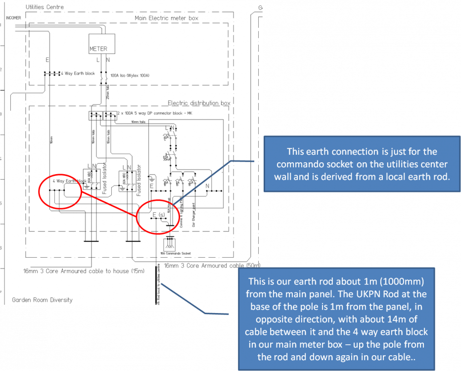

The electric company (UKPN) are due to come and move our meter and install a new supply on Friday. I am installing a local earth rod - not quite sure why though, see image below. As things stand we have an overhead supply from a pole on our land. It is a TT supply to the old house, we have an earth rod providing the earth local to the old meter position. The other houses on the pole seem to have an earth provided by rather poorly connected earth rod at the base of the pole. When they come on Friday I think I am expecting them to provide a PME (TN-C-S) supply, just like our neighbours, which uses the earth rod at the base of our pole. Are they allowed to give new properties (this is a knock down and start again project) TT supplies? Given the regs I have decided to provide a commando socket to power up stuff outside (it is not designated as a site supply), although might be used on the site if it power cannot be derived from the garden room external sockets (which itself will be supplied by the distribution panel). The earth rods, ours and the UKPN one will be within 2m of one another.
My question / puzzlement / what am I missing is / are:
  1. Given the proximity and cable run between the the two earth rods why should the two earths NOT be connected together in the distribution panel.
I did doodle a resistor network to try and get my head around this and am not sure I can see an issue - but it maybe just circumstances.

DNOs won't provide a TN-C-S (PME) supply as a temporary site supply, they will only allow a TT supply.  I've no idea why, in our case it was barking mad, as before we flicked the isolator switch to connect power to the house and test everything, we moved the PE connection to the combined PE and neutral on the head, and pulled out the earth rod.  The 16A Commando socket that we used as the temporary site supply is still there as an outside power point, but the earth for it is now via the TN-C-S connection, rather then the TT arrangement that was in place until the house was wired.
In your case, there will be several intermediate earth to neutral connections along the supply line to your house.  By chance it sounds as if you have one at your nearest pole.  The network uses several intermediate earths to ensure that the neutral is close to earth potential and that the impedance to earth is kept low (usually lower than some TT earth systems, because often the intermediate earth may be buried earth mats, rather than slim rods).
Link to comment
Share on other sites
There is nothing wrong with you connecting your own earth rod to the main earth terminal to supliment a PME earth. After all, the ethos of a protective MULTIPLE earth system is there will be an earth rod, or pigtail at every connection point.  Indeed the draft of the 18th edition of the wiring regs looks like it will become a requirement to add a local earth rod to a PME install.
In my own case I have the supply head and meter remote from the house, and a local earth rod by the house to supliment it.
A static (indeed any) caravan should not be connected to a PME earth.

If you have an existing TT supply and don't want to pay out for UKPN to upgrade the supply cabling coming in then they're OK with you sticking with TT. They can't force you to.
https://www.ukpowernetworks.co.uk/internet/en/our-services/earthing/
I've apparently been "upgraded" to PME. This happened without my knowledge, undertaken by UKPN. We were on holiday and had a friend periodically popping round to check things. One day he heard a "cracking" like an air pistol. A tree branch had come down and part cut through the overhead. UKPN came in and replaced PART OF the cable from pole, where there was PME, to the house (always TT) leaving an unsightly, taped up "joint", if you can call it that under the soffit. Originally the cable was one length. As a leaving gesture they whacked a PME sticker on.
The one constant is my two 5/8" earth rods and they're staying!

The daft thing is that it really makes very little difference which arrangement is used, as long as the PE has a low enough impedance to accept potential fault currents without raising the potential at the connected equipment earth to an unacceptably high level.
Some of the arguments for moving away from TT were that local earth rods and their connections were more liable to damage (have a look at some older installations where there will often be no protective box over the cable clamp and decades of old paint over the thing), plus some soil types can give a poor, or very variable, impedance.  Without measuring the local soil resistivity (which can be a bit of a palaver, I did it as an experiment before deciding to TT my workshop) there's no way of knowing how consistently good, or bad, a TT earth really is.
My personal view is that a good TT system, with a properly protected cable clamp at the top of the rod, and a properly protected earth cable run to the board, may well give a better level of protection than a PE that has been imported along a long length of cable.  Add in that intermediate earths on poles may well get damaged (or nicked) and having a decent earth connection locally makes a fair bit of sense.
Quite why the DNOs insist that a temporary supply, even one connected directly to an adjacent permanent incomer that has a combined neutral and PE, should not use that PE but have a local rod and be connected TT I don't know, but I do know that they were adamant about it - there is still a felt pen written warning inside our meter box about it, together with their measured Ze on the combined neutral and PE they fitted..................

PME earth has the neutral and earth connected together... and earthed to rods at multiple points on the distribution network. Generally ok until there is a neutral cable fault and local load and fault currents pull local customer earths more than 50v from true earth. If you are in an equipotential zone (services and steelwork all bonded) then the danger is reduced. But outdoors, 'pme earthed' metalwork may present a shock hazard. Caravans are TT to protect people outside them. Site supplies are also TT to protect workers holding earthed tools whilst standing on mud.
Hope that helps.
Hope that helps.
Fully understood, but when the impedance of a TT earth is allowed to be a higher than the impedance of a TN-C-S earth it does tend to throw that official argument for using TT for a site supply into question, doesn't it?
Not at all. The TN-C-S figure is misleading and is a function of the neutral connection. Lose the N further up the line and the results can be lethal... and no protective trip will operate. With a local TT earth, no influences external to the site can cause it to rise to dangerous potential. Local site faults should be quickly isolated by the RCD.

As before, I full accept this, but fail to see how a remote PE/neutral fault is worse for a site connection than for a domestic installation.  All site equipment will be running on  transformers, anyway, lowering the local risk.  If there is a network fault that pulls the neutral up at the incomer then that will affect domestic installations every bit as badly.
My 16 A Commando is now connected to the combined PE and neutral, yet I am still using that as a supply in the garden, and it ran my car charger for a while before I installed the proper charge point.  Is it more dangerous now than it was when it was feeding site transformers?
Inside a house, with all metalwork and services bonded, there is an equipotential zone. The cpc of your kettle and the bonded water tap have a guaranteed low impedance connection between them, holding fault potential less than 50v.
Outdoors no bonding applies. So the metal case of your welder could, under network fault conditions, be at lethal potential wrt the gatepost you're about to work on.
Ok its all belt and braces. Sites should use 110v balanced supplies, but the dno are providing a 230v supply and must make that as safe as possible.
Also note your 'safe' 110v transformer isolates you from incoming L &  N, but centre references the 110v  to the incoming earth. If the PME earth wanders off to dangerous levels, so does your 'safe' 110V.
HTH

Simple illustration.
Fitted immediately under our meter box is our old site supply, a 16 A Commando.
When it was used as a site supply the DNO insisted that it have a TT earth.  Now that the house power is on it has a TN-C-S earthing arrangement.  There was far more outside work done after the TN-C-S earth was connected and the  house switch was thrown for the first time than there ever was before the house went up.  At a guess, 90%+ of the use of mains connected outside electrical appliances were used on site after it was switched over to TN-C-S.
The 16 A Commando is still there, and I still use it.  Is it now far less safe to use than it was when it was connected with a local TT earth?
I can add a clue.  Like all these small site supply boxes it has a 16A 30 mA, DP RCBO.  An RCBO doesn't have anything to do with the earth arrangement, but trips within 30ms when it senses an imbalance of greater than 30 mA between the current in the line and neutral.  I contend that, no matter what the earth arrangement, the practical safety of that 16 A site supply was pretty much the same, and that the fact that the vast majority of the time it has been used has been after it was connected  as TN-C-S supports the view that insisting on TT for the short time before the house was wired and the house isolator switch thrown for the first time did not, and does not, make practical sense.

The PME earth and caravan thing is to do with failure of the cable.
With a PME, it comes into the house, usually in a concentric cable with the outer being a combined neutral and earth.  It is not unknown for that CNE conductor to fail.  If it does and a caravan is connected, then the metal caravan skin (which should be bonded to earth) can raise to L potential.  This can be VERY bad news for someone entering or leaving the 'van with one foot on the ground and reaching up to grab the door handle.  A TT earth avoids that issue, and while Neutral might rise to L potential, the caravan skin will remain at local earth potential.  Same issue for site tools (if not 110V via a transformer)
This I believe is also the reason for the change to the regs to fit an additional rod, as usual we the electricians are having to take on the responsibilty of sorting someone elses shortcomings.
