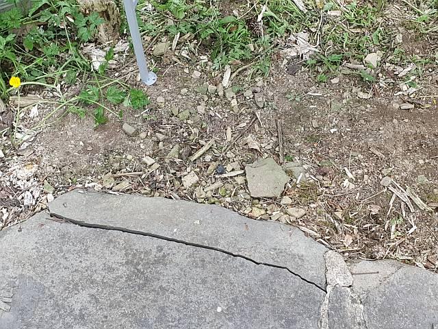

Also, the position where the pergola is to sit is a small flat area of about 2m x 1.5m, behind which the earth rises up a hillside, and in front of which the hillside falls, meaning that it is possible that over time there may be downward, gravity-led, earth movement.  This movement may explain the crack which appeared recently in the thick stone directly in front of the position where the wooden pergola sat.

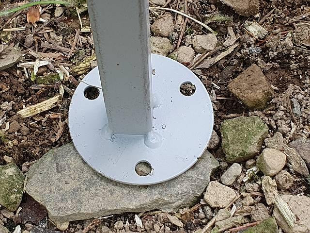

At the end of each leg is a small round horizontal plate, with 3 holes for insertion of the 4" nails which have been supplied.
I thought of embedding the feet but it would be best not to lose any of the height of the 4 legs, otherwise the seat will become lower, in relation to the ground.

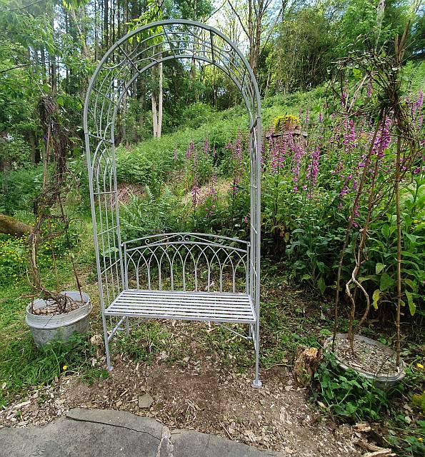

Below: the pergola with the two planters of clematis which will sit close to each of its two sides.

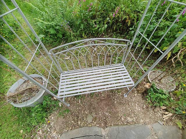

Below: a top-down view.
Below: a crack in the thick stone in front of the seat, possibly suggesting earth movement.
Below: one of the four feet of the structure.

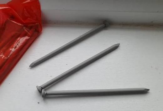

Below: 4-inch nails have been supplied to fasten the four feet.
I would be tempted to dig 4 holes (space width square and deep) get some threaded bar, chemical anchor, and postcrete. Fill holes with postcrete and level. Drill holes for flanges. Chemical anchor threaded bar in place. Tighten nuts - it's going nowhere in a hurry.

Tent pegs is plenty.but so should be the nails, on angles.
Plants will catch the wind bug also anchor it.
I'd pave under the area to meet the stone and just fix the pergola to the paving slabs with short concrete screws.

With chemical anchors and concrete bases, the weakness / fail point becomes the tubing of the pergola.
That's why I would use the nails or tent pegs, and let it move a little.
Don't worry about that. The earth moves a lot all the time.  Edges break off things. Enjoy the pergola.
