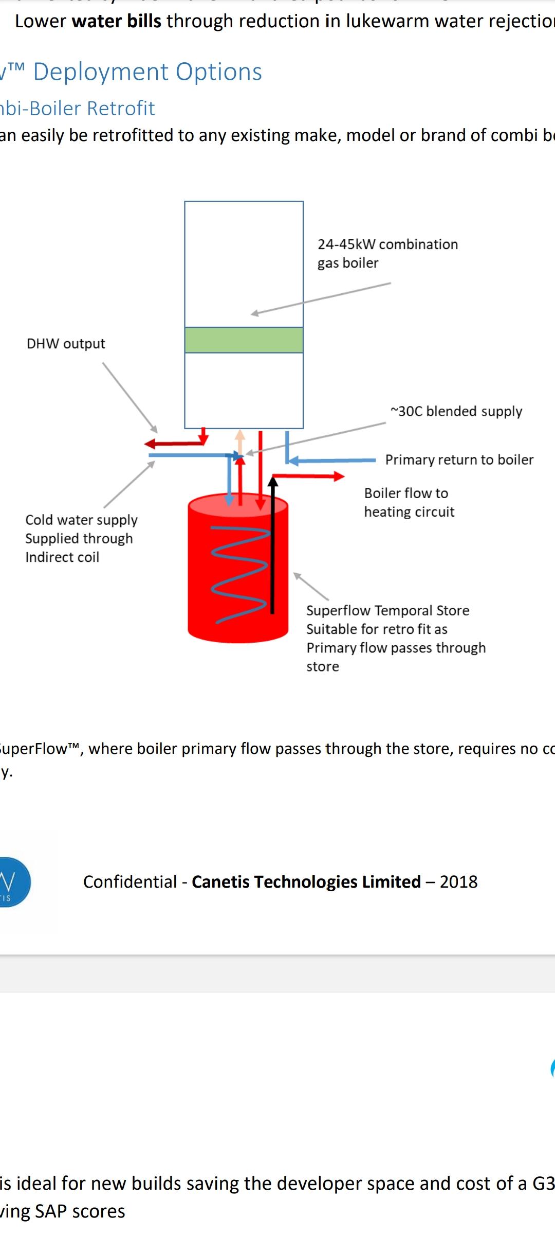

JohnMo Posted June 15, 2024 Posted June 15, 2024 On 15/06/2024 at 16:16, Nick Laslett said: In the comments Adam is asked if it is vented or unvented and where the expansion vessel goes. He replied, Expand A similar concept been about for years (since 2018 ish) - funny it for a gas combi boiler. Just swop the combi boiler for a heat pump with a bigger coil and delete the blending valve and go direct to taps (not to the combi). Same 4 connection. Neither a vented or invented DHW cylinder, just allows for additional volume with an additional or increased heating expansion vessel 1

JohnMo Posted June 16, 2024 Posted June 16, 2024 Just watched the follow up video. Looks good, seems to work well. It is as shown in my post above. The heat pump heats the store directly and DHW is taken via a coil. The blending valve would be installed if you store water above 60 degs.
HughF Posted June 16, 2024 Posted June 16, 2024 Yep, just watched the video. Standard thermal store with a coil for dhw. Could do the same with a small direct cylinder, a phe, flow switch and shunt pump.
