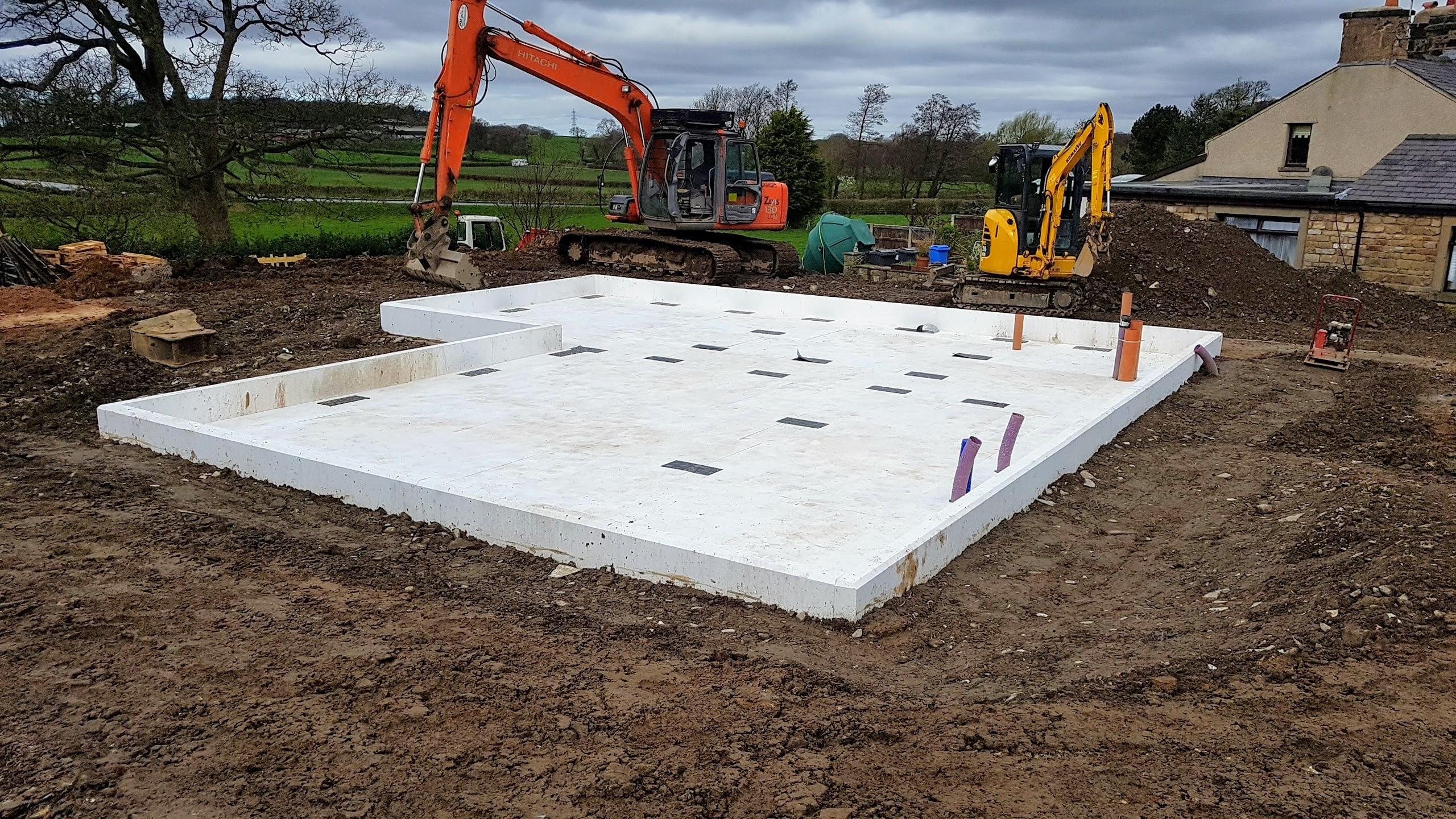

AppleDown Posted June 7, 2024 Posted June 7, 2024 My GreenRaft quote was est. of £30-35k for 181m2 at 0.12W/m2K. AFT are £8,900 for just the kit, with minimum 0.1W/m2K.

JohnMo Posted June 7, 2024 Posted June 7, 2024 8 minutes ago, AppleDown said: My GreenRaft quote was est. of £30-35k for 181m2 at 0.12W/m2 Same ballpark our problem site - 195m2, 0.09 U value, strip foundation with reinforced concrete slab. £32k Strip foundations reinforced at the front 2m wide (due to being at edge of a hill), insulated stub walls, 200mm with 2x rebar reinforced concrete, 200mm PIR insulation (U value 0.09) 70mm upstands and 100mm fibre reinforced finished slab. Included materials, time and concrete pump lorry twice. 1

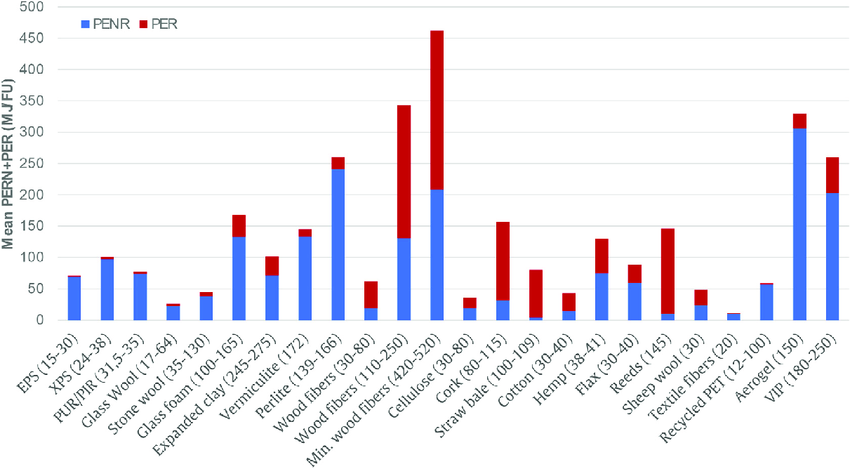

Iceverge Posted June 7, 2024 Posted June 7, 2024 3 hours ago, SarahHutch said: However the sites orientation and a few design quirks mean that trying to get it passivehaus certified may prove complicated and costly Almost any design can be made into a passivhaus, it just depends how much you want to spend. Have you ran your design through PHPP? 3 hours ago, SarahHutch said: natural materials Caution this approach. Some natural materials have worse embodied energy than synthetic ones. 3 hours ago, SarahHutch said: regards to the insulated raft foundation, this was suggested by our structural engineer as the best solution to achieve a high level of insulation with very minimal thermal bridging. Again it's a thing of many variables. Much depends on your wall construction, ground conditions etc. in our case strip foundations were cheaper. Properly designed they can be excellent thermally too. Maybe have a shot of THERM. it's a bit of a pig to get used to but can give an excellent insight into thermal bridging.

G and J Posted June 7, 2024 Posted June 7, 2024 This may be a daft question, but is a PH slab simply a foundation with lots of insulation and no thermal bridging? If so what u value is it required to hit?
IanR Posted June 7, 2024 Posted June 7, 2024 (edited) 21 minutes ago, G and J said: This may be a daft question, but is a PH slab simply a foundation with lots of insulation and no thermal bridging? If so what u value is it required to hit? Insulated rafts, that are often used for PH type builds, are typically sitting on 300mm of EPS insulation, plus a perimeter insulation that may be around 150mm thick, isolating the floor and foundation from any contact with the ground. Detailing of the floor-to-wall joint is still required to achieve a cold bridge free design. U value would typically be around 0.1 The video at the attached link gives a good explanation of AFT's Eco Raft. Not their highest performing foundation, but further gains start to become marginal. https://www.advancedfoundationtechnologylimited.co.uk/our-products/timber-steel-icf-framed-building-foundation/ Edited June 7, 2024 by IanR
