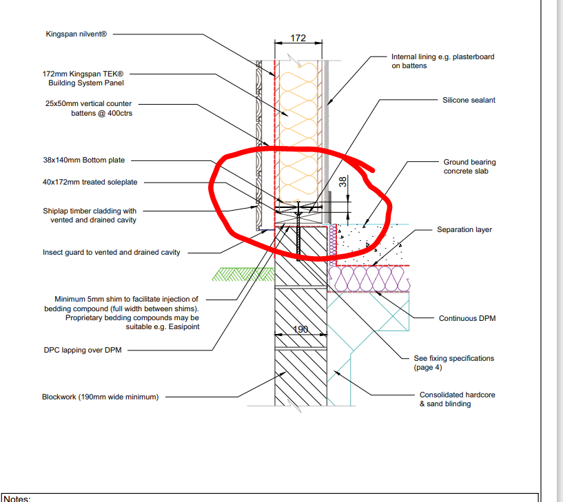

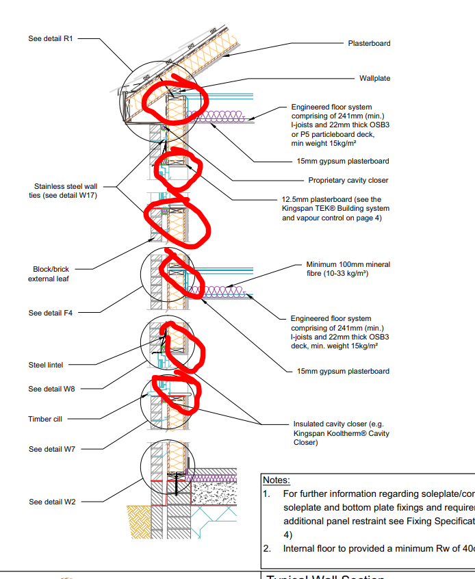

SteamyTea Posted June 8, 2024 Posted June 8, 2024 5 minutes ago, G and J said: At present I’m struggling to work out a stick built wall build up that yields a decent u value and the right thickness Can you post up some dimensioned sketches of what you want to achieve. Each thermal element does NOT have to meet building regs, so some areas can overcompensate for weaker areas. It all comes down to surface areas and U-values at the end of the day.
MikeSharp01 Posted June 8, 2024 Posted June 8, 2024 3 minutes ago, G and J said: yields a decent u value and the right thickness. That's a tough ask as the one controls the other. You know what our build up is and the resulting U value (a combination of PU and blown cellulose) and that comes out at 470 mm (ish). Maybe worth looking at making the internal dimensions slightly smaller and playing with internal features; vaulted ceilings, through views, clever decorations etc to make it feel bigger.
saveasteading Posted June 8, 2024 Posted June 8, 2024 1 hour ago, G and J said: the boom would have to arch over electric cables Booms are only one type of machine. the simpler version and much cheaper type has the concrete pump as a trailer, and the pipes go along the ground. 1 hour ago, G and J said: struggling to work out a stick built wall build up that yields a decent u value and the right thickness. I can't see how that is a problem, except for the reduced insulation at studs, but that is only 5% of the area and so compensation / trade off should be findable elsewhere. I suggest that you are set on sips panels and see anything else as inferior. If you have decided on a maximum wall thickness, and stick build is falling short on your target insulation, by say 5%, then it is easy to compensate for that in the roof or floor.
Iceverge Posted June 8, 2024 Posted June 8, 2024 @G and J I've been loosely following this. The essentials are you want a low U-Value Wall, with minimal thickness on a site that constrains the use of high overhead machinery. If you really want to dig into the weeds on this I'd advise that you try thermally modelling the entire wall, not just a simple U value calculator, in order to account for thermal bridges. Once you get towards any acceptable U values thermal bridging becomes really significant. Particularly around windows/doors, the floor wall joint and the first floor ceiling band area. You'd be surprised how the promised performance of a SIP wall worsens, once taking these all into consideration, as SIPS often require solid timber blocking in these areas. 1

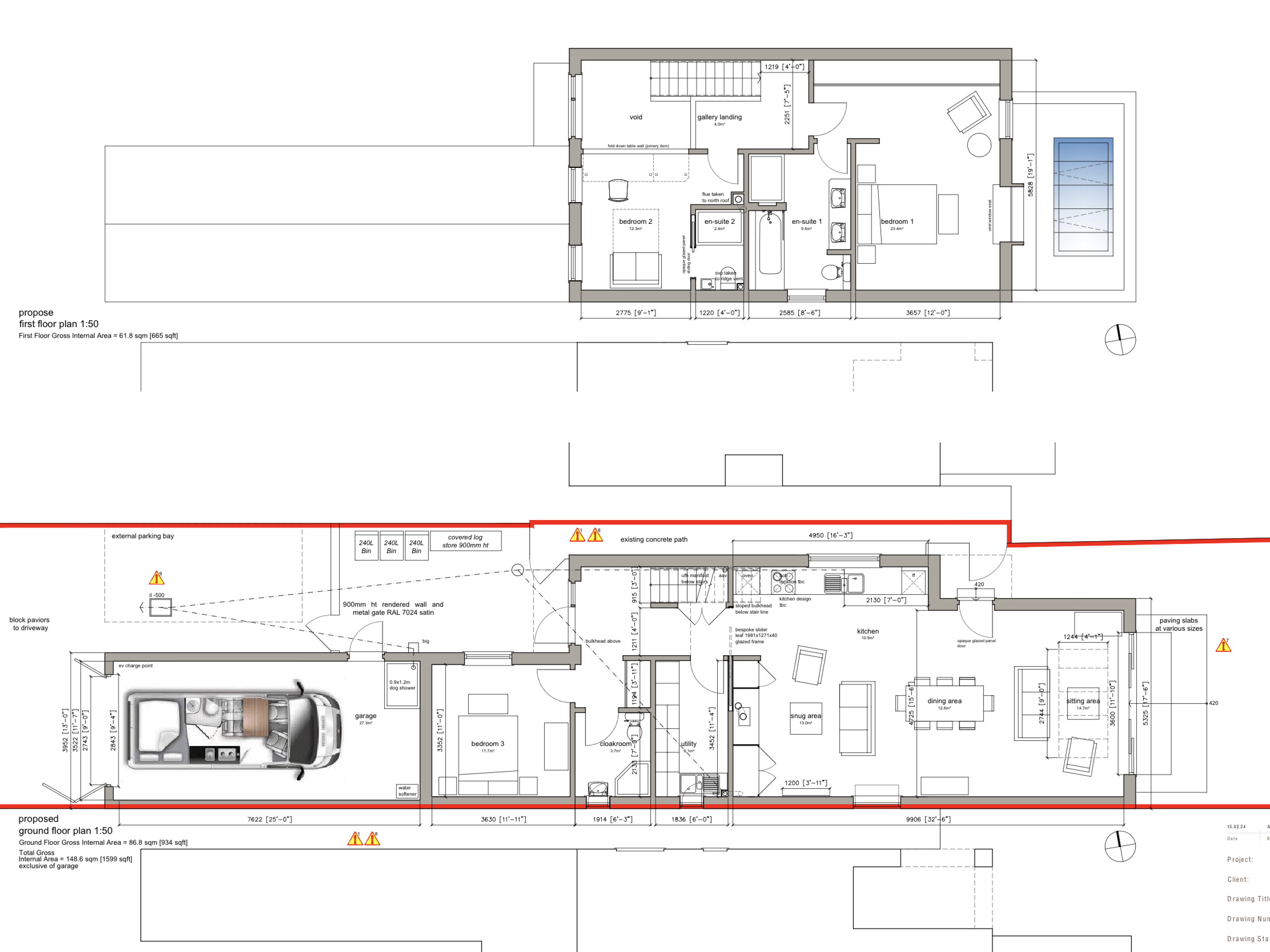

G and J Posted June 8, 2024 Author Posted June 8, 2024 1 hour ago, SteamyTea said: Can you post up some dimensioned sketches of what you want to achieve. Each thermal element does NOT have to meet building regs, so some areas can overcompensate for weaker areas. It all comes down to surface areas and U-values at the end of the day. I’ve noted that many peeps seem reticent about posting their plans so I haven’t posted so far, but I don’t see why not. Whilst I appreciate that we can trade off u values between different elements I'm taking the approach that by working each element we get the best info we can to fuel those trade off decisions, and as a spin off I’m learning tons of stuff too.
