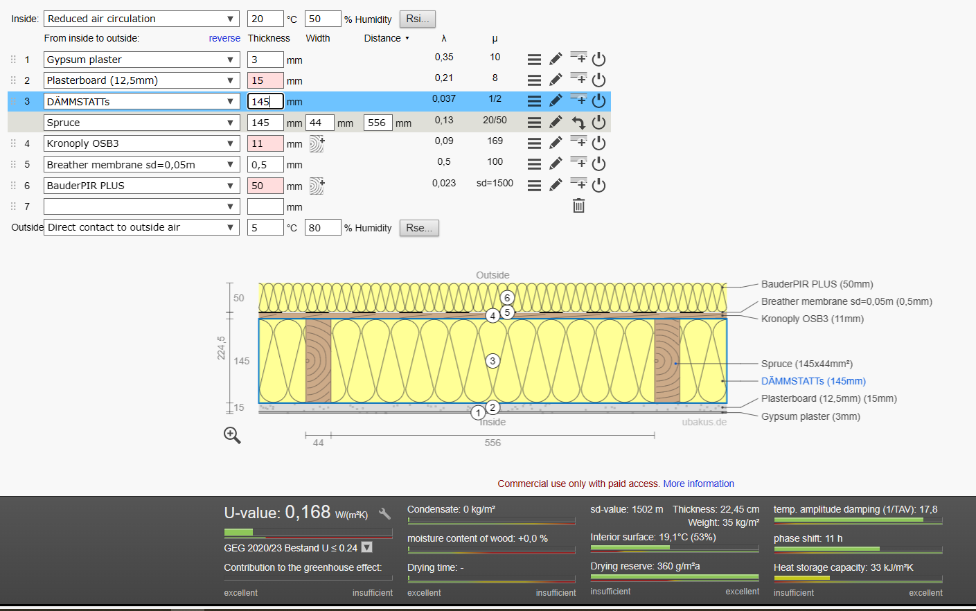

So a build up like:
1. Skim
2. PB
3. OSB/ply
4. 140mm frame filled with rockwool
5. OSB3
6. water barrier membrane
7. PIR
8. Batten
9. Counter batten
10. Larch cladding
Would potentially create a condensation pocket between layers 3 and 7.  Fast forward to a rotten frame.  Damn.
Edited by G and J
Forget the OSB3 sheathing layer. D’Oh!
In the UK where we generally have a greater relative humidity inside than outside, and generally have lower temperatures outside than I side, moisture needs to travel outwards.
This is generally achieved by modelling it via the partial vapour pressures.
All that means is that as long as the associated temperature and RH barrier allies water vapour to move outward, then there is generally not a problem.
Any condensation within the structure is expected to evaporate and travel outward in a short space of time.
The VCL is placed inside because that is where the warmest and highest RH air is, ventilation (MVHR) is used to replace this air with lower RH air.
So when looking at the different layers, you need to know the vapour transmission rate and make sure they can allow more vapour though then as they get colder (outside).
The theory is based on the ideal gas formula PV/T where P is vapour pressure rather than absolute pressure. V is obviously a fixed volume and T is absolute temperature.
(A lot of thermodynamics is based on modifying the idea gas formula)

The principle that an impermeable barrier is placed on the warm side so it doesn’t get condensation on it makes sense.
The principle that there is only one impermeable barrier also makes sense, even if that barrier is double layered (e.g. plastic sheet and PIR).
Which says to me the only safe option is to not have PIR outside my sheething layer.
Are there practical alternatives?
You can get PIR boards without the foil vapour barrier.
https://www.secondsandco.co.uk/product-page/pir-boards
They would probably be OK as by the time the VCL/MVHR has done there business, and the fact the PIR is on the low temperature/Lower RH side, there would be virtually no mass of water vapour to condense/freeze.
This does raise the question if what sort of roof you want to fit, Warm (would be my choice), Cold (just why) or the Hybrid (horrible).
The reason this makes a difference is because it can change where the effective moisture release areas are.
My feeling is if you control ventilation and heating, which is really just another way of saying keep the internal RH as low as comfortable, once the building has dried out fully, you will not have a problem.
4 hours ago, G and J said:
So a build up like:
1. Skim
2. PB
3. OSB/ply
5. OSB3
7. PIR
8. Batten
9. Counter batten
10. Larch cladding
Not necessarily, I would omit the inner OSB layer in any case as it's not needed and will just add to the thickness which you want to avoid.
You may want some Plywood or noggins/blocking if you plan on hanging furniture from the wall etc.im certainly areas. This localised ply inner layer won't be airtight as there'll be many penetrations for wires etc so I wouldn't consider it much of a barrier of any kind.

I would argue that absolute humidity tends to equalise rather than travel in any particular direction. Indoor absolute humidity tends to be higher and therefore the trend to migrate outwards.
By keeping a layer of continuous insulation outboard of any organic materials like timber then it will remain above the dew point for almost all of the year and condensation cannot happen.
As there's only space for 50mm of PIR in this case, below about 5 Deg there is a risk of moisture accumulating on sheathing/PIR interface. This assumes that room air comes into direct and regular contact with the sheathing AKA terrible airtighess.
In reality in our neck of the woods we are very rarely exposed to prolonged cold temperatures and if you plan on doing a good airtighess job then the risk is truly minimal as ,like I've said before, almost all moisture gets into a structure via air paths and cracks and not through diffusion through materials.

My investigations so far indicate that a SIPs on site blank panel build would use 175mm PU SIPs or 200mm EPS SIPs to yield a u value of better than 0.17.
My thinking is that a layer of ply or osb would give a better feeling of solidity, better acoustic performance, can be done by me so it’s only the cost of materials and it has the spin off benefit that one can hang stuff wherever (as I’m used to doing in my blockwork house).  I’ve been told by a couple of peeps now that they are glad they did that, but I grant you, it’s not technically necessary.  It’s so hard as we all have a natural tendency to view our own past decisions with rose tinted glasses.
300mm is ideal but we won’t be silly about it. If there’s a really good reason to sacrifice some room space for better walls we will -better in this case meaning greater reliability and longevity, insulation is, as has been mentioned, capable of being ‘traded off’.
So if losing 50mm made a big difference we’d do it.  But I’d look for alternatives first.
