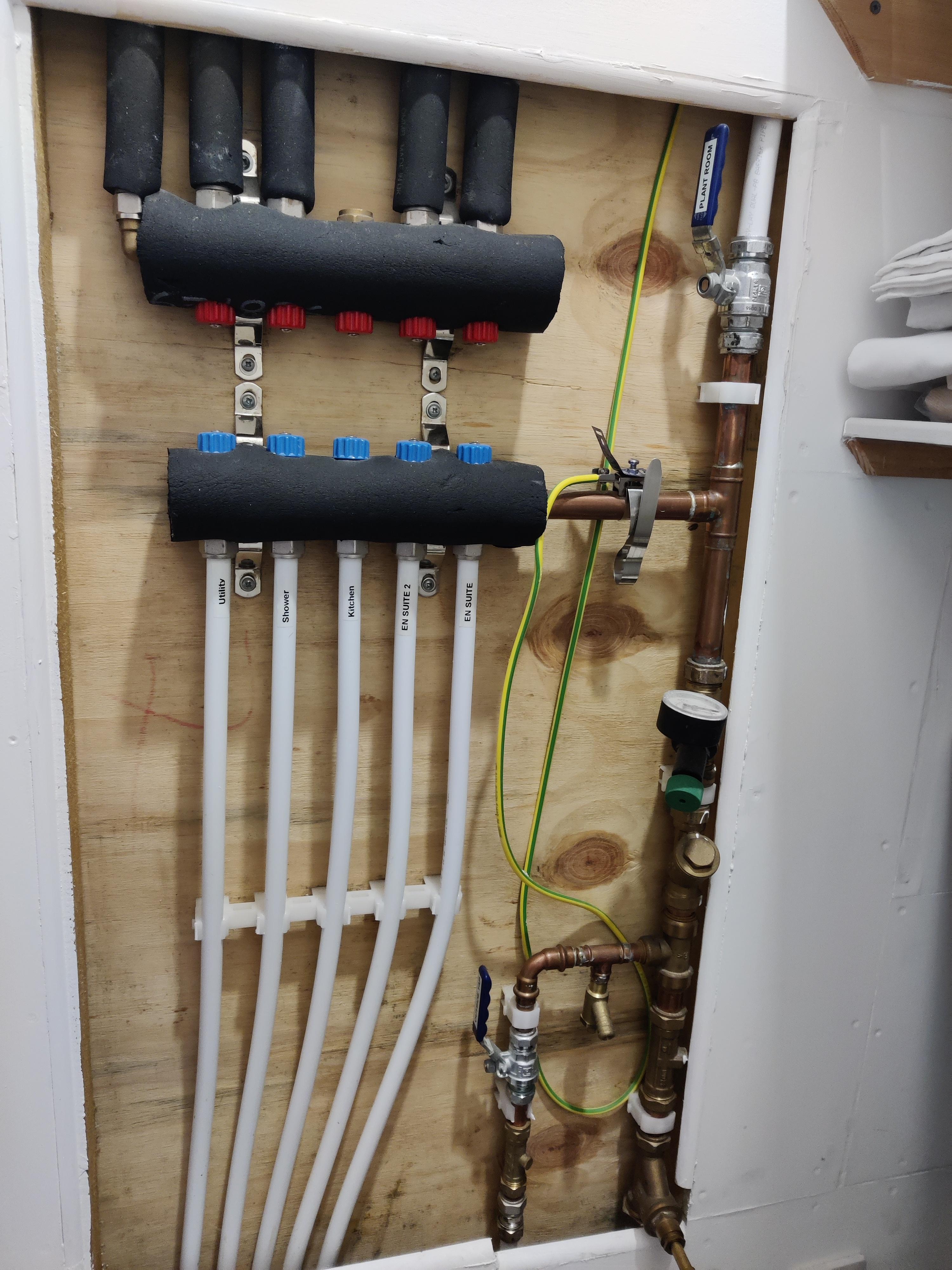

JohnMo Posted June 1, 2024 Posted June 1, 2024 16 hours ago, vala said: One thing I was looking into using was a water distribution manifold after the DHW outlet and also one before the cylinder as I'll have a water softener fitted. The cold softened water would go to the cylinder and upstairs to the bathroom. Is there any issues with using these as a means to provided distribution and isolation? in particular with unvented cylinders? Really to should take the cold water from the balanced feed on the inlet group for the UVC. But I did a retrofit so have a pressure control valve on the inlet to the house so in effect everything is balanced close enough as not to have issues). No issues with a manifold. I have a manifold for hot and cold. One supply to each wet room and then branch from there. You would need two colds (one hard and the other soft water). Mine looks similar to the one shown but with a different makers name on it. Are you new build or retrofitting?
JohnMo Posted June 1, 2024 Posted June 1, 2024 53 minutes ago, vala said: confirmed with the installer for a 5kW Arotherm Plus. Or just about any other 6kW ASHP would do the job. Don't be fooled in to buying very expensive ASHP most big manufacturers are just as good. As long as it's sized correctly and most importantly installed on a good system design all is good
vala Posted June 1, 2024 Author Posted June 1, 2024 With regards to the connection onto the CU I've got blank spaces so no issues with having a dedicated circuit. In fact the current oil combi is on its own circuit so I assume sparkie will just replace that. @JohnMo My initial plan is from the cold feed into the house to tee off to the a manifold (for the fridge/hot water tap and heating circuit via the filling loop) and to the water softener. Then out of the softener it goes to another manifold which will go to the cylinder and to the bathroom. Already got these manifolds in the bathroom as a means to have isolation as all the pipework is behind tiles. Done it all in plastic to not have any joins. Sound ok?
JohnMo Posted June 1, 2024 Posted June 1, 2024 Sound pretty similar to what I have (but no softener). Stop tap on bottom right, then outside tap, filter, prv, tee to cold manifold and the white pipe to cylinder. Top left comes from cylinder.
vala Posted June 1, 2024 Author Posted June 1, 2024 @JohnMo perfect. thank you for confirming. One thing I have noticed, but haven't paid much attention to till now, is that once the water mains comes into the house there's an adapter and its reduced to 15mm for the stopcock and so forth. I'm guessing that as I currently have a combi this isn't so much an issue, but going forward with an ASHP will this be. Would it be wise to run from where it comes into the house in 22mm? Connection on most of the cylinders I've looked at appears to be 22mm for the cold water inlet and also the DHW. I can always reduce down to 15mm, but I'm assuming sizing up isn't really a done thing?
JohnMo Posted June 1, 2024 Posted June 1, 2024 3 minutes ago, vala said: Would it be wise to run from where it comes into the house in 22mm? I would convert to 22mm at the stop cock. Place hot water manifold close to cylinder and then run from there in 15mm Hep2O or similar to the wet rooms. If you are not using the balanced cold water flow from the unvented cylinder inlet group, put a prv after the outside tap (if you have one or after the stop tap if you don't) that will ensure everything downstream is pretty much the same pressure for mixers etc. You will also need a check valve at the unvented cylinder hot water outlet to prevent any chances of reversing flow.
vala Posted June 1, 2024 Author Posted June 1, 2024 34 minutes ago, JohnMo said: I would convert to 22mm at the stop cock. Place hot water manifold close to cylinder and then run from there in 15mm Hep2O or similar to the wet rooms. If you are not using the balanced cold water flow from the unvented cylinder inlet group, put a prv after the outside tap (if you have one or after the stop tap if you don't) that will ensure everything downstream is pretty much the same pressure for mixers etc. You will also need a check valve at the unvented cylinder hot water outlet to prevent any chances of reversing flow. Can convert easily enough to 22mm so will get that done. After the softener, and manifold, I'll go into the inlet control group then into the cylinder. I could put a PRV before or straight after the softener so that the cold going to the bathroom, as well as what's feeding the cylinder is all the same pressure?

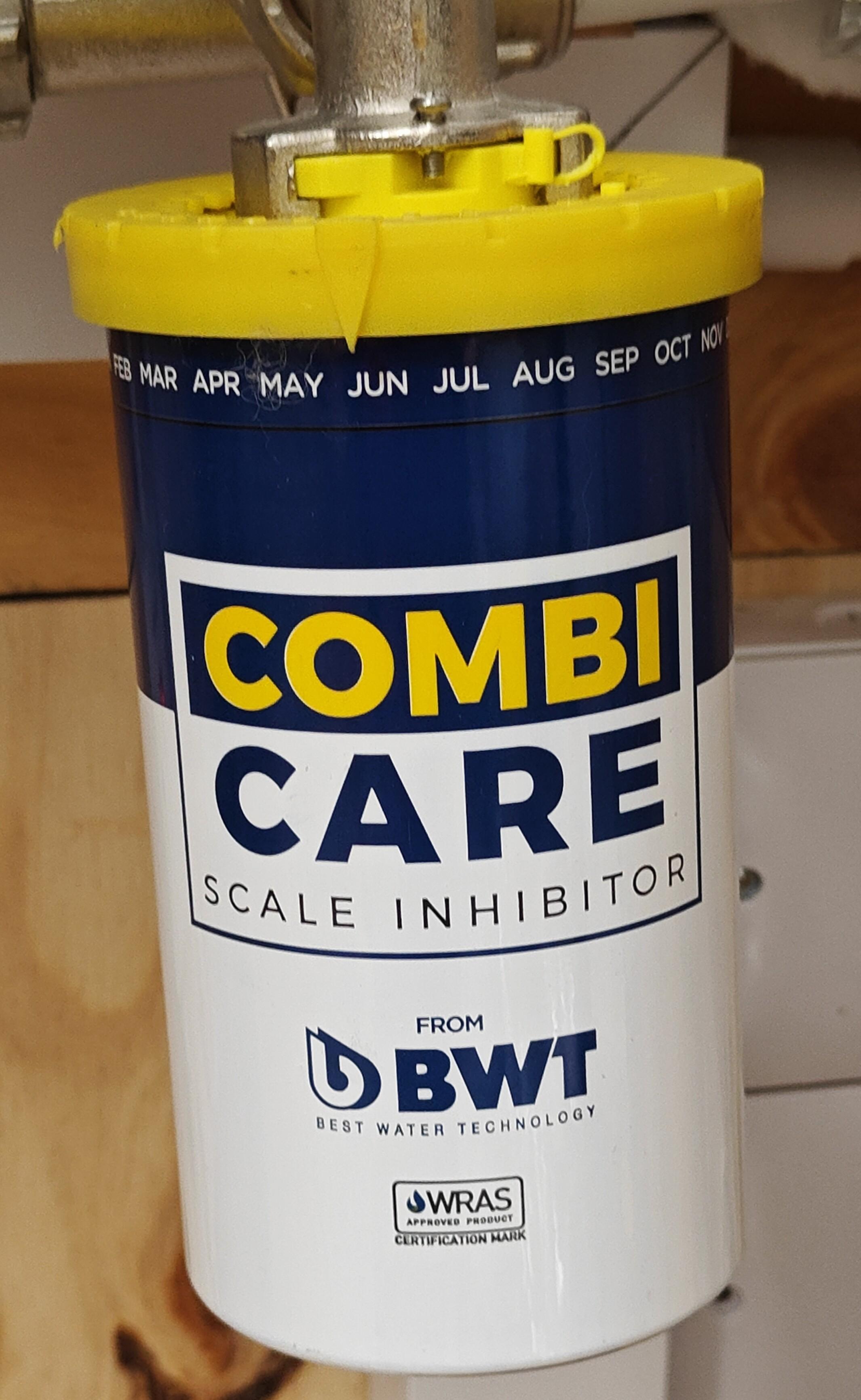

JohnMo Posted June 2, 2024 Posted June 2, 2024 33 minutes ago, G and J said: I was told recently that current designs mean softened water is safe to drink Still tastes rubbish and if salt based there can be issues with salt content. But you could always just use a Poly Phosphate based cartridge system like a BWT combi care. Just put it in the fed to the UVC (22mm). Change cartridge every 12 months. Not a softener as such just stops or reduces scale buildup by stopping the process. A simple explanation here https://silksoftwater.com/water-treatment/water-conditioner/polyphosphates-in-hard-water-treatment/
sharpener Posted June 2, 2024 Posted June 2, 2024 Personally, having experience of both very hard and very soft water supplies I would only want softened water in the shower; the loos, dishwasher and washing m/c do not really need it. AFAIK ion-exchange softeners still work by replacing the calcium (and magnesium) ions with sodium, which will increase your blood pressure if you drink a lot of it. The kind which allegedly use magnets etc to change the structure of the molecules in the water are unlikely to do this. Polyphosphates are widely used by water authorities, orginally to prevent lead being leached out of lead pipes. I was told they do this even where the hard water means it doesn't actually happen anyway. But it does cause an annoying scum to form on tea and coffee. I wonder if ion exchange softening also changes the pH of the water or is otherwise bad for heat pumps? Naturally soft water is often quite acid. Harvested rain water is AFAIR pH 5.3 bc of CO2 dissolved from the atmosphere, I have some trouble neutralising the acidity and won't be using it to fill my heating system. SWW use sodium hydroxide to raise the pH so that introduces some sodium too. Vaillant have some quite detailed specifications in their HP installation instructions (though the footnotes refer to boilers where scaling is much more of a problem), I wonder how many installers follow them? pH 8.2 is quite alkaline (the lower limit for potable water in the UK is 6.5), you would need to add >100g of sodium bicarbonate per cu m to achieve that.
